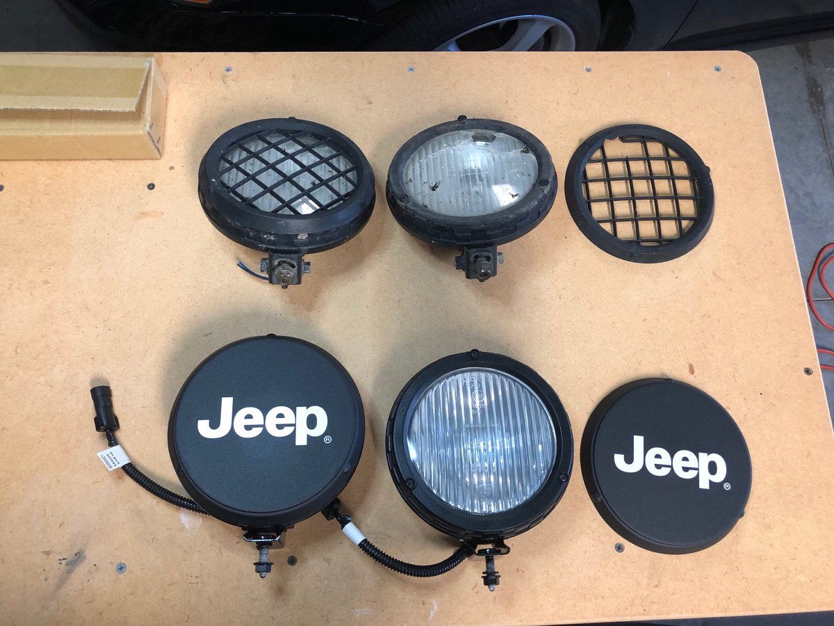

Nope. I’m not serious enough to need those. Found a pair of OEM fog lights on eBay for $90 shipped. I’d consider just replacing the lenses but the harness has been cut, so all that and shipping would make refurbishing a more expensive option.

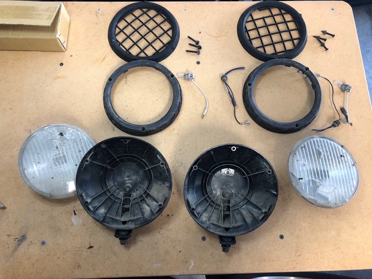

No. The waffle/grid guards attach just like the solid covers. There are three cone-like rubber stoppers (?) that go under the three screws that hold the housing together. Then the cover pressure fits onto the three rubber stopper thingys. This allows you to take the guards / covers off without needing to disassemble the entire light.
You can see them on the screws in the picture if you look closely. It’s a stock part.
