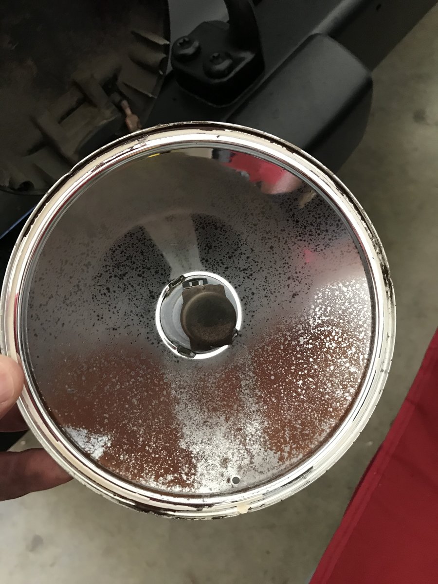

I haven't taken mine apart yet, but it appears I have corrosion on the housing surface as I look through the lens. If anyone's had the same issue, suggestions on what to clean the metal surface with...brasso?

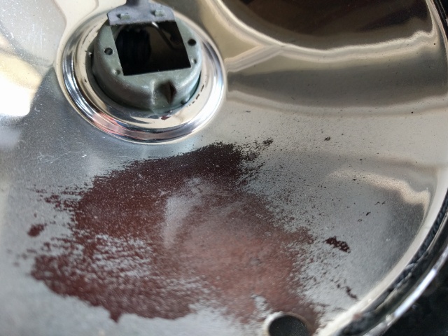

Took my apart yesterday to address the reflector corrosion...tried Brasso and some wheel polish (“safe for all metals”) I had on hand. Went from bad to worse, and is now solid brown color where I applied polish. Any ideas on what to use, or best process to prep and paint if polish not recommended? Pic is “before” I started.
It's garbage unless you know a shop that does chrome plating. That needs to be a high temp mirror finish and there aren't any cheap ways to fix it. You could try chrome spray paint but it'll probably burn off if you use halogen h3 bulbs in it.
I'm in the same boat.
Thanks...wasn't sure what type of metal it is, looks like you're pegging it as chrome. Was hoping to find a replacement reflector or an aftermarket direct fit replacement for the OEM housing, but haven't found one yet. Please let me know if you find a solution and I'll do the same.

It works on real chrome like bumpers, I've used that trick. The problem is if you rub at all on those reflectors all the plating goes away in about 2 seconds and you are left with nothing. It isn't corrosion, the chrome is missing, that's what the brown spots are.
Noted, thank you for clarifying that before anyone ruins a reflector even more. I've never done it for a reflector, but like you, I have for bumpers and it worked.
