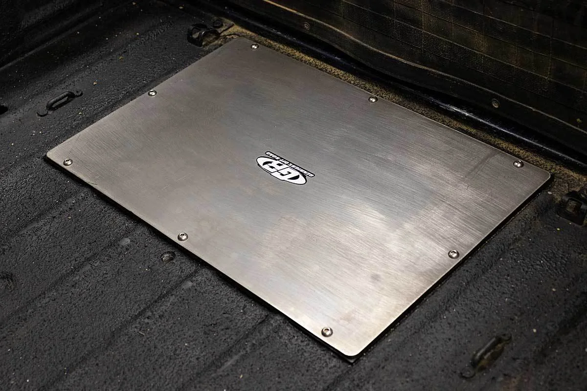

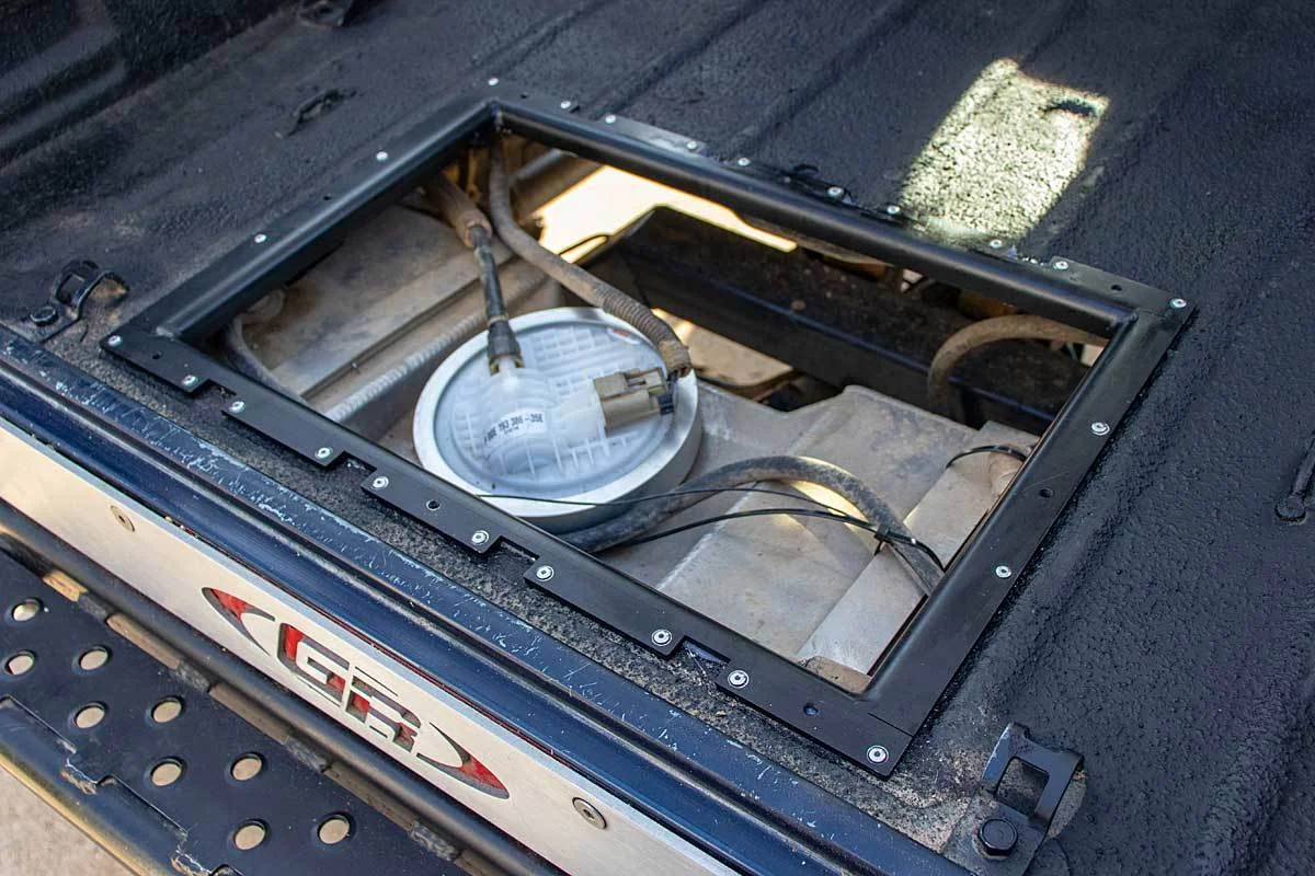

Maybe put the floor access panel in and try the Delphi. If it craps out, easy swap.
The GenRight kit costs more than a fuel pump. I guess I could buy the $40 Ebay pump then.
You don’t need GR. Just cut the hole, reinforce the cut edges with angle iron, and bolt an aluminum plate to the angle iron. Walla!
