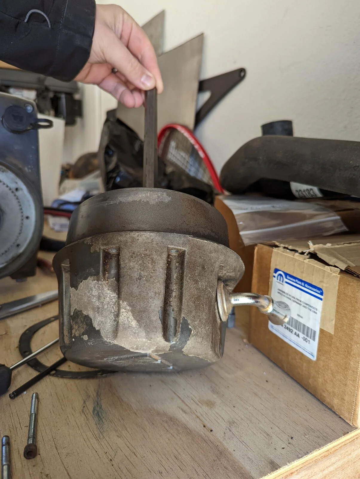

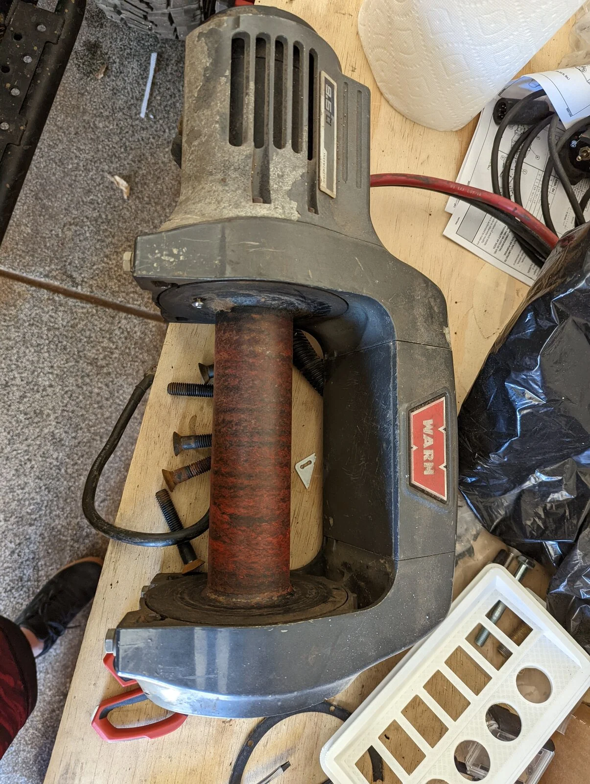

I need to refurbish an old Warn 9.5ti since the paint is all chipped and the out solenoids no longer work. What do people use to paint their winches? Attached you can see the condition I'd like to rework.

My opinion: Don't powder coat it. I don't like powder coat on anything that's going to see significant moisture, the water gets underneath the powder coating and then it falls off in sheets - which is what it looks like its doing now. And moisture WILL get underneath it, usually from sharp edges/corners. I've had vastly better luck with Rustoleum. I just flat blacked mine (after primer), but someone else here did a hammertone that looked REALLY nice!

That's good to know, I don't know enough about the options to know why this happened. It does seem like a good bit of water got in just looking at it. Maybe I can get a small test patch of two options and compare the look.
Just wire wheel all the loose stuff. Wipe down, spray self etching primer then top coat.

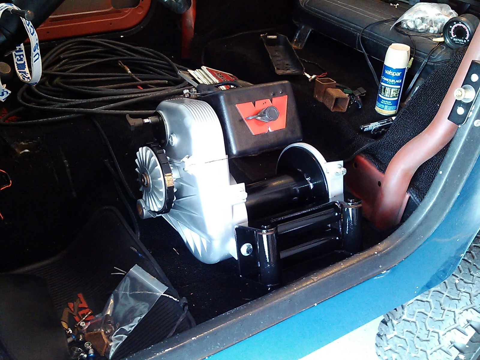

I'll take a peek to see if they shared what they used - thanks!

I would avoid powder coat with the ZA the housings are made from. It can be done it is just a PITA. If you have access to soda blasting it is easiest to avoid erosion that can happen with sand blasting. Then use a good epoxy paint. Here is the parts list https://www.warn.com/Attachment/DownloadFile?downloadId=1895 and do not pull the brake out of the drum unless you plan on replacing it.
Seems like I need to do more than just the loose stuff, otherwise it'll look a bit wonky I think, no?
I used a wire wheel then a Dremel. Then sand or scotch Brite pad as needed. Then paint desired primer and color. I paint metal at work both steel and aluminum, and it comes out fine.

After degreasing, if you want the paint level you have to do a lot of paint removal at the edges and blend it by feathering (or remove it all). You can start with 120 grit, go to 360, wet sand at 600 and 1000. After you do that use a Primer Filler, then wait for it to dry, wet sand again with 1000 if necessary, topcoat with the color you want, then I would 1K clear coat if you really want it to look good. That’s assuming that’s steel and not some other alloy that may need different prep and procedures. Take your time and follow the instructions on the cans.
