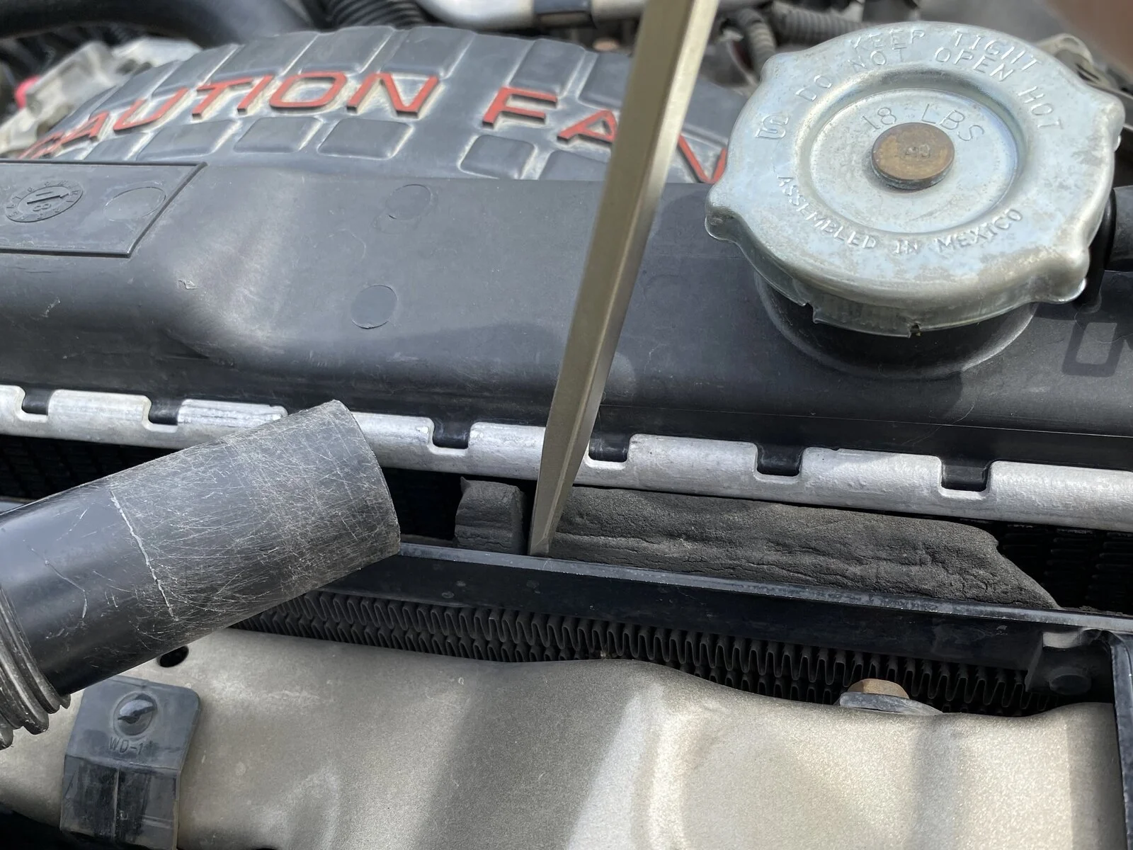

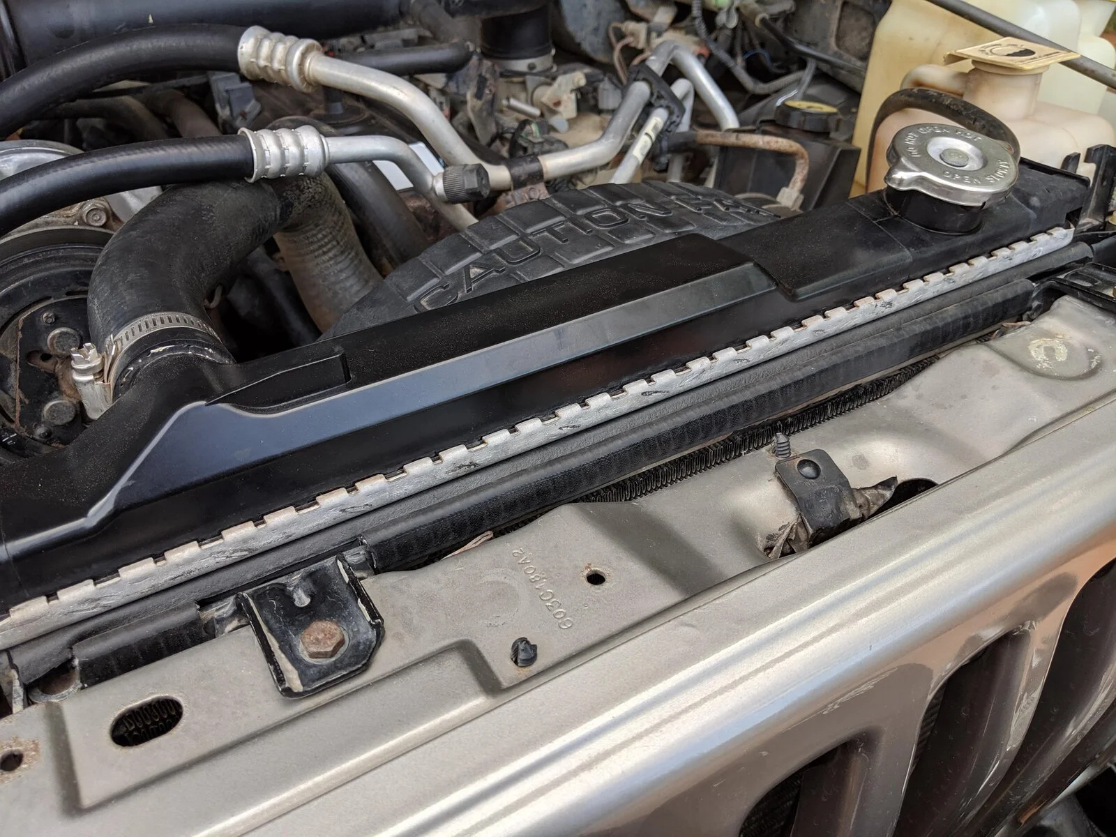

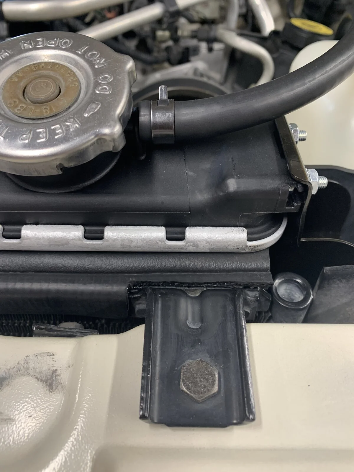

After replacing the radiator, the foam that keeps debris from getting in between the radiator and condenser has disintegrated. What have you used to replace that?

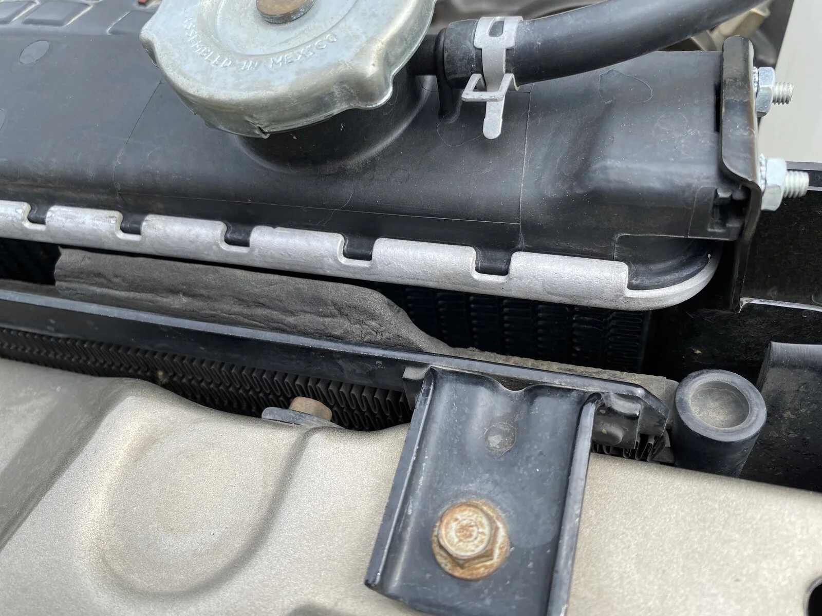

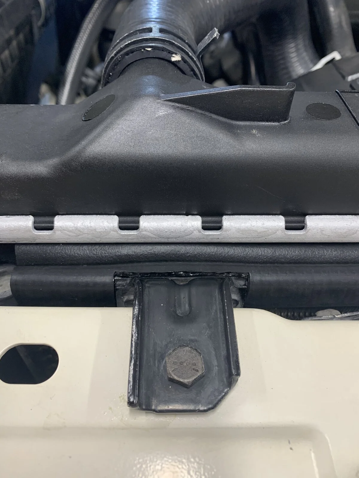

I’d like to know that too. Mine was missing in some places and really hard and brittle in others. I temporarily cut a section of foam pipe insulation and kind of wedged in there. I’d like to find something more permanent and better looking.
Thinking of trying some dense square or rectangular foam used in sealing off window unit air conditioners If I can find a size that will work.
I cut some foam pipe insulation for that and the first one fell down in within a couple days. The second try was better and it lasted about a week. That was a couple years ago and I didn't try a third time.

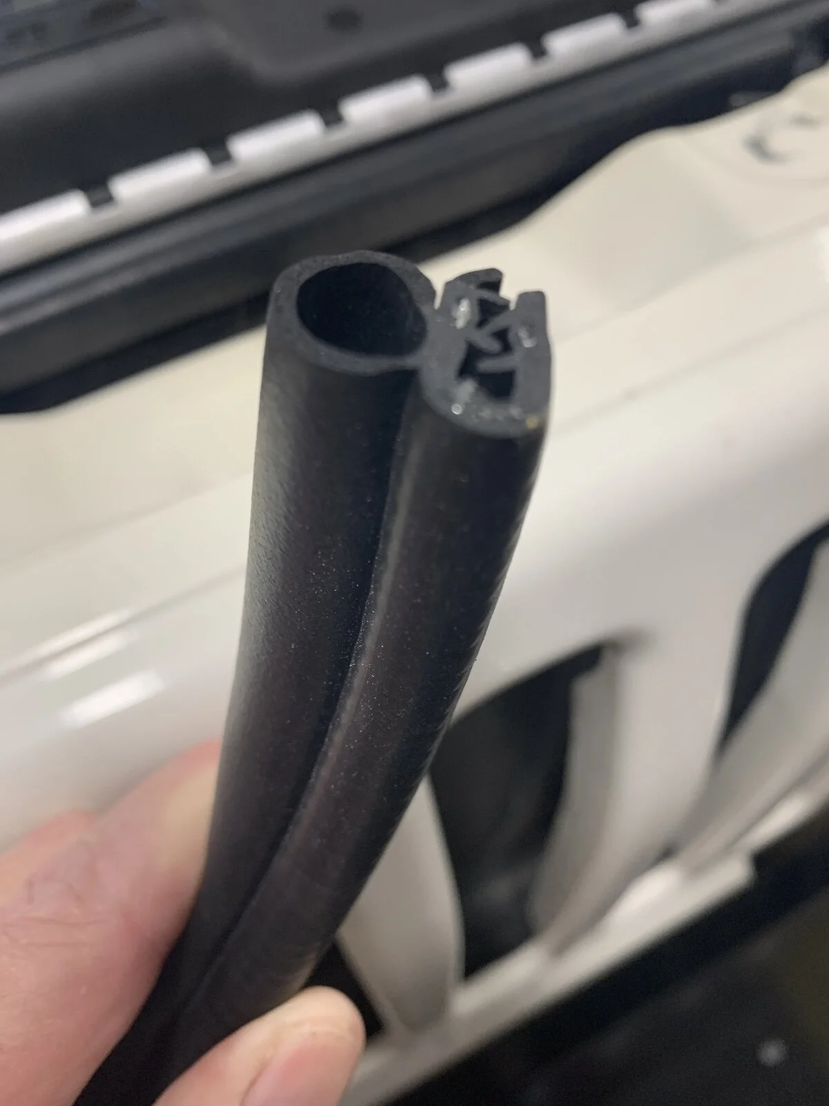

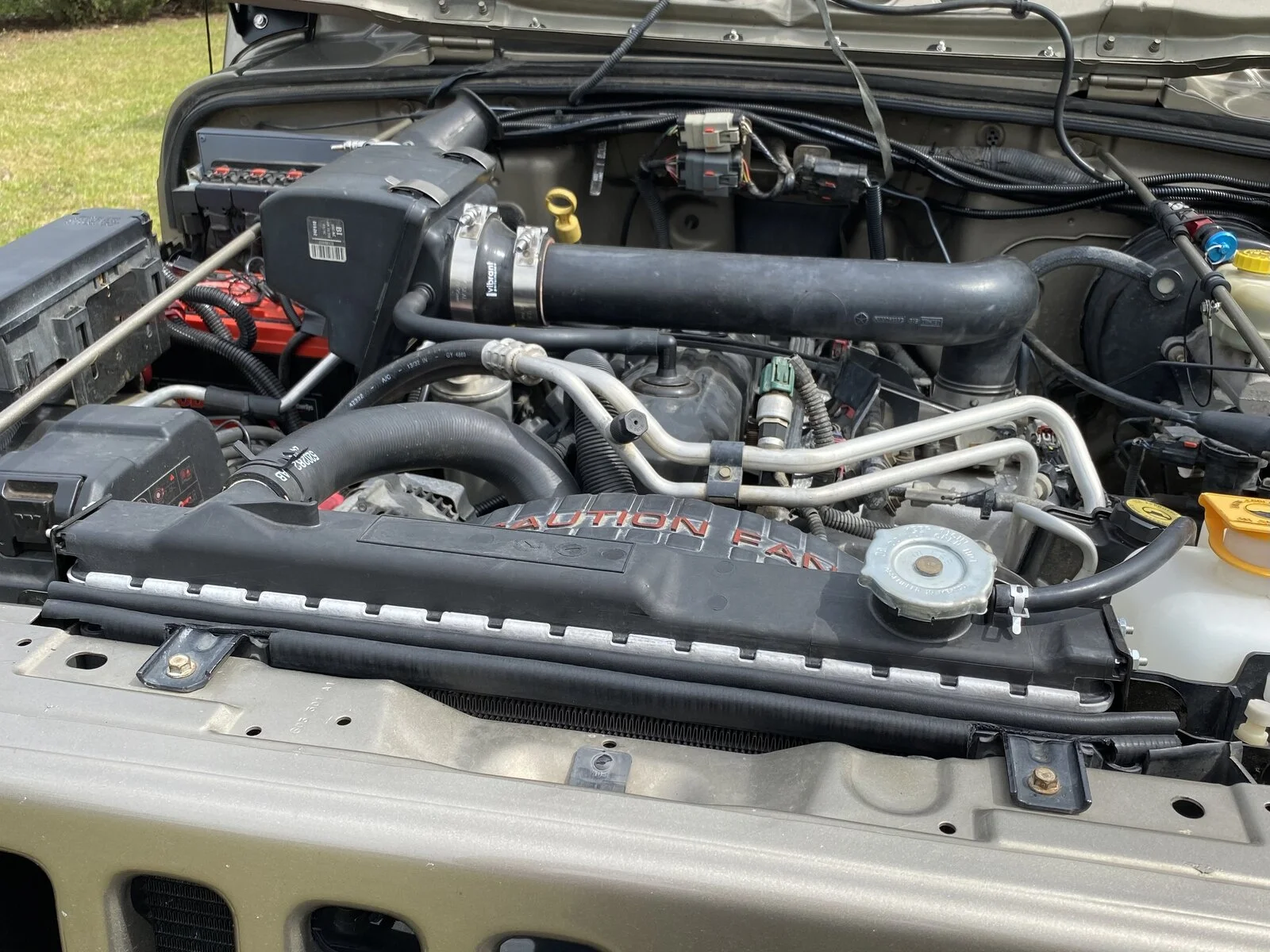

I just used some run-of-the-mill weatherstripping from Home Depot that I had on hand. It's white and ugly as sin but it's worked for a few months now. Next comes the problem of removing it and replacing it with some of the same in black.

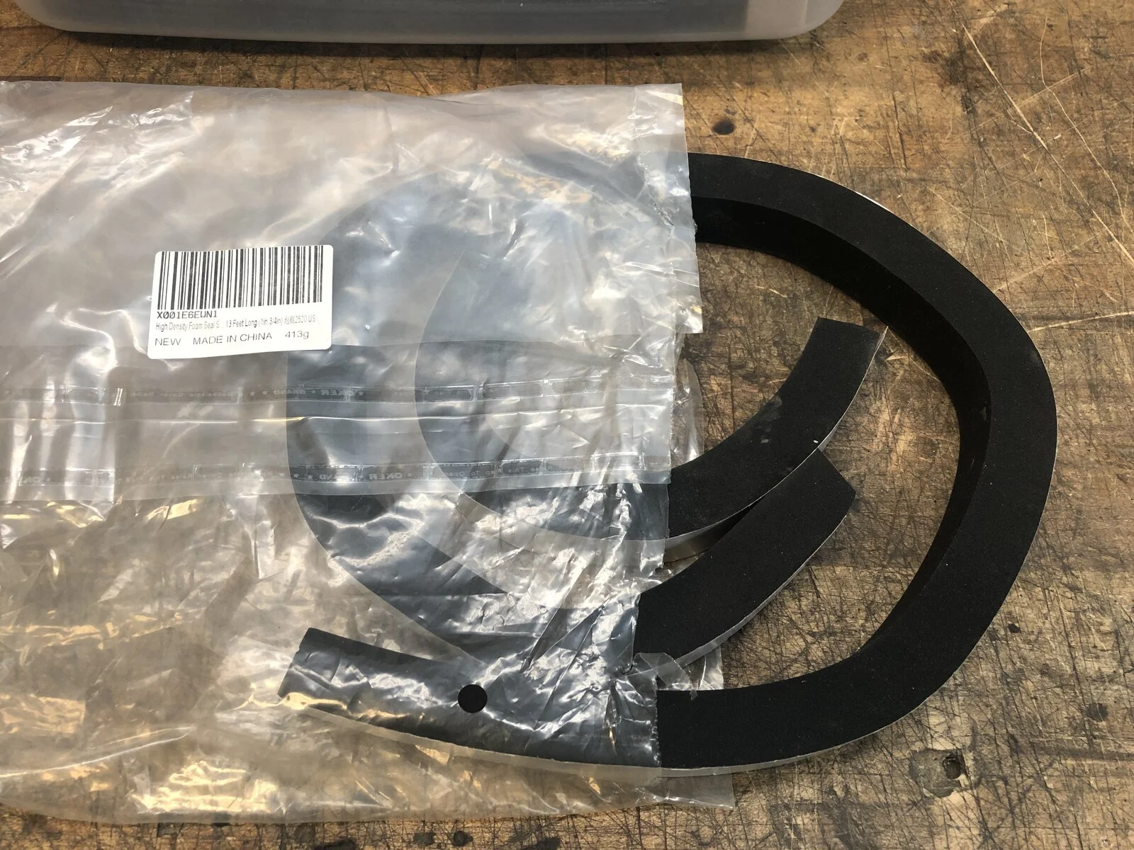

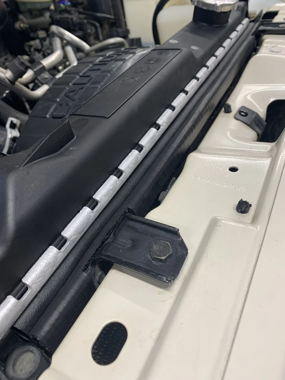

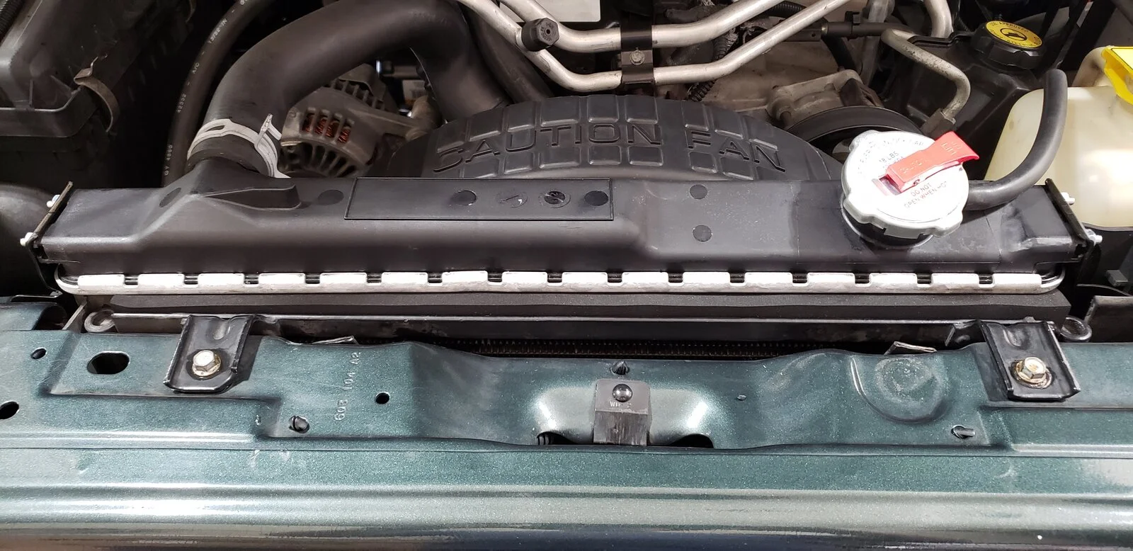

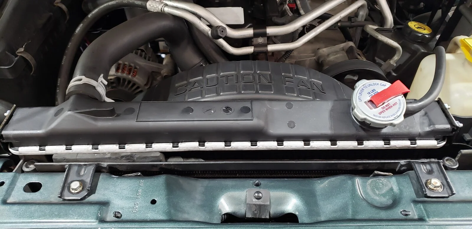

I ended up ordering this
https://www.amazon.com/gp/product/B07M83PYPR/?tag=wranglerorg-20
Installation was easy, without having to loosen anything. I cleaned out the old seal, then measured and cut a piece to fit. Placing the paper side down, leaving the paper covering the adhesive on, I started on the driver side and fed it through to the passenger side. Once I got about 1/2 way a pair of needle nose pliers were used to pull it the rest of the way. 10 minute job, tops.
