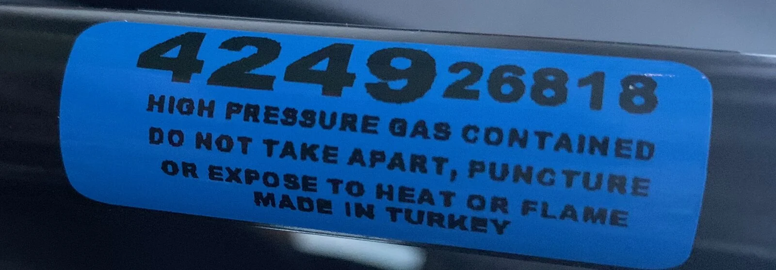

Thanks man, but I just want to make sure I’m asking because I have never owned a hardtop and I do not want to end up breaking the new glass. I attached a picture of how small the old ones are in comparison
Those short ones look like a headache ready to happen.

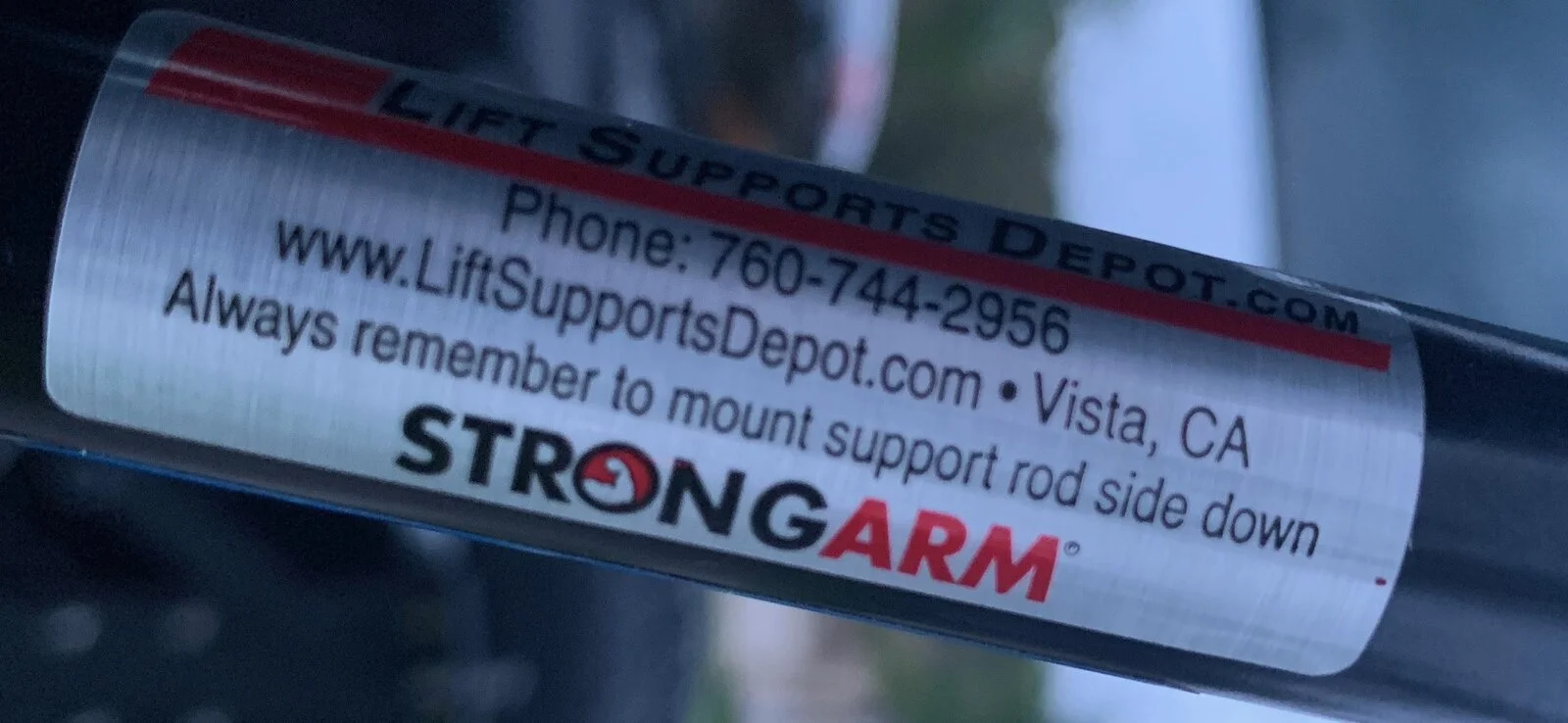

These were on my top when I bought it. They are strong enough for one strut to hold the glass up but may not in cold weather. It takes a little force to close the glass but I dont have the feeling I will brake it.

All I know is they were on the top when I bough it and I believe my picture shows part numbers. They work fine. The glass goes a little higher than horizontal which is perfect for my Jeep on 35's and 5 inch lift.
