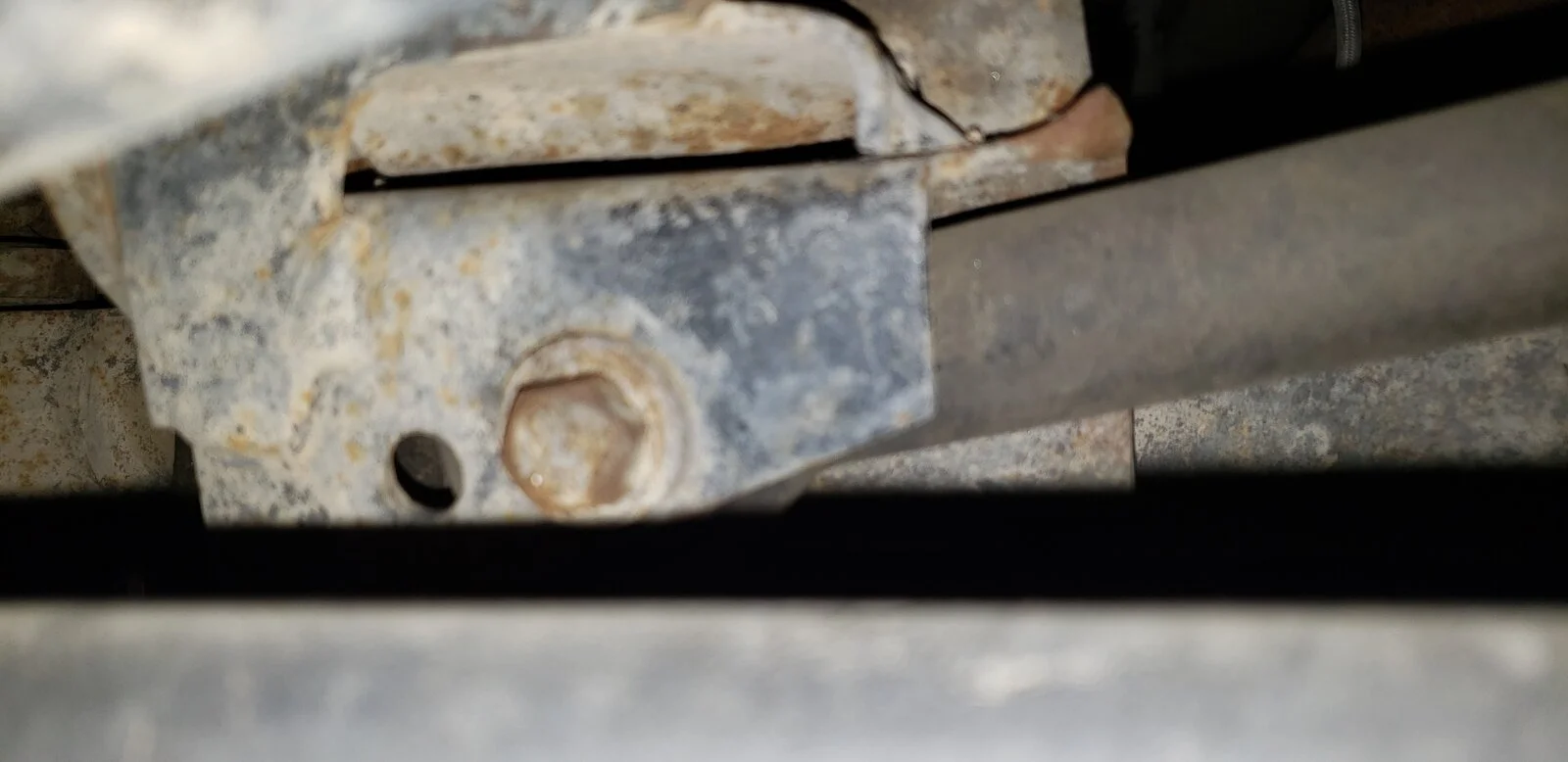

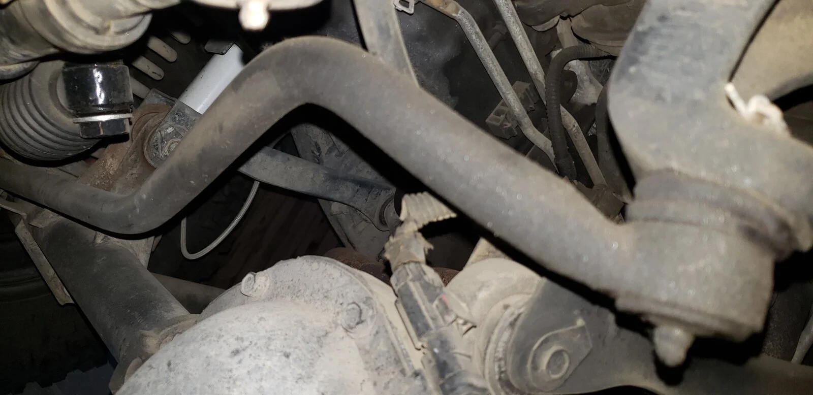

Is your axle centered? Are both sides of the trackbar attached to factory locations? Some pictures of each end may help see what's going on
Is your axle centered? Are both sides of the trackbar attached to factory locations? Some pictures of each end may help see what's going on.
The axle is centered, however I noticed a second hole on the axle side.
SecondChanceTJ
Leaky Jeep
Jan 15, 2020
779
Lake Charles, Louisiana
Aha, that clears things up. I don't think you'll find a longer "one-piece" replacement track bar, but you will find many adjustable track bars for sale. The most commonly recommended ones here are RockJock and JKS. Worn or loose track bars can allow death wobble. I would definitely replace it if the joints are worn and are allowing unwanted lateral movement. That said, there are cheaper ways to do that and more expensive ways.
