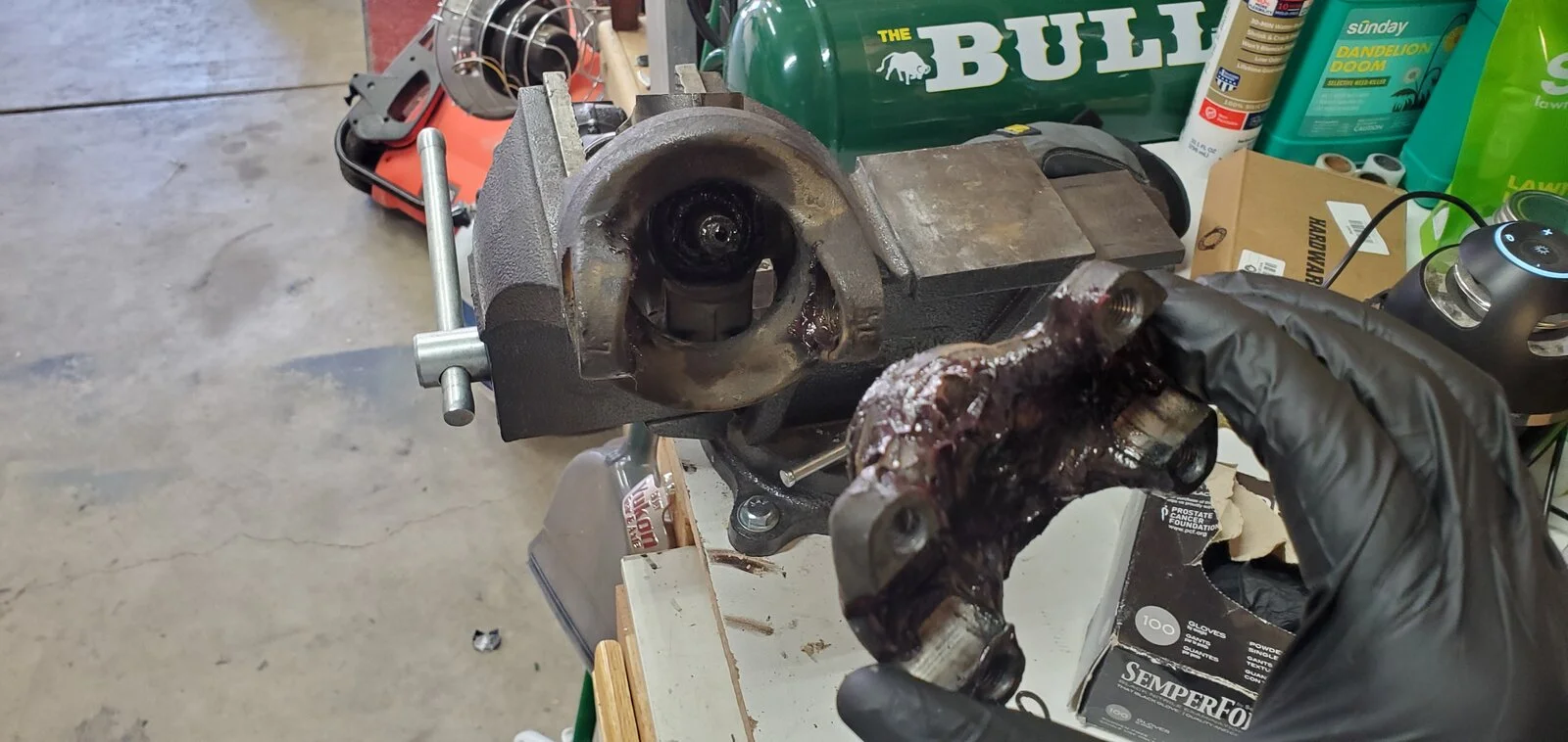

Yep. The ball is on the otherside of the centering yoke (what I am holding)
Backside of it here (make sure yours doesnt do this :LOL:) :
https://wranglertjforum.com/threads/tworley-build.10974/post-435911
