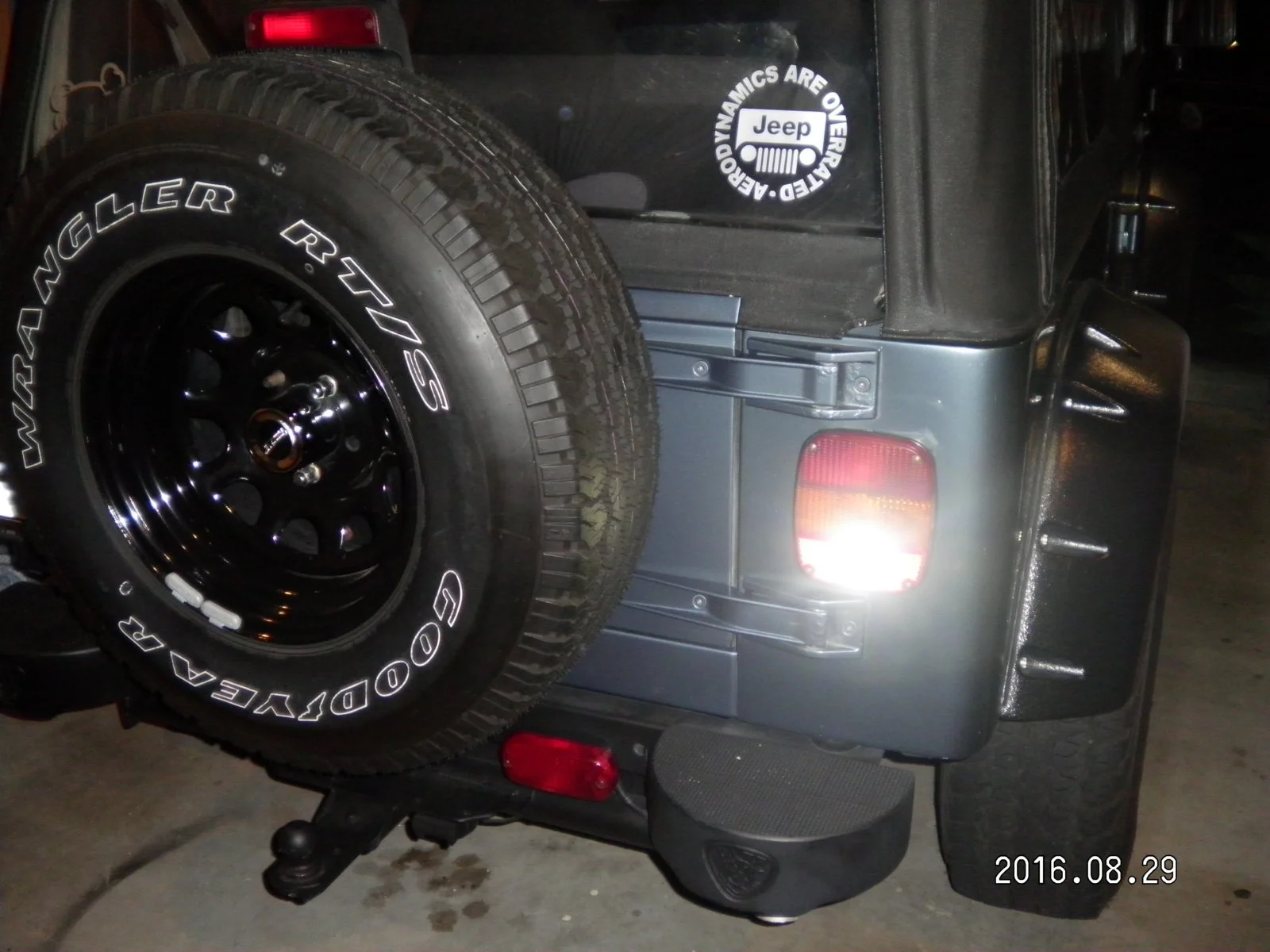

We all know about how the 'illuminating' the rear reverse light is on TJ's.;)... I came across a low budget replacement option, probably been done before but couldn't find a thread,anyway ....I replaced the standard bulb with a bayonet fitting LED. Massive difference and a quick ,cheap and easy mod.

Genius for sure.. lol basically it looks like the old bulb we know and love but has an LED inside instead of the filament... simple plug and play but with sooooooo much more light... did the same with my rear lights as well, instead of a white LED I got red ones... now people can see me from behind.

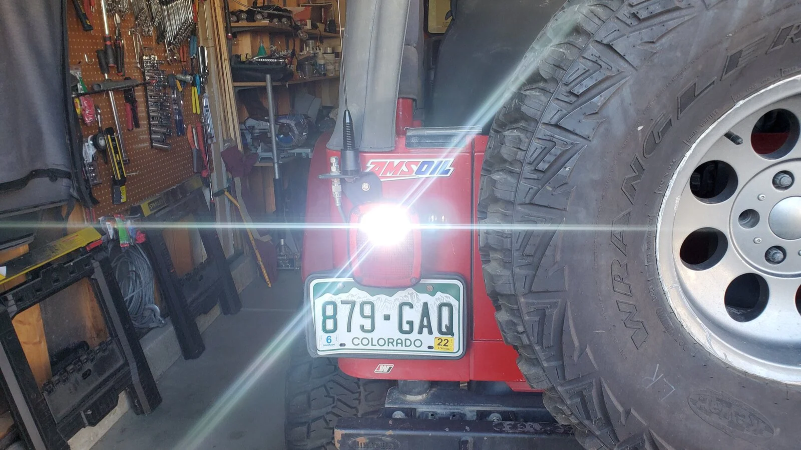

If the ones you are looking at or what I’m thinking they really don’t project well-
These do- Notice the end is a bulb also-

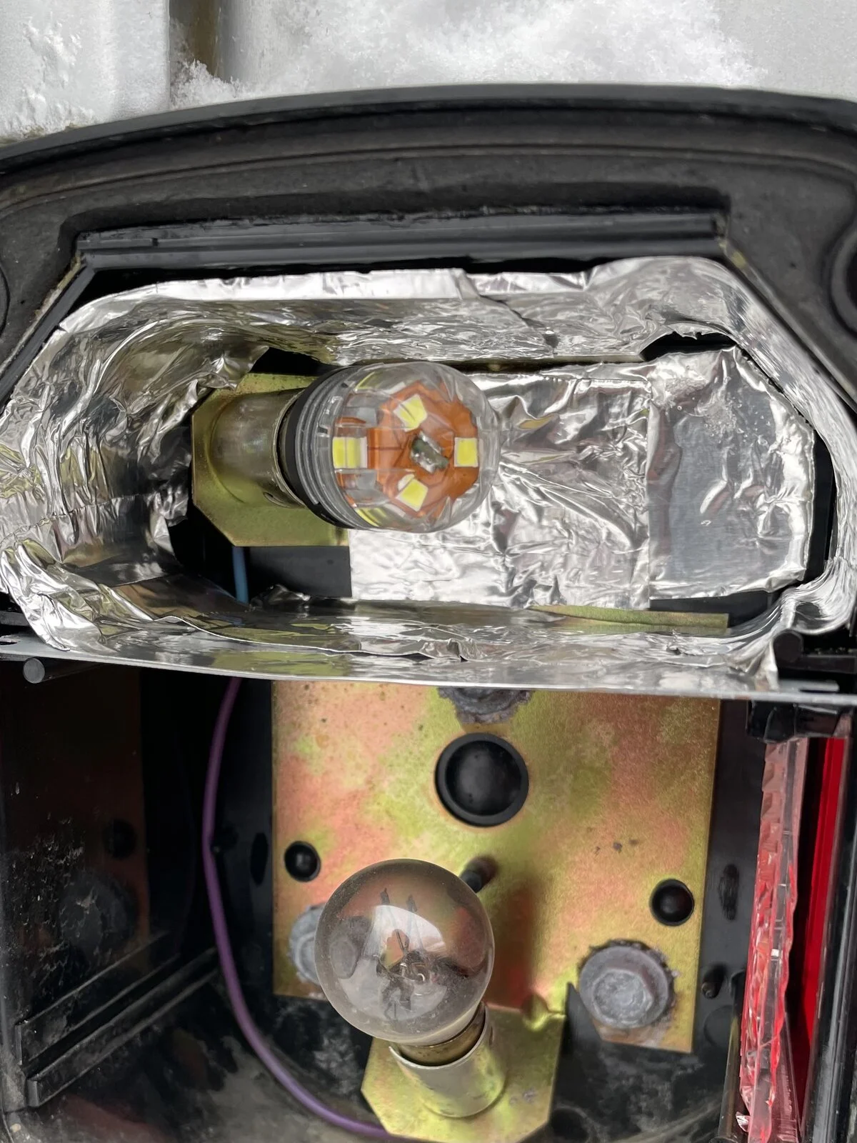

Not sure if he is making them anymore due to supply but @Claytone makes a hell of a reverse light
I bought a set of those LED reverse lights when @Claytone posted them For Sale early last year....
They are a projector style LED with a heat sink incorporated.
Prior to installing the LEDs I installed strips of aluminum air conditioning ducting tape (similar to Zorba) inside the tail light housing for both the parking/brake lights and the reverse lights; the increase in usable lumens is quite noticeable.
James9100
May 3, 2021
304
Saskatchewan, Canada
For those of you that just put an LED into the reverse lights and lined the housing with foil tape, did you line the whole thing (of the upper reverse light section) or is there a “strategy” to tape placement as far as reflecting light the best?
Or is this about all you did?
