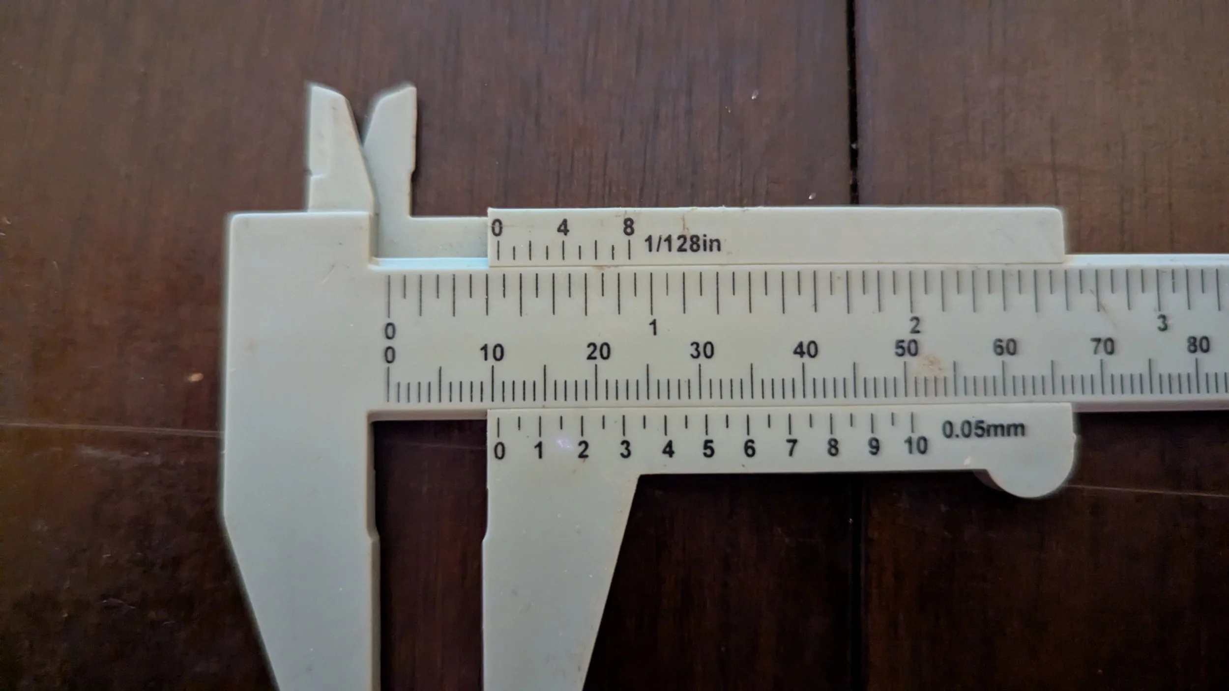

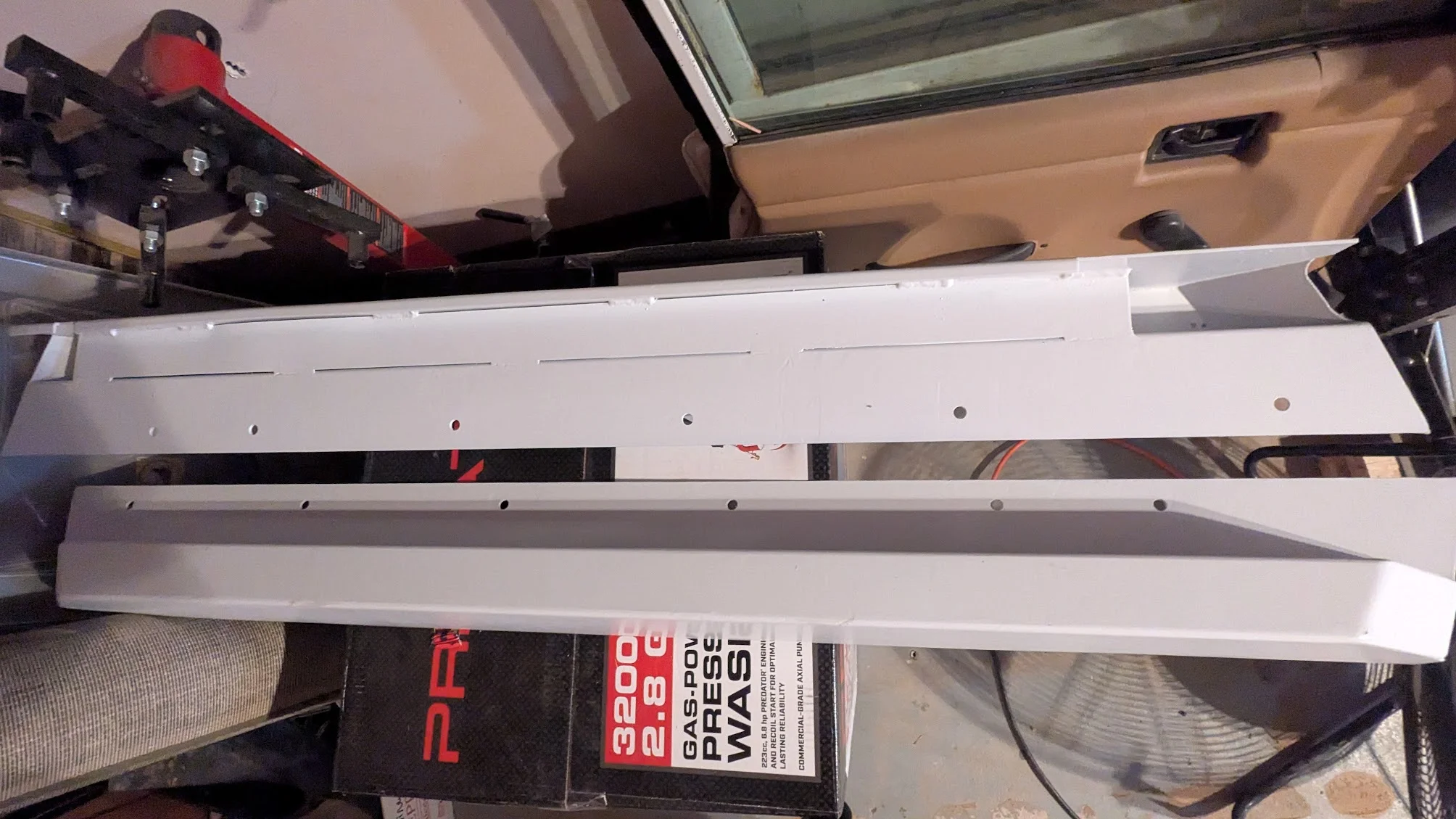

I do not even know where to begin. What is with the odd hole spacing? FYI, that is about a .410ish hole. Not sure what to do with that.
Ok thanks. And I don't know, they were given to me and I wouldn't have the money for sliders otherwise so I am not going to complain. I need some kind of slider and so here we are

I was about to ask if someone who didn't like you very much gave those to you. Now I know. Are they as thin as they look in the picture?
It looks like the bottom flange is 1/8" thick. I've hit the rocker a couple times by now so I figured anything is better than that.

Hey all, I have some rock sliders I'm trying to install. They are thin, about 1/8" or so but the mounting holes which are not countersunk are overly large or about 13/32". I need an idea of what nutserts to use and corresponding fasteners.
