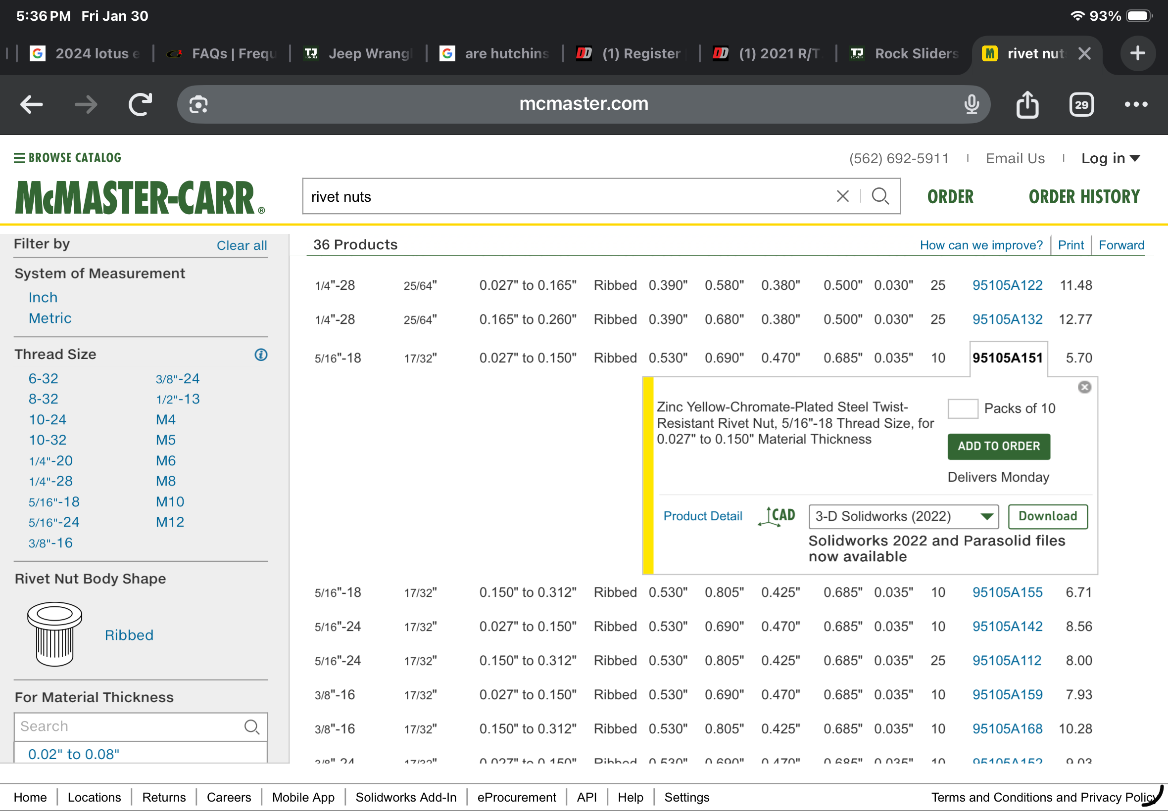

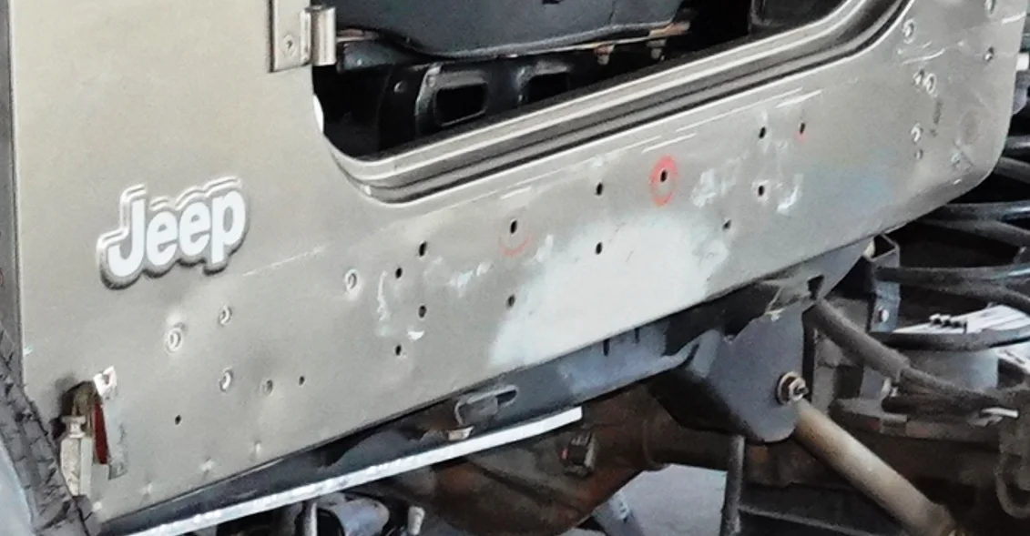

Unless you can get a copper backer behind to control the burn through, you're just asking for trouble. If you could get the copper weld backer in, you wouldn't need a nutsert.My first thought was to fill the holes with spot welds, but my worry is if the weld isn’t flat on the back side the nutsert won’t sit flush.
Yes, we use some nutserts. When your question is a bit less vague, so will my answer be.What nutzerts do we all use for this?
Where are they being used. What are they being used for? Are you mounting your flares back in place? Are you repairing the ones or adding the ones at the back of the center console? Are you replacing the ones that hold on the belly skid 97-02 or 03-06? Are you fixing the ones that hold on the trans skid for the 03-06? Or something else perhaps?What size and other details a person that is not a nutsert expect might need to know?

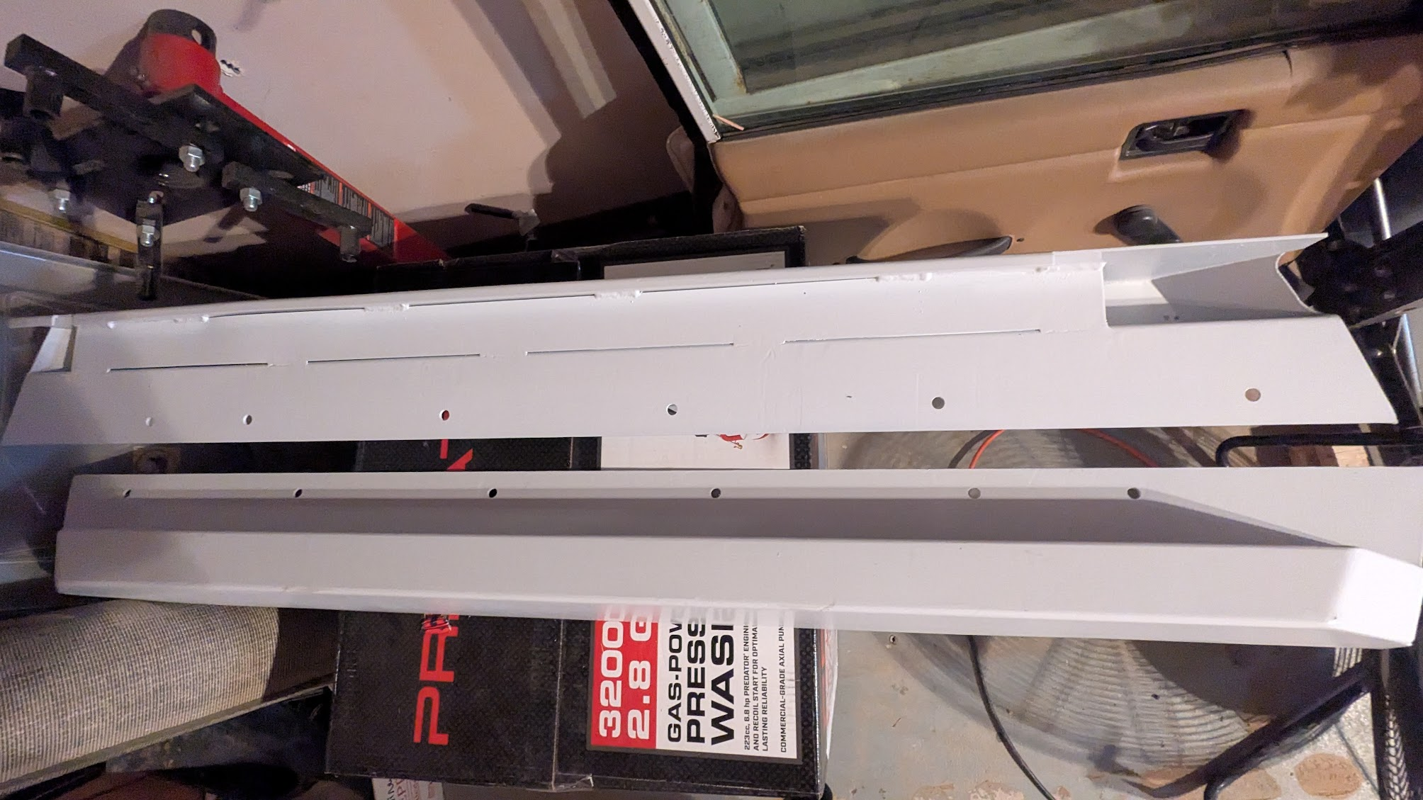

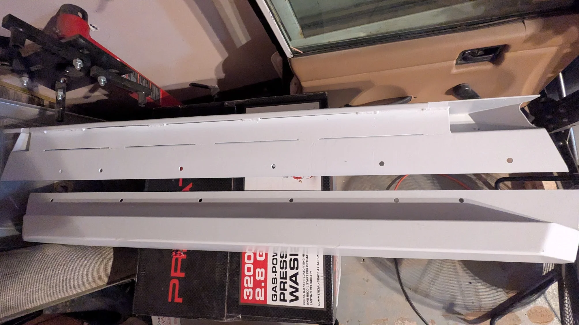

What size bolt/screw are you using to mount the sliders with?For mounting rock sliders onto the tub at the places you can't reach from behind
Currie used 1/4-20, Genright, Savvy, et al use 5/16-18, Flux Offroad uses 8mm, Poison Spyder used 3/8-16. Shouldn't we try and find out what fasteners he plans on using to make sure at least the countersink angle is correct?

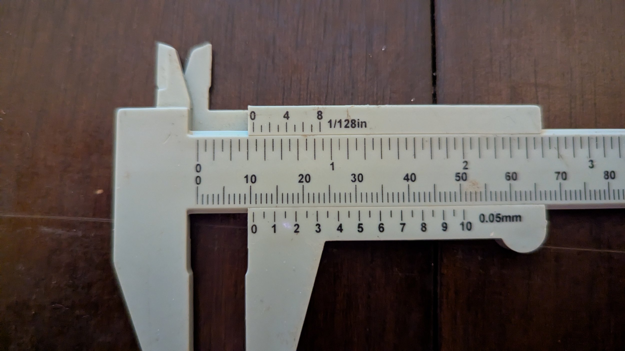

If you continue to be this vague and silly, I'm going to let you do it without my help. What are you trying to do? Be fucking specific. Are you just going to use panheads or hex head bolts or do you have some fucking countersunk holes to deal with?I also don't know that, but I figured if I knew what nutsert size people were using I'd also know an appropriate bolt size!
What size is the fucking hole?The sliders I have are not countersunk, I wasn't planning on countersinking them (though I can if it is better that way?)
Show him the sliders.
