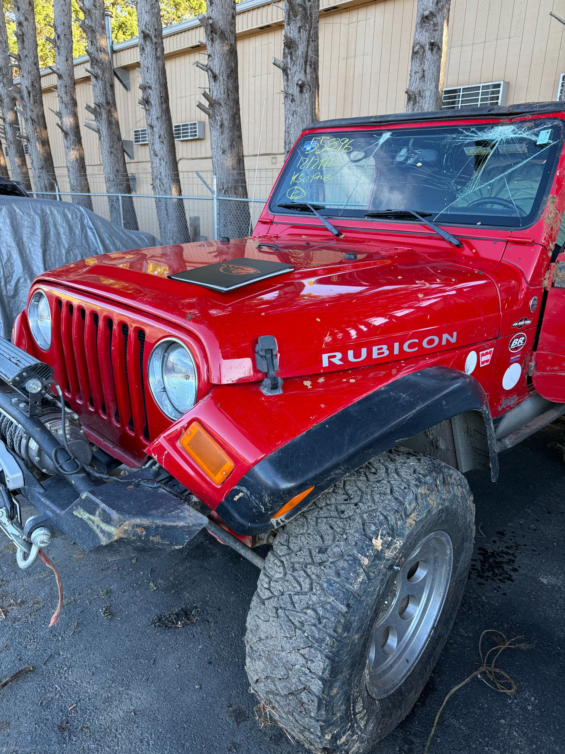

Since the front grill and bumper look to be in ok shape and the hood is not pushed in, I would think there would be nothing wrong with the engine. And hell since its a Rubicon even more reason to keep it and fix it.

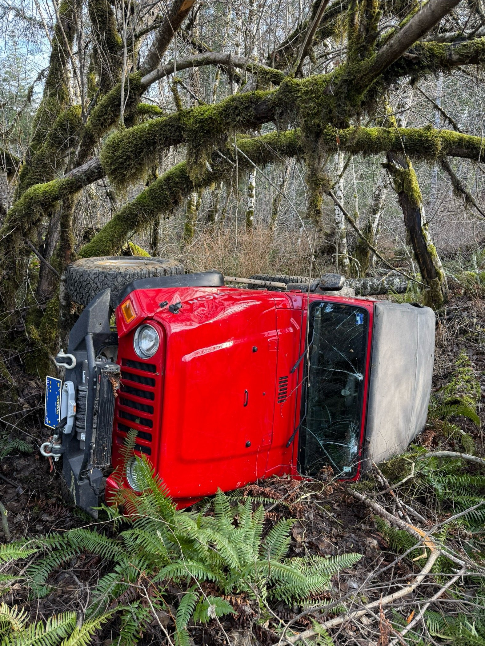

That's a bummer! I'm surprised no comment on this part yet. Did you pull plugs by chance prior to starting? If it was on it's side that long then started there may have been oil in the cylinders. Someone smarter than me will have a better answer but pretty sure that can do significant damageIt was on its side for about 4 hours and 24 hours later I was able to start it up just fine, let it run for a couple minutes and shut it right off.
He ran it for a few minutes when he right-sided it so sounds like he already rolled those dice and came out good.
Info for me… If it’s going to happen is it pretty immediate?
An oil hydrolock would happen just like a water one, it's not compressible like the air/fuel mixture is. Hydrolock happens when the piston compresses the cylinder the fluid stops it before TDC. Most likely the maximum amount of oil would be in the cylinder just after being righted. Assuming idling for 5 minutes, each cylinder already did ~1,500 compression strokes and moved about 1,000 liters of air. I guess there still is a chance that oil gathered somewhere in the intake track and could migrate later as @Strizzo mentioned.
Painful to see that beautiful TJ wrinkled but it looks like a good reason for aftermarket fenders and a new top. Get the buyout from the insurance company and make it your spring project.
