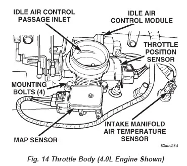

When your foot is off the gas the engine depends on the IAC (idle air control) for all of its air. When it gets dirty from combustion byproducts it will cause idle problems. I'd clean it with an aerosol throttle body sprayed into the throttle body opening while the engine is idling. The IAC will suck the cleaner in through itself and its air passages and get the entire IAC system cleaner than if just the IAC was removed and cleaned. The IAC will flood with the cleaner and the engine will stall which is normal. Let it sit a few seconds to let the cleaner work then restart the engine and do it repeatedly until somewhere around 1/3 of the can of cleaner has passed through the IAC. Don't raise the engine rpms to stop the engine from dying, that'll cause the cleaner to bypass the IAC.
Aim the spray at the IAC passage inlet where the IAC draws its air in through...
