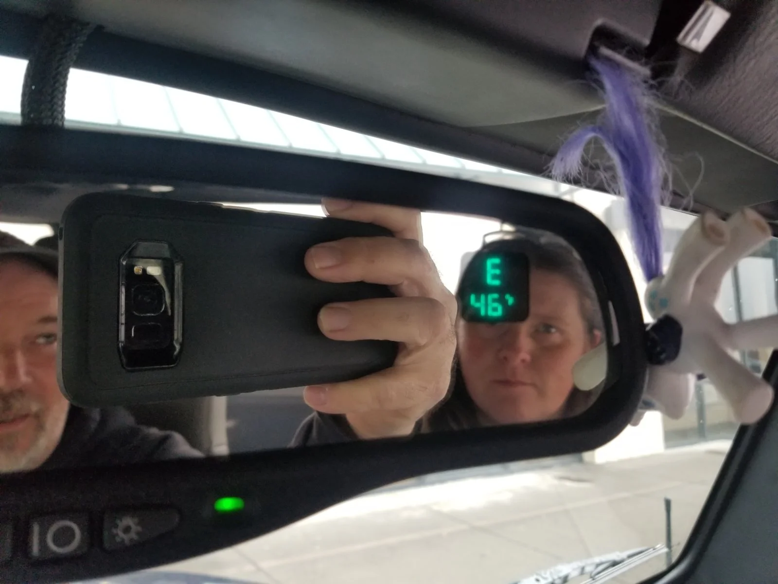

How do you turn the mirror display on/off?
The on/off button...
It's between the two map light buttons.
The what? I think it was last week that I accidently rediscovered the map lights exist.The on/off button...
The what? I think it was last week that I accidently rediscovered the map lights exist.![]()
Do you not have the button? It's "I/O" smack dab in the center.
It's there. It's just one of those things I don't see anymore while driving. All I ever do to the rearview is look at it, occasionally adjust it and appreciate the auto-dim.
Loose connection woot woot
Scott, where did you find loose connection?
My mirror did the same thing, lights but no display, the plug on the back of the mirror was not plugged all the way inScott, where did you find loose connection?
Howdy, mine doing same thing, do you recall where your loose connection ended up being??
I'm having smiler issue where was it loose?
