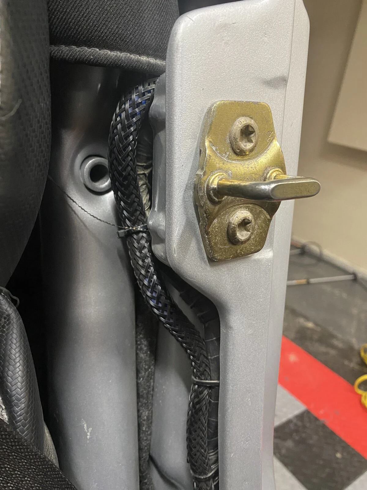

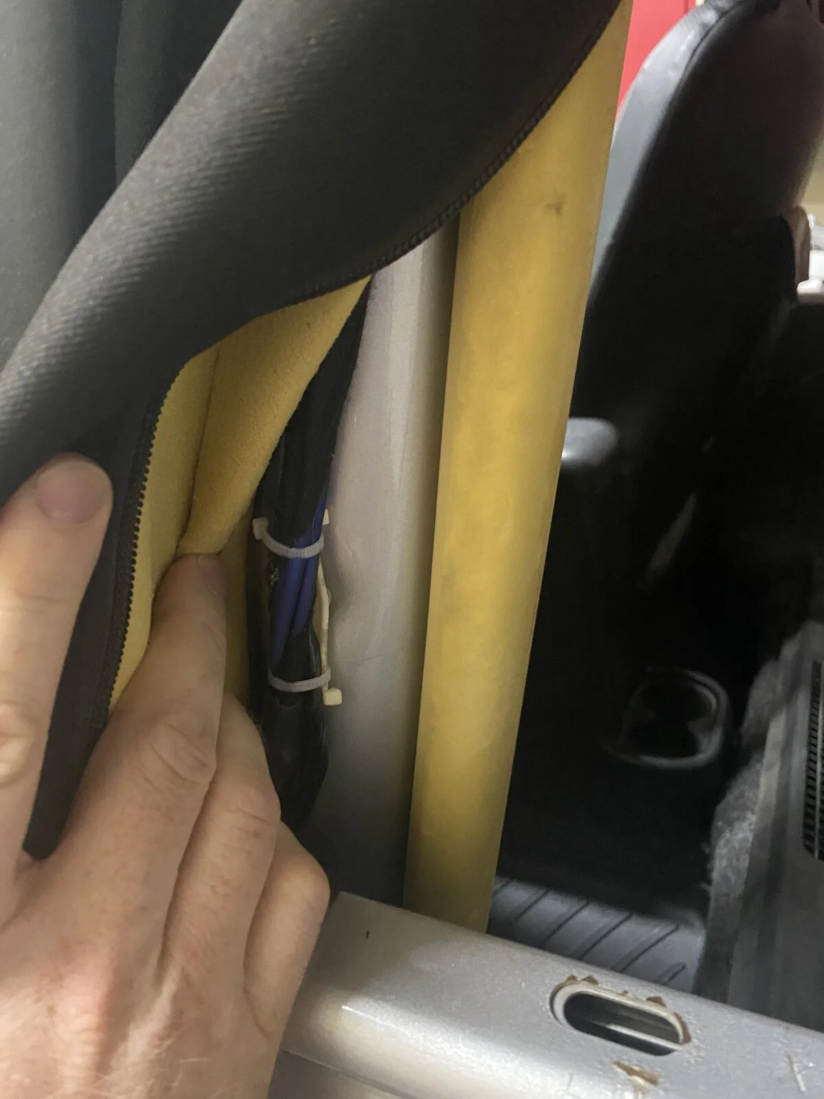

I have 240 watts per channel so the way I did it... I ran it from my drivers side kick panel strapping to my hardtop harness that runs along the lower inside. Then I branched off and ran up the driver side roll bar (for both L&R speakers). Once you unzip the cover it becomes pretty obvious what to do. There is the existing black harness that is already strapped to rollbar, just run new cable alongside it and put a few zip ties in for good measure. You should be able to feed the wire straight into the pod through the existing rubber grommet - just lube it first.
I used KnuKnoceptz Kord Ultra Flex which is really flexible and made it easy to run.
