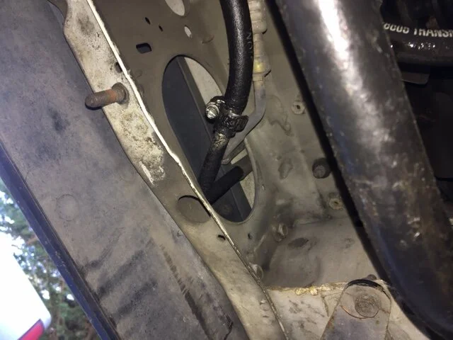

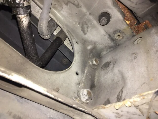

Thank you. Also, do you know what the part is that I’m pointing to in this picture? It’s behind the front bumper between the frame brackets. The front bumper brackets attach to it.
Jeremy,

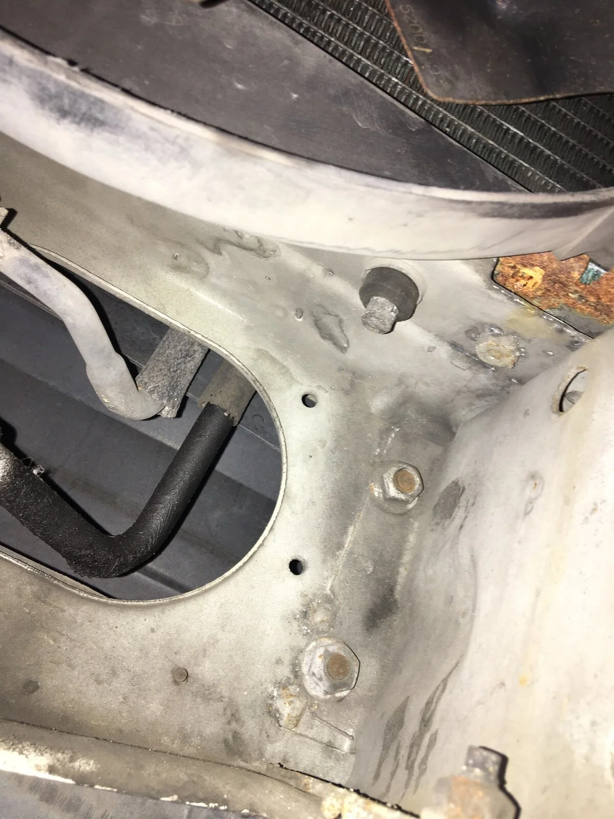

While I can't be 100% certain (as that area on mine is covered by the bumper), I believe that what you're pointing at is the lower radiator core support. Runs between the frame rails. I'll bet yours is bent, based on the first pics you posted. Hit hard enough, that could potentially pull the frame horns inward toward each other. All fixable, to be sure, but you're going to get an education when you do it. Here's pics of the underside/backside of my '96. Yours may look slightly different, as I believe there were some changes starting in '95 or '96.

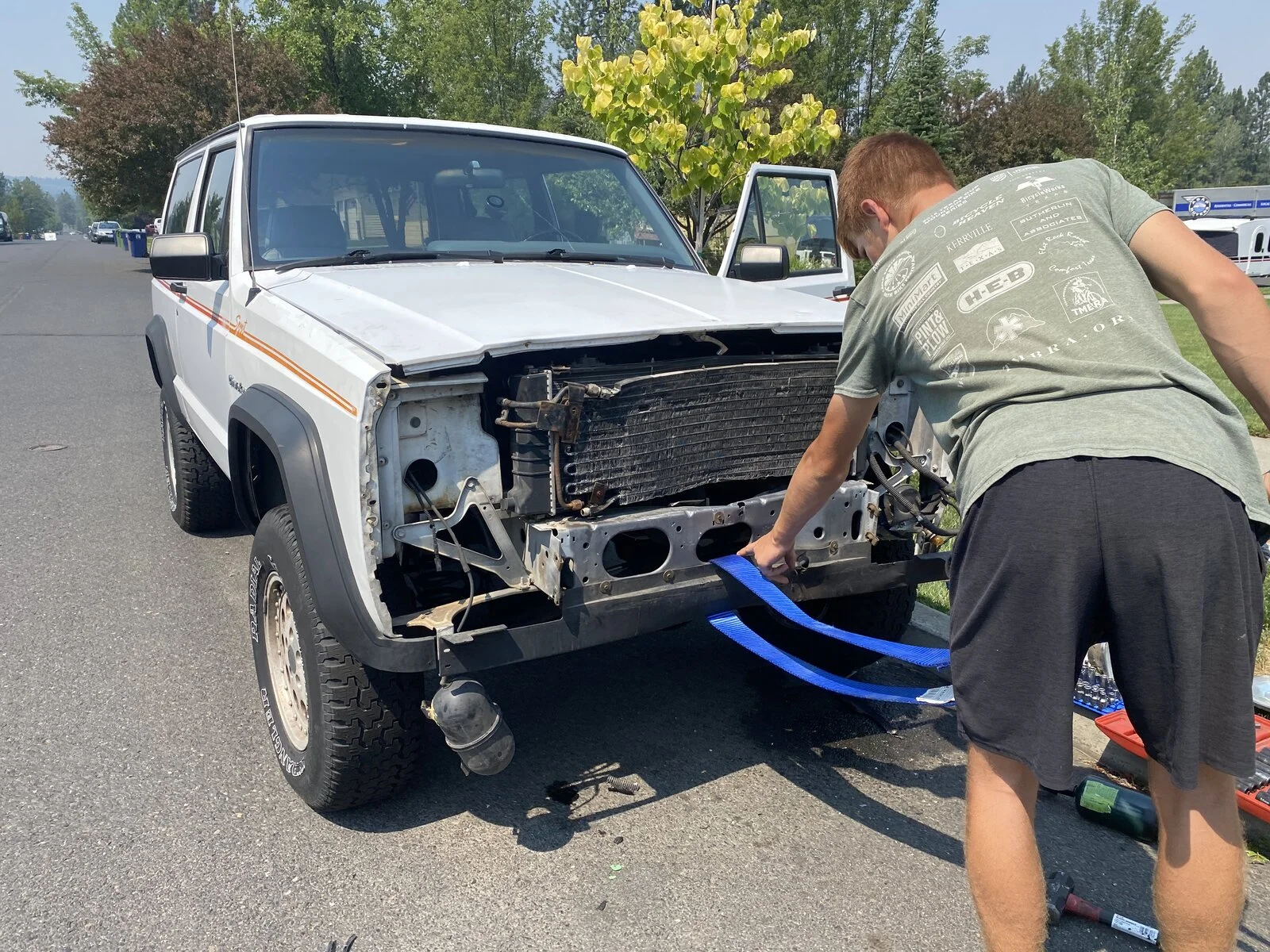

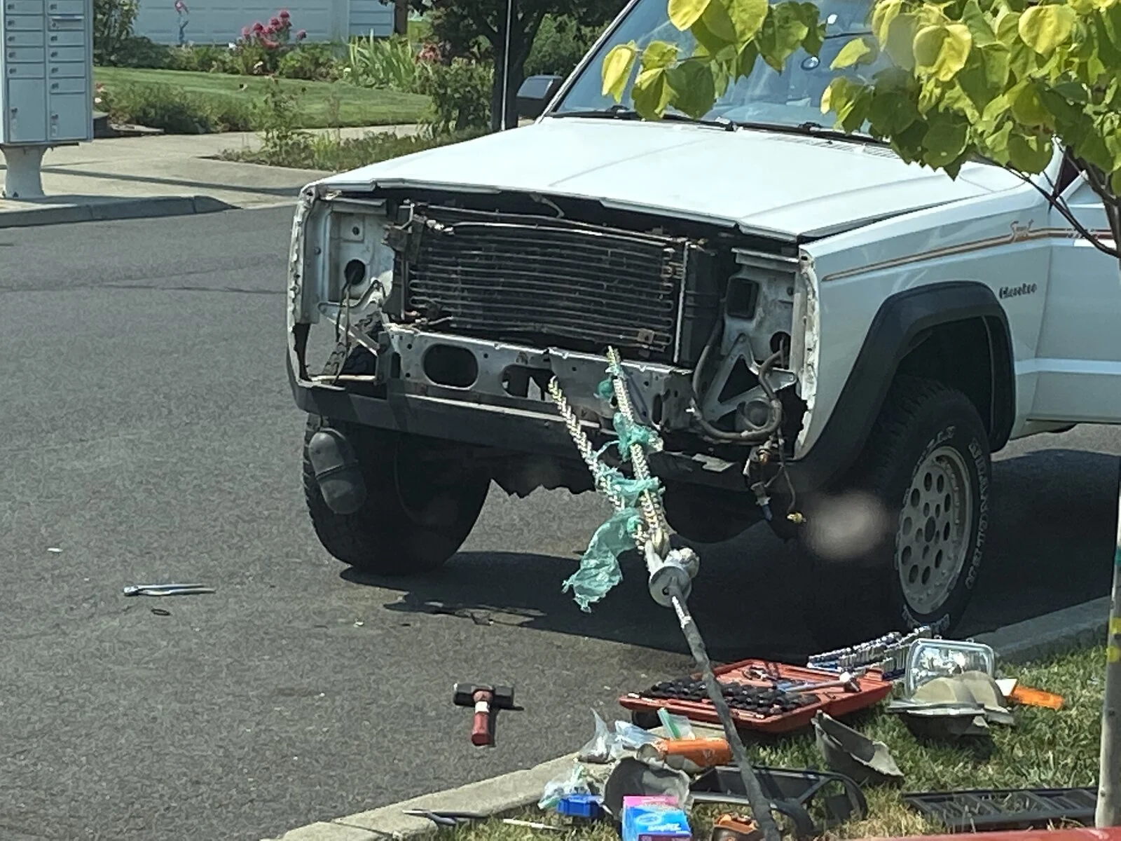

Well, I tore it down this morning. Only issue is so can’t get one of the radaiator hard line nuts off the radiator. I might just get a new line. This one looks bad anyway.

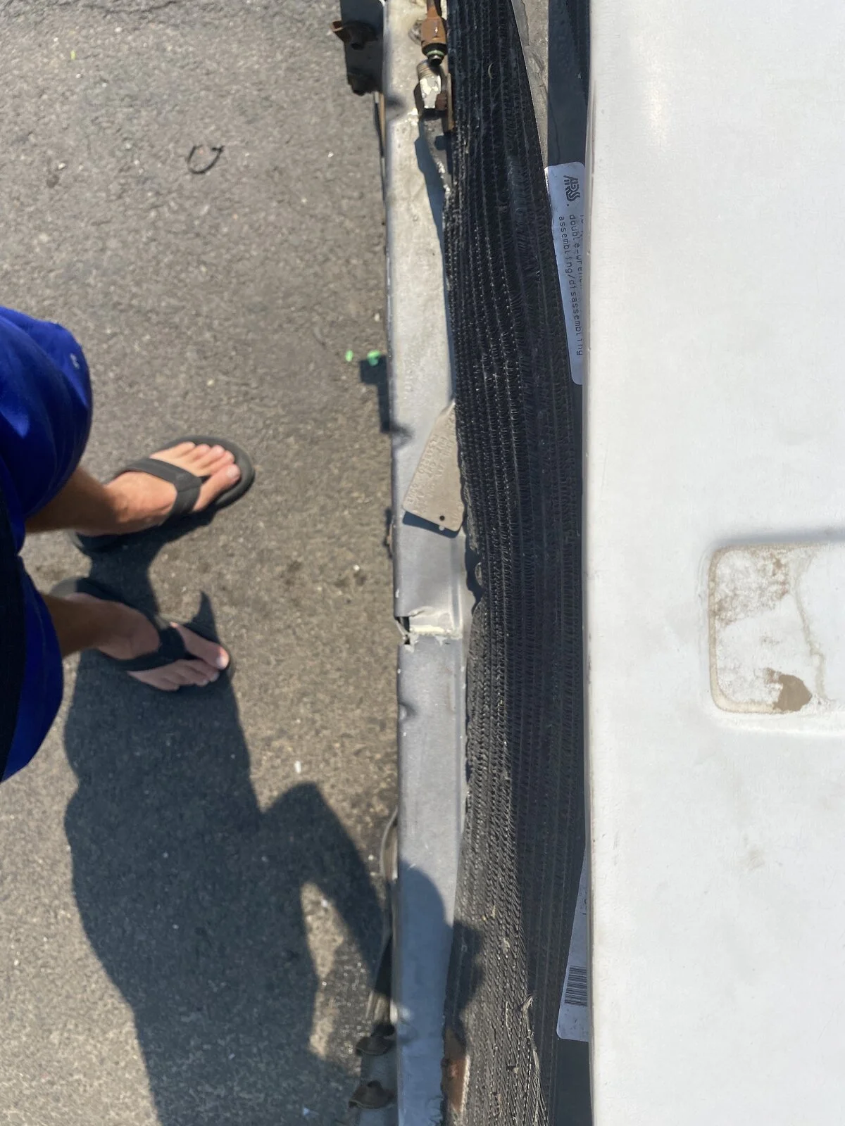

The other issue was what I call the front crossmember. It’s welded to the frame and considered part of it. You need it dor the two bumper brackets. Jicky design if you ask me. It is torn a bit in the back and all bent in. Followed the basics of the video @Squatch sent me, but used my winch for a lot more control than that Jake-leg. It ain’t pretty, but it’s pretty straight across the front.

Already making some good progress! You're correct about the crossmember being welded to the frame rails, but I am almost certain they are only spot welds. One thing you could look into is drilling out those spot welds from a donor vehicle (wrecking yards are full of them in my neck of the woods) and remove the crossmember. Then repeat the process on your XJ, and install the straight donor piece. Of course, you would need to have it welded back in. If you aren't equipped to do so, there are often guys who have small "mobile welding" businesses, where they come out with their own equipment, and do the job right there at your house. Might be worth looking into, if you aren't satisfied with your current results. Just a thought...
