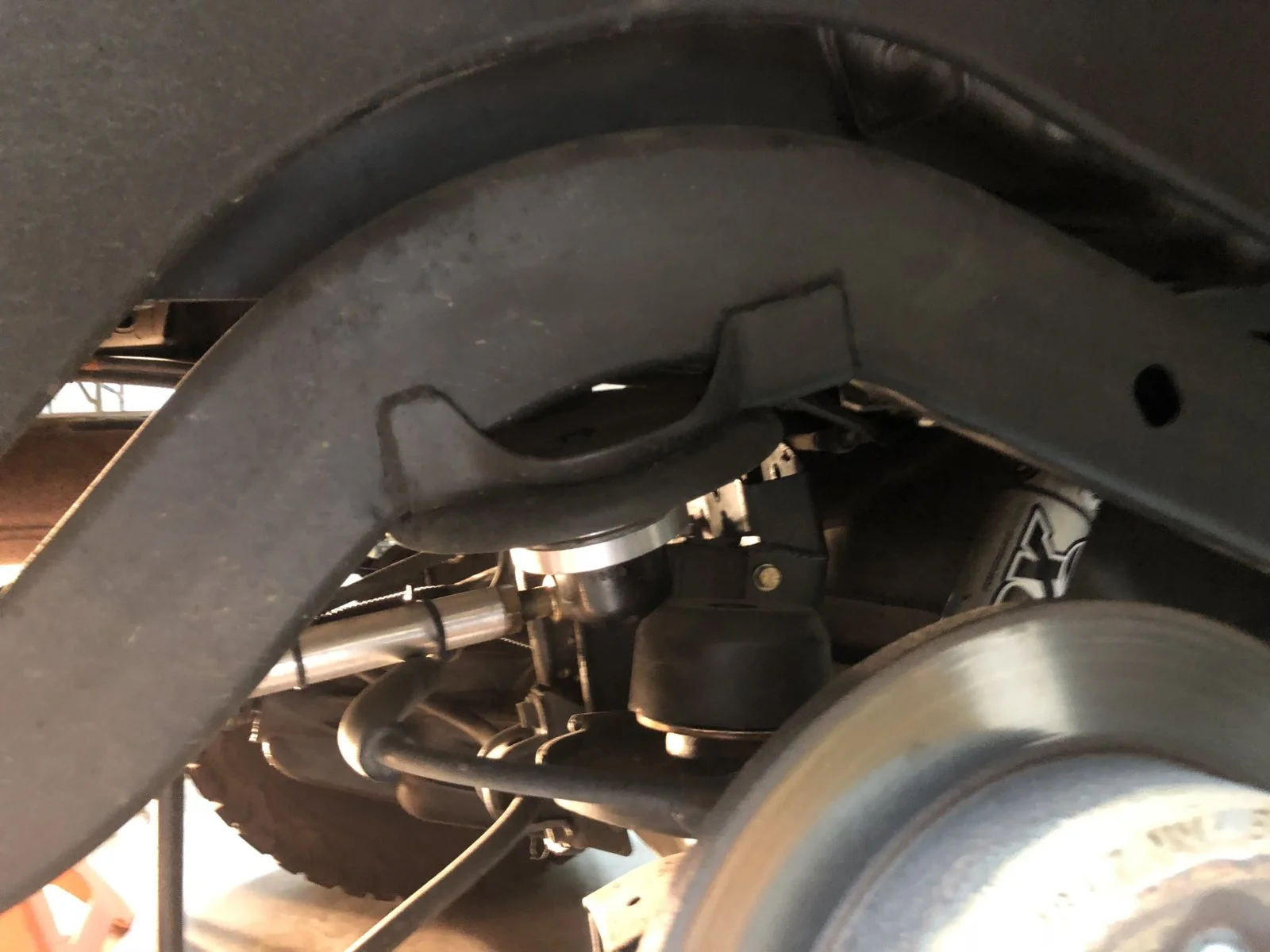

Ed1967 Member Original poster Supporting Member Joined Jun 22, 2018 Messages 74 Location Norcal Jan 28, 2019 #21 Is cutting the spring perch a good way for shock clearance. I have Savvy TT. Last edited: Jan 28, 2019
jjvw AI Moderator Staff Member Supporting Member Ride of the Month Winner Joined Feb 17, 2018 Messages 31,012 Location Colorado, USA Jan 28, 2019 #22 Ed1967 said: Is cutting the spring perch a good way for shock clearance Click to expand... It is very common.

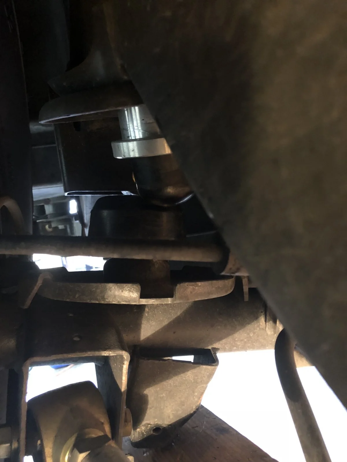

Ed1967 Member Original poster Supporting Member Joined Jun 22, 2018 Messages 74 Location Norcal Jan 28, 2019 #23 Removed Shock relocators and trimmed spring perch. I think I need to move the axle forward and more bump stop for the tire Clearance Reactions: tworley
jjvw AI Moderator Staff Member Supporting Member Ride of the Month Winner Joined Feb 17, 2018 Messages 31,012 Location Colorado, USA Jan 28, 2019 #24 Definitely go forward. You're getting there, though! Reactions: Ed1967
Ed1967 Member Original poster Supporting Member Joined Jun 22, 2018 Messages 74 Location Norcal Jan 28, 2019 #25 Thanks again
jjvw AI Moderator Staff Member Supporting Member Ride of the Month Winner Joined Feb 17, 2018 Messages 31,012 Location Colorado, USA Jan 28, 2019 #26 You are into the fussy stuff. But this is what begins to separate the better setups from the ok ones. Reactions: Ed1967
