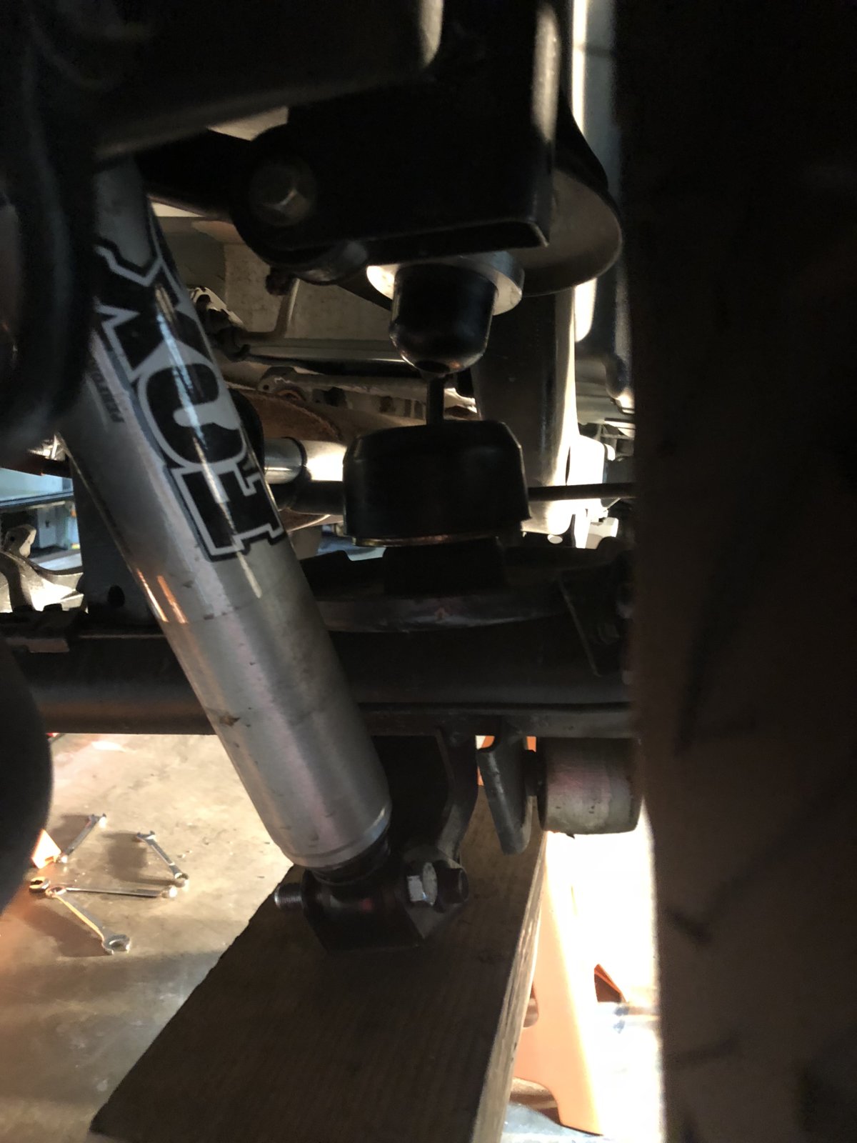

Does anyone have pictures of savvy 4inch lift kit rear bump stops? I have like 8 inches between stops and 4 inch of shock showing. Must of missed a part

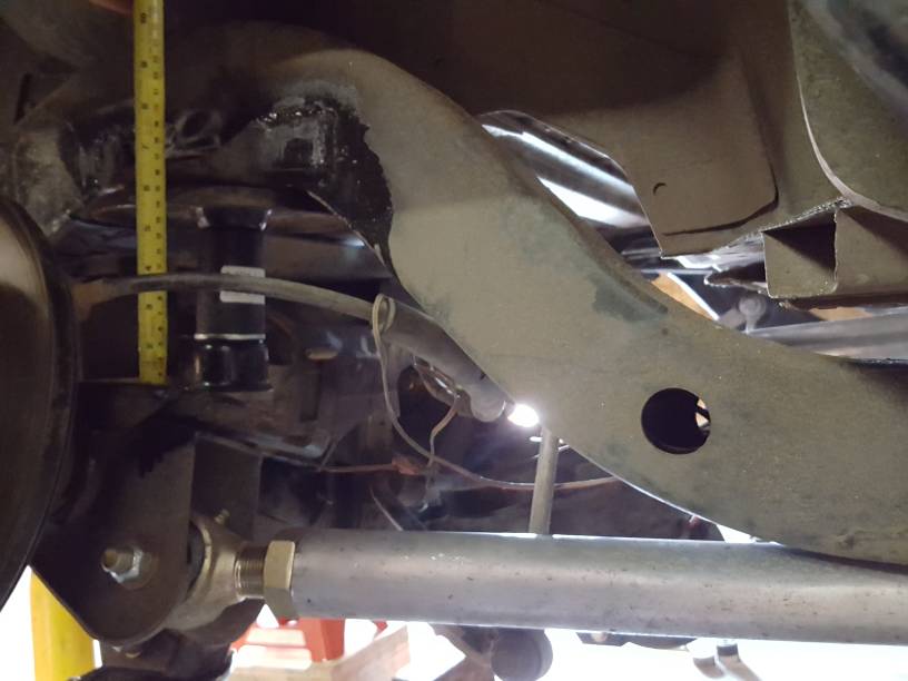

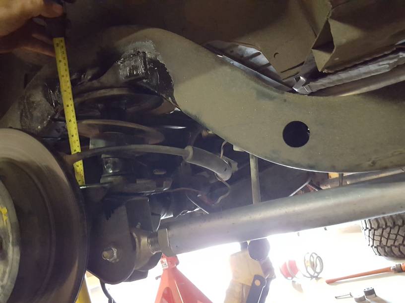

If Savvy didn't provide the shocks or the tires, there is no way they can begin to guess how much extension is needed for your Jeep. This is true for any kit out there. The brand does not matter. All you are doing is filling the gap between the cup and axle pad. It is what it is. Pics of mine will only be an example of why a result might look like. View attachment 74518View attachment 74519View attachment 74520View attachment 74521

When the bumps are touching, what are the shocks doing? How much shaft is showing?

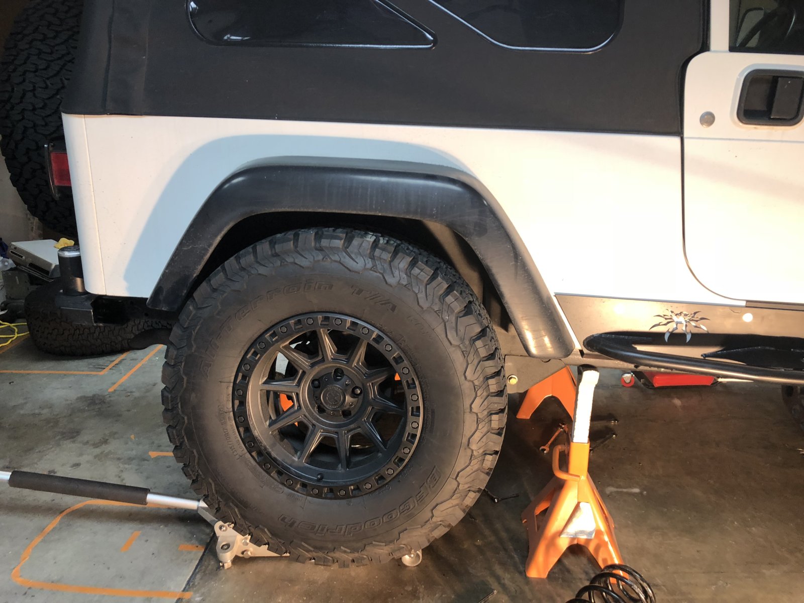

Were the tires on? Did you stuff one side and key the other hang?
Shock is bottomed out. Need about 1.5 to 2 inches longer stops. Tire are not on and other side is hanging

I've never used Currie bump stops. Don't they come with additional spacers? When they make contact, there should be about 1/4-3/8" of shaft showing to account for the poly compressing. Do bear in mind that other things like tires might need more bump stop than your shocks do. That's why I asked if the tires were installed while cycling the axles.
To add, there is a black rubber jounce on the Fox shock shaft. Be aware that the shock can freely compress beyond that. Meaning today image with 4" of exposed shaft really has 4.5" of exposed shaft.
Tires are not touching any thing. But the shock is bottomed out. Do I need to center the stops better?
If that is the case, then yes, you need some more extension.
The bumps could be centered better, but that will require cutting off and re welding the upper spring seat.

If you can remove the shock relocating brackets that would help regain shock travel. You would be better off trimming the axle spring perch.
That help a lot. Just need about 1 inch spacer. Do you guys recommend hockey pucks?
