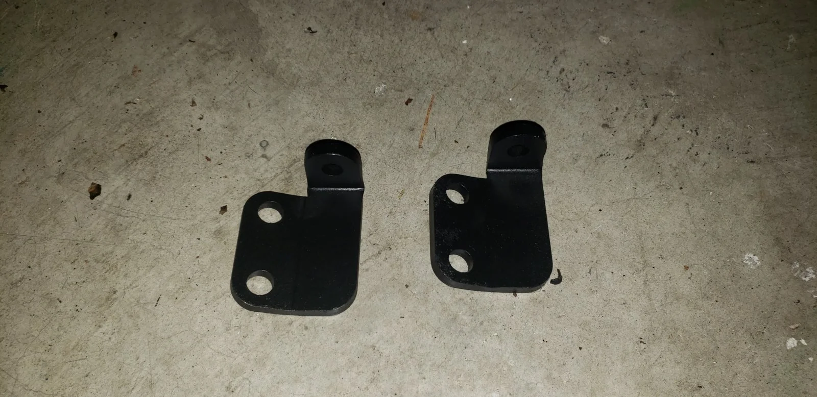

So fair warning this is a terrible picture, the parts are at @Alex01 house right now so I’m working with pictures I took but this one :
I think the other parts I have a rough idea on
There should be 2 of those. A right and a left iirc. One points forward and the other back. They go under the engine mounts to triangulate the front of the engine/trans skid.

The parts are starting to make a lot more sense now that you said the shim looking things go in between the skid and frame rail.
