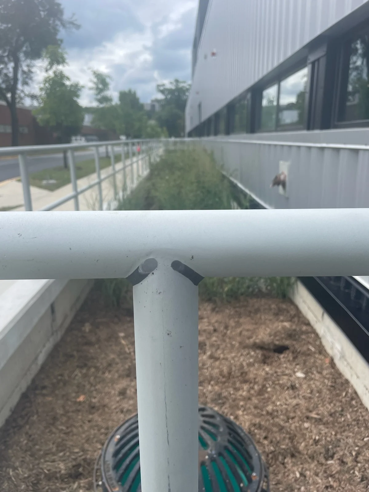

4043 will indeed turn black. Here's a pic of a set of rails we did for NIH (yes, we do work for the devil) where we had a welder pick up some 4043 by mistake. Seven total spots across 400 lnft of rail wasn't bad, but it wasn't good either. EDIT: You can see where he did his initial tack with 5356 (spot in the middle).
Edit 2: If you ever need to check the filler metal, spray it with a little oven cleaner (kind with lye), and the 4043 will also color up.
