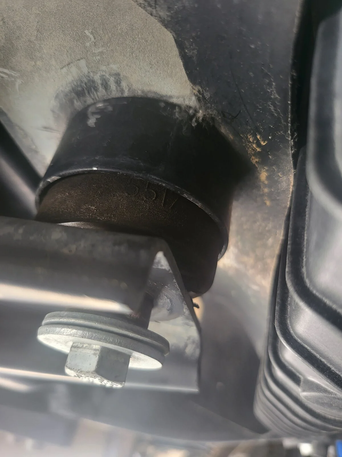

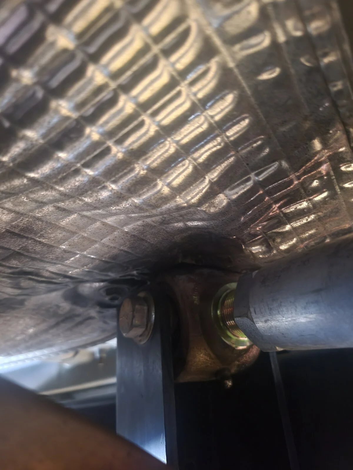

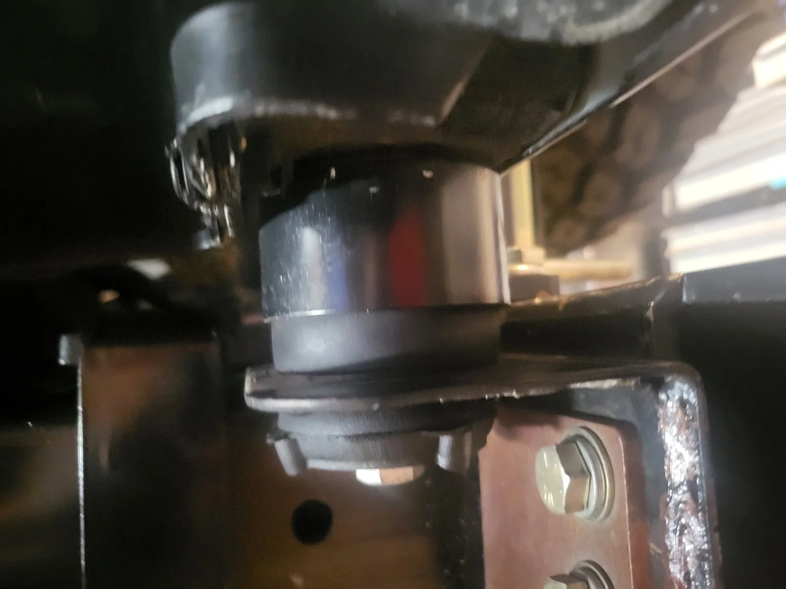

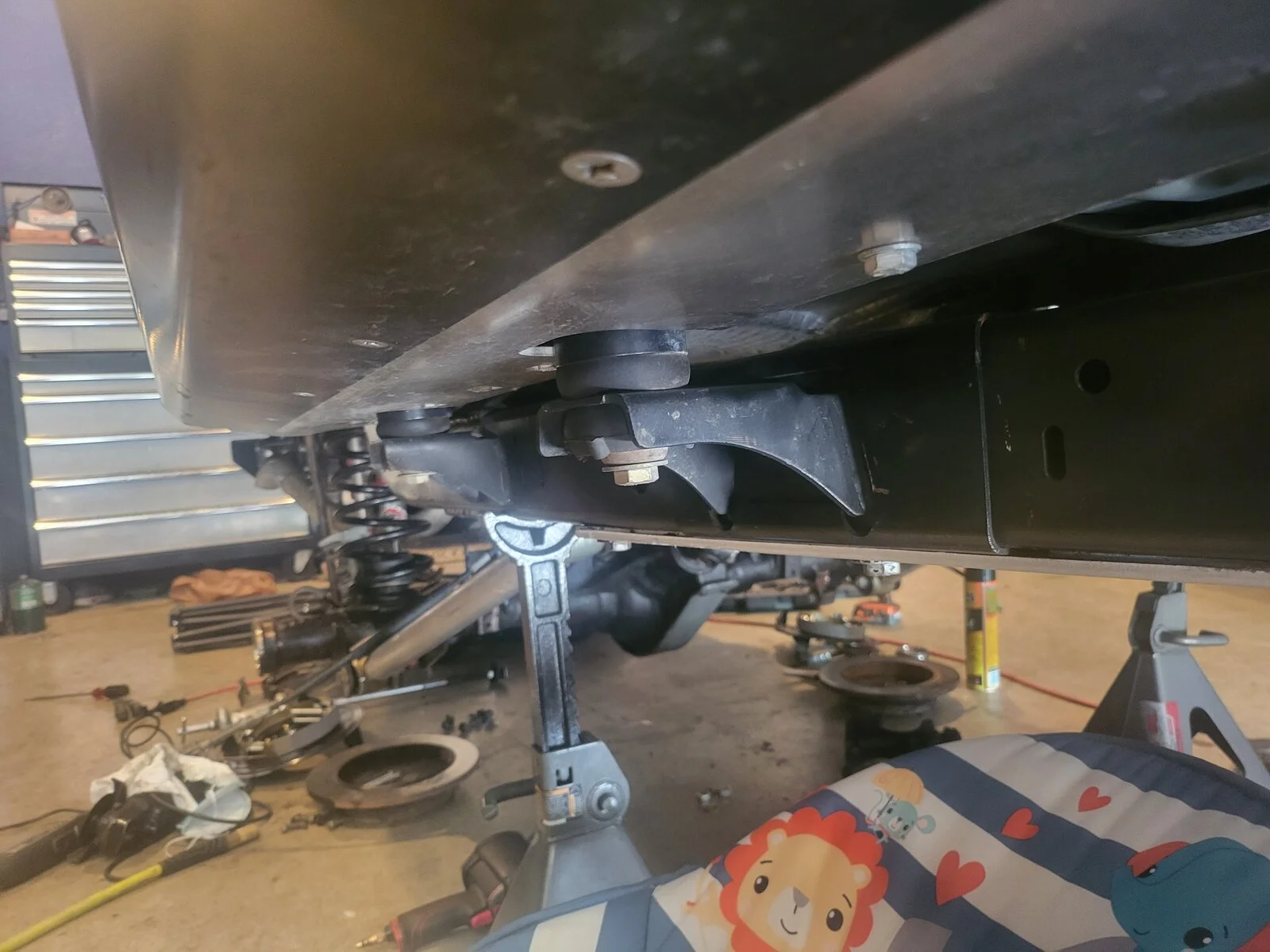

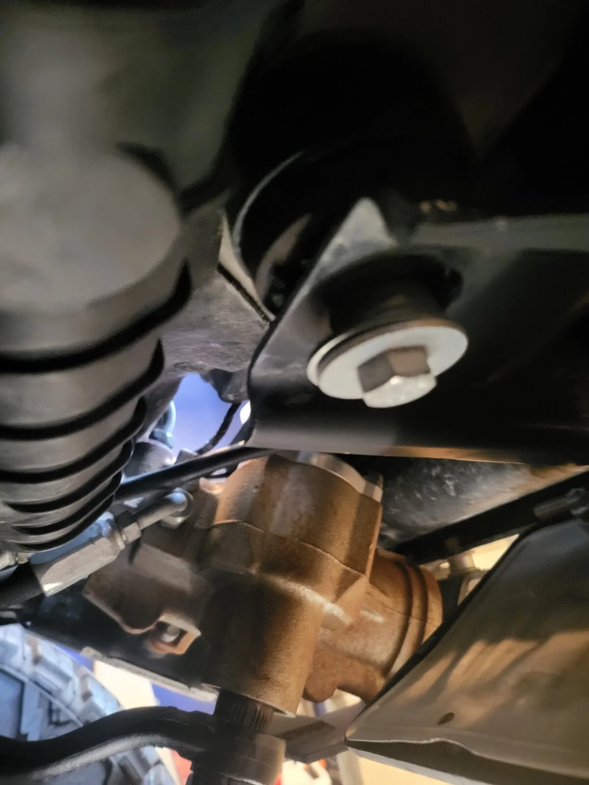

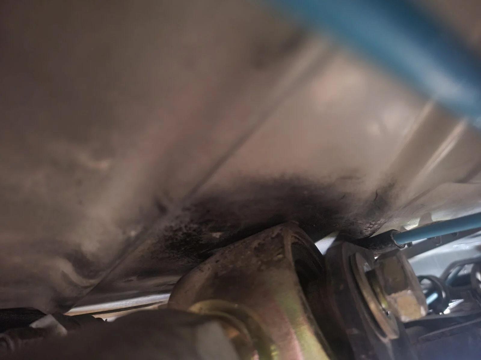

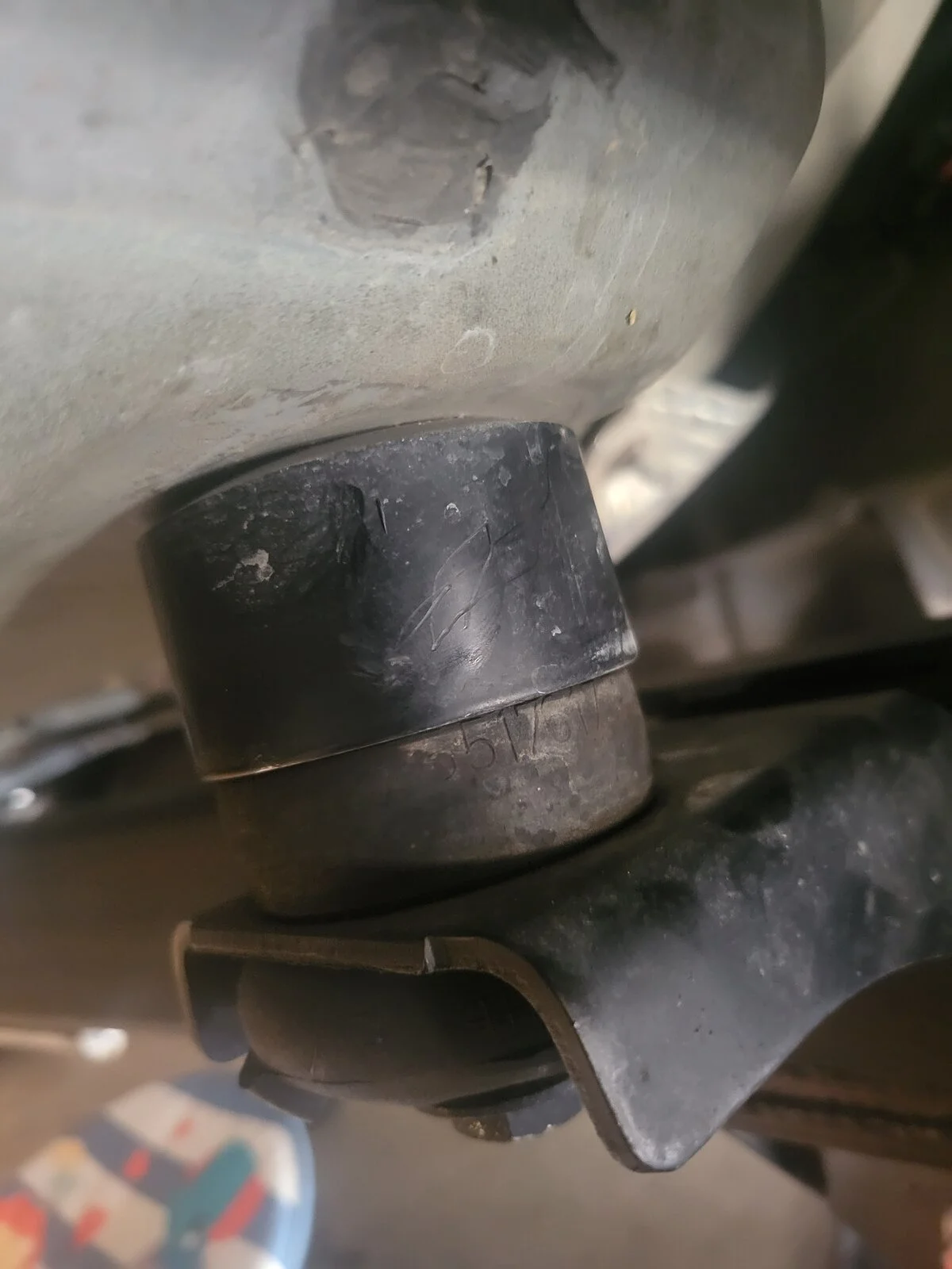

So today I got under and took some pics of the body mount brackets, mounts, and body lift pucks. They are definitely some kind of plastic, not aluminum. I am unsure of the brand. The front one appears to be missing the bottom piece of rubber bushing..

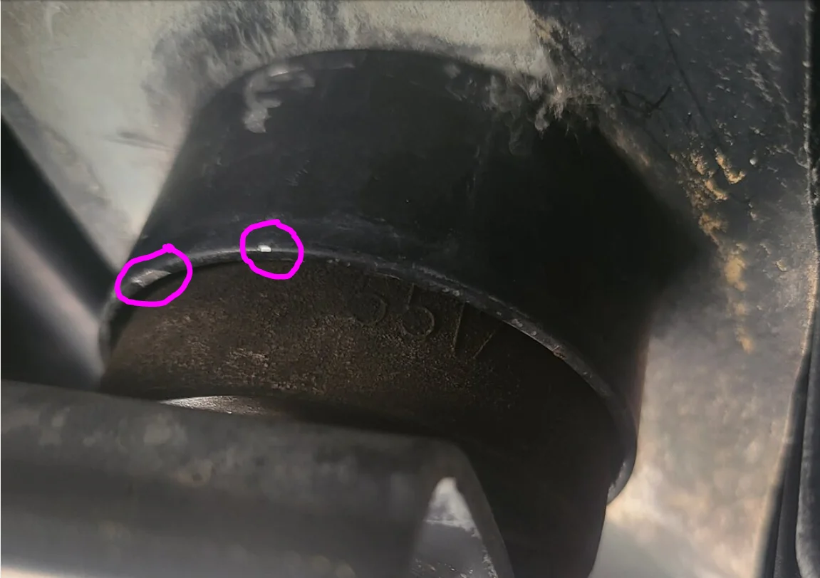

I'm not sure what you have going on but a few things stick out to me. This one looks like it shows a powder coated aluminum puck due to the chipped edge and the lack of rust where the coating chipped away. That points in the general direction of a Currie 1" body lift.

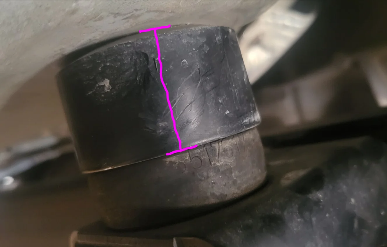

If you are measuring the distance indicated below as 1.25" then it is most certainly a 1" body lift since there is a skirt around the bottom of the lift puck that drops over the top part of the OEM body mount that is at least 1/4" deep.
Blaine I think you might have nailed it man. On that 2nd picture the line you drew measures 1.25" so it's gotta be a 1" body mount. So what 1.25 kit do you recommend me to buy right now it doesn't look like the savvy's in stock. And does anyone have a picture of what the front body bushing should look like I think mine is missing a piece and I'm wondering if I can buy that individually or if I have to buy a whole new kit with all new oem bushings and just put those in with the new 1.25 pucks?

Yeah, looks like you don't have 1.25" BL. That quarter inch matters a whole lot. You fully need the space for the uppers to clear the tub. Looks like you have some self-clearance happening.
610cc9bb7f88dca4bdb58aa5ae0fb23c-jpg.203916
Thanks for the picture it's very much appreciated. Looks like you have about a 1/4 more clearance so it's got to be they installed the wrong lift pucks. Are your control arms aluminum or steel?
