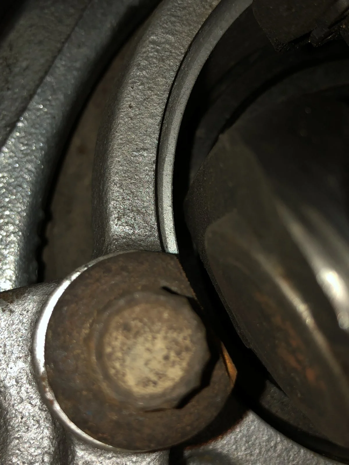

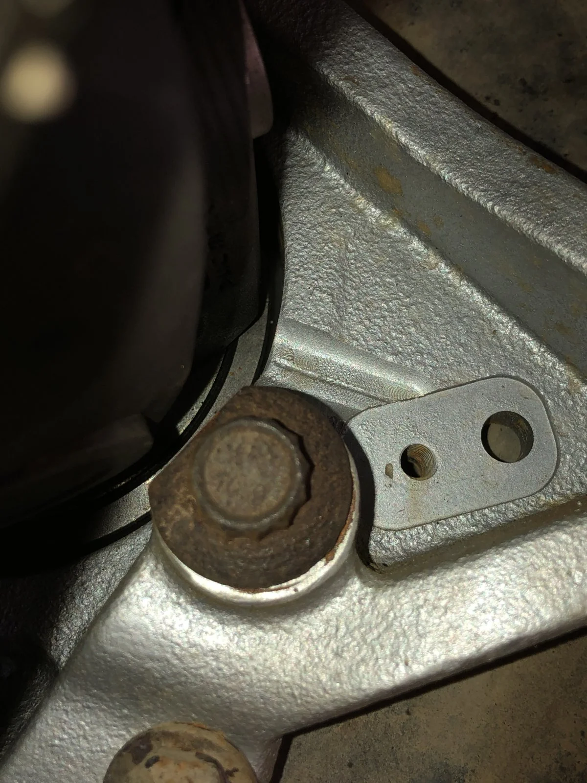

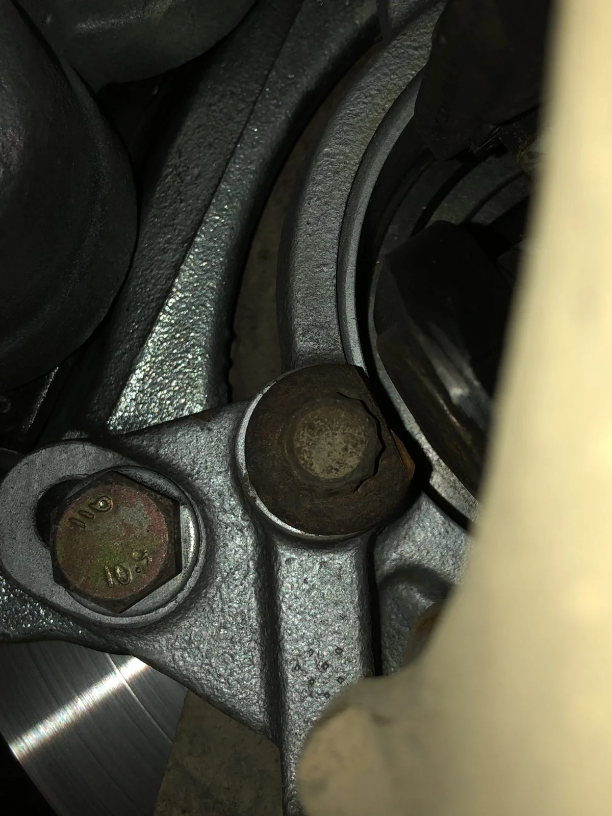

2) I also had revolution 1350 shafts installed along with my 15" BMB. I noticed today that the hardware on the BMB looks a little too machined. I've attached photos below. @mrblaine, is this ok or normal? I'm honestly not sure. It seems like a piece of the bolt has been machined down by the axle shaft.

The flange bolt is fine. You can pull them and grind them down to the same diameter, (the flange) all the way around or buy the ones from ARP that are already done. I've done it both ways.
Did you not grind the unit bearing flange bolts down, they self clearanced?!
I did not install it. I ordered unit bearings from Blaine, so those are good. I'm not sure if my shop took the bolts down or if the 1350 u-joint did.
If the axle shafts did, you'd have heard more than a "haooomp haooomp haooomp". There also looks to be extra clearance between the shafts and the flange. If the shaft doesn't wobble around in there (reach in and give it some good yanks) I'm going to assume that the shop you took it to used a grinder on those bolt flanges, which is perfectly alright.
That was my initial thought as well. I don't know much about brakes so I thought I'd make sure. I'll wiggle around the axle shaft next time I'm near the Jeep.

Doesn't look like the shaft ears hit the flanges; I'm going to say that those were ground down.
Agreed. Now that I look at it more closely, the shaft is not even close to hitting the flanges. Definitely taken down intentionally.
