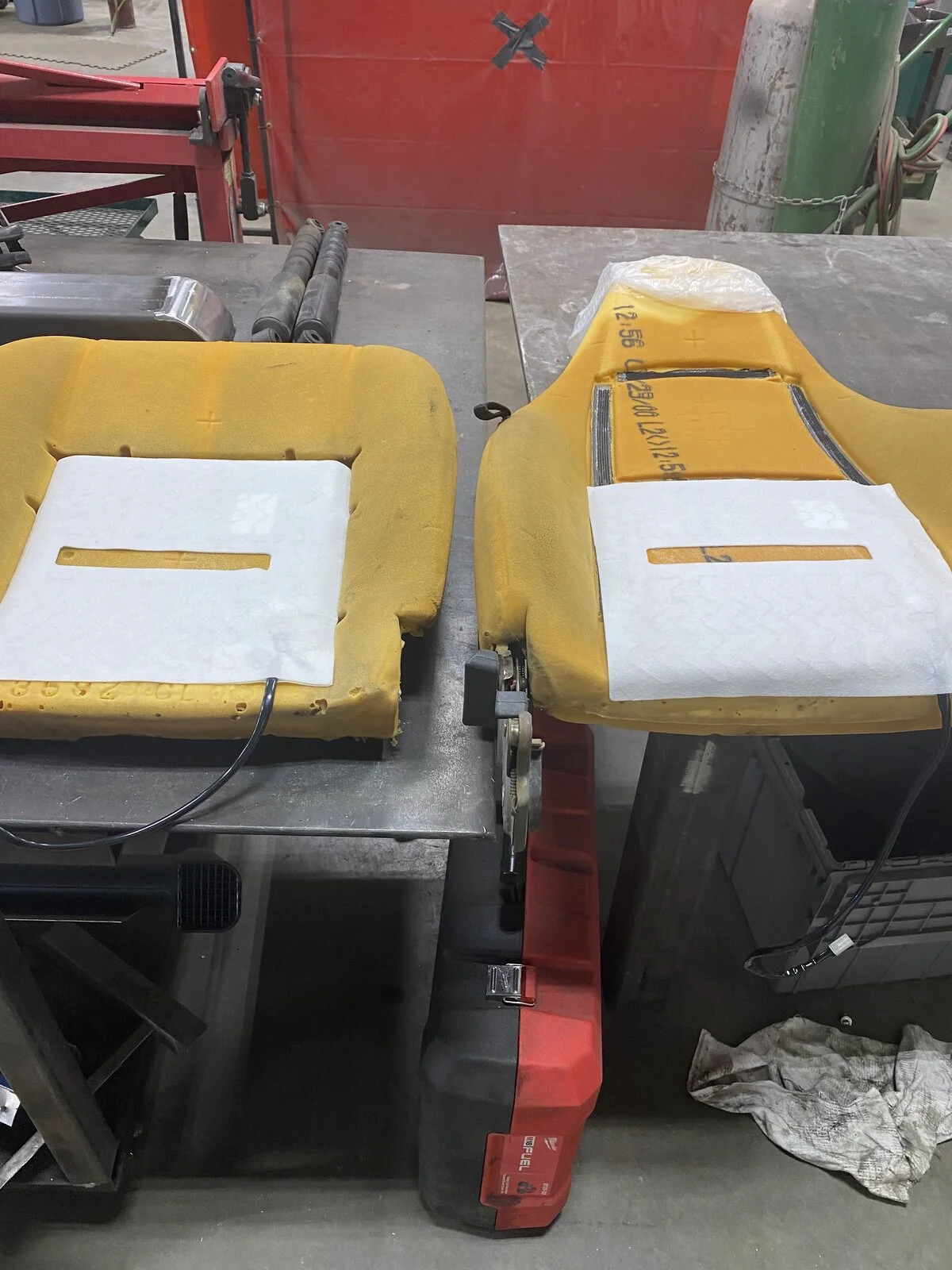

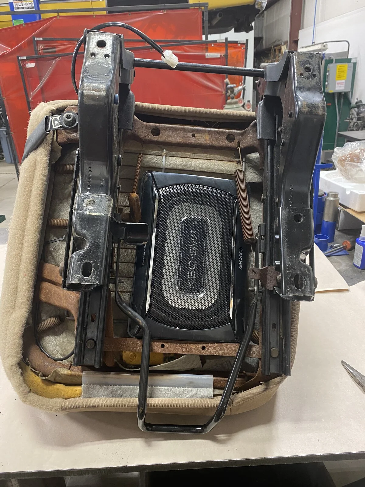

I actually did install heated seats when I fixed my driver side seat cushion. It’s really nice for the mornings when it’s -12 like we’ve been having lately. I also installed a powered subwoofer under the passenger seat while I had everything apart.
I never thought about attaching it to the bottom of the seat itself. How is that working out for you (besides the wife always fighting you to try and drive while listening to rap music 😂)? How did you attach it?

I actually did install heated seats when I fixed my driver side seat cushion. It’s really nice for the mornings when it’s -12 like we’ve been having lately. I also installed a powered subwoofer under the passenger seat while I had everything apart.View attachment 304390View attachment 304391View attachment 304392
Lol it was the easiest solution I could come up with and not have it in the way of anything. It fits in there really nice and snug and the cushion doesn’t seem to crush it whatsoever. I actually attached it with safety wire to the metal spring on the seat bottom. That way it moves with the seat base instead of being sat on. The funny thing is I really don’t even listen to music that often in the jeep. It’s mostly talk radio🤷🏿‍♂️
Oh and I actually mounted it under the passenger seat. The vibes would have drove me nuts! I get enough rattling from the jeep!
