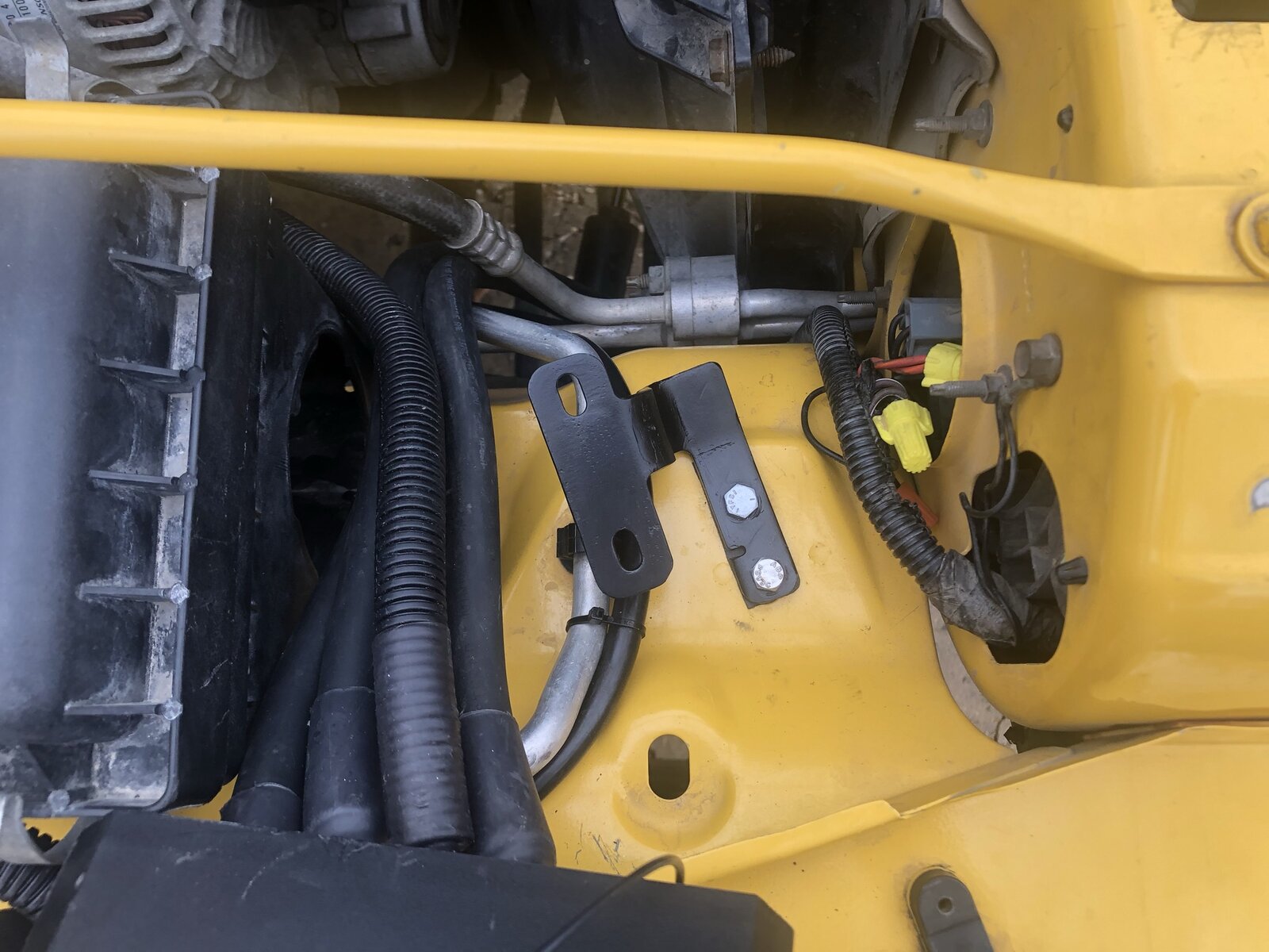

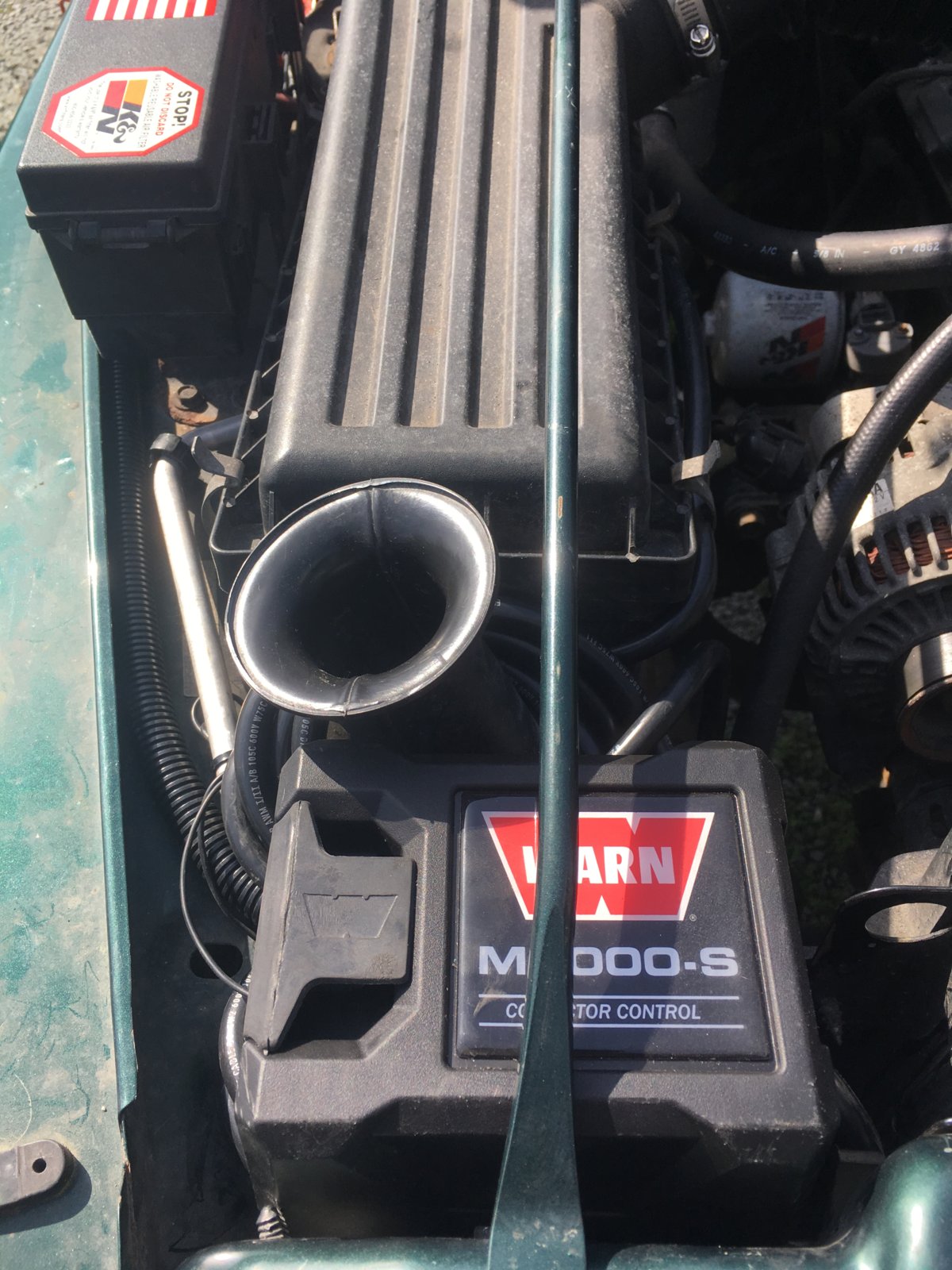

I have been working on relocating the winch control box to behind the passenger headlight. I bought 39 in. 2/0 cable from batterycablesusa.com. Seems to be good quality. Very flexible and well insulated. I could've gone a bit shorter but rather err on the side of caution. I reused the rubber boots that came with the winch, but I had to trim part of the tapered section to fit the bigger cable.
For the relocation, my original plan was to stick it right between the headlight and the intake horn like so:
This is EJD's setup. https://wranglertjforum.com/threads/winch-solenoid-relocation.5881/post-156064
I tried this, but I couldn't get the box to fit with the horn in place. Not to mention, with the controller plugged in to the box, I tried to close the hood, but the hood prop hits and won't let the hood close. So I decided to go a different direction.
Taking the horn out frees up a lot of space.

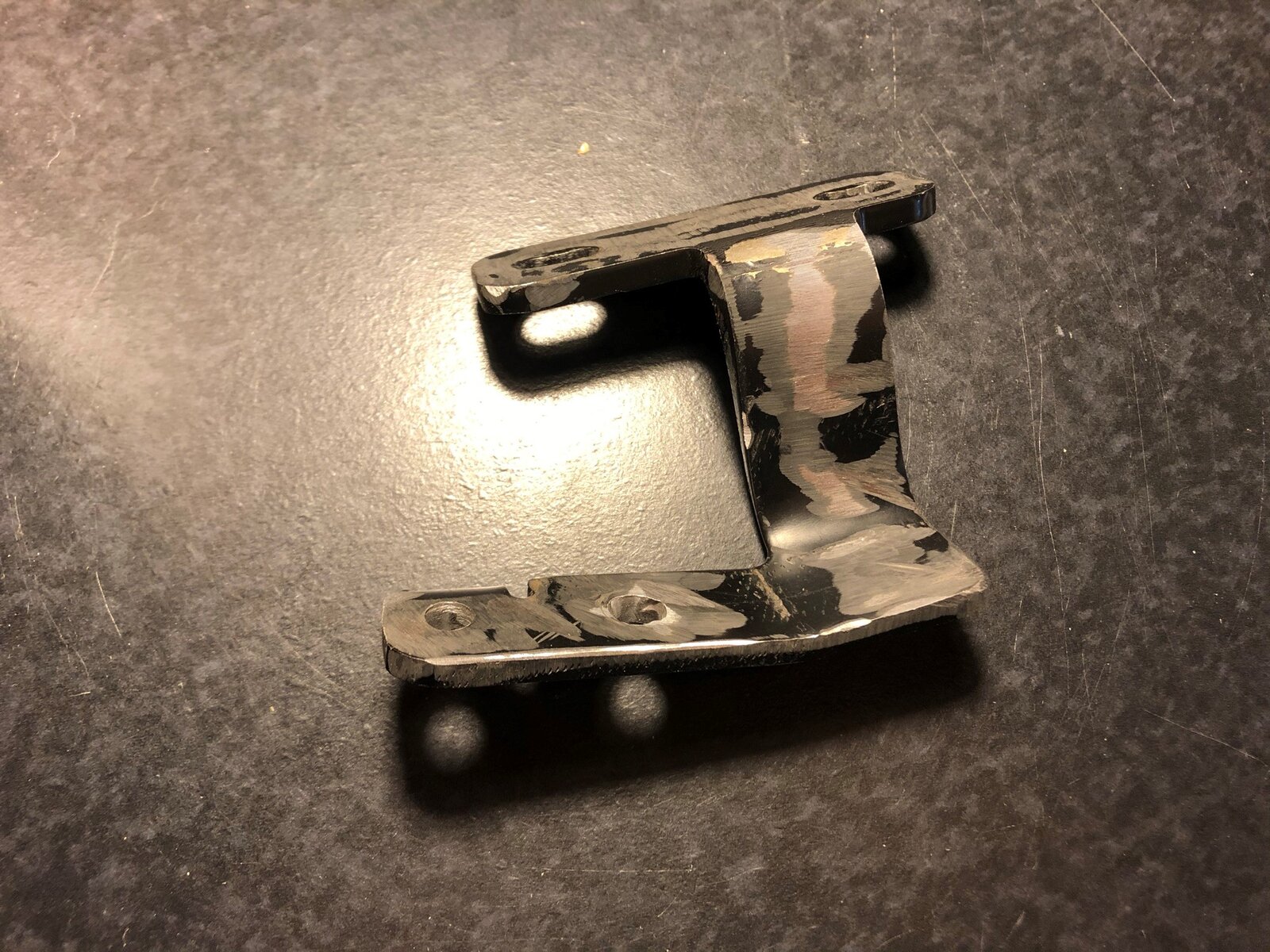

Those two existing holes caught my eye. I decided to repurpose this bracket that held the box to the winch:
After a few bends and cuts, I came up with this:
With this, the factory mounting on the box side is retained, and the angled side will bolt into those two holes in the second pic. I'm going to sand it and give it a few spray paint coats tomorrow. I'll get some pictures of the finished product tomorrow.
Among other things, I've got this waiting to go in, just need to grab a 5/8" bit.
Thinking hard about getting my tummy tuck stuff together. I might start ordering Savvy control arms, center skid, rear track bar + angled bracket, and DC driveshaft... just empty every pocket.
TJ Fest seems to be looming closer and closer, and I really don't wanna take the shovel to Moab.
Reactions: Nickgsjeep and JMT

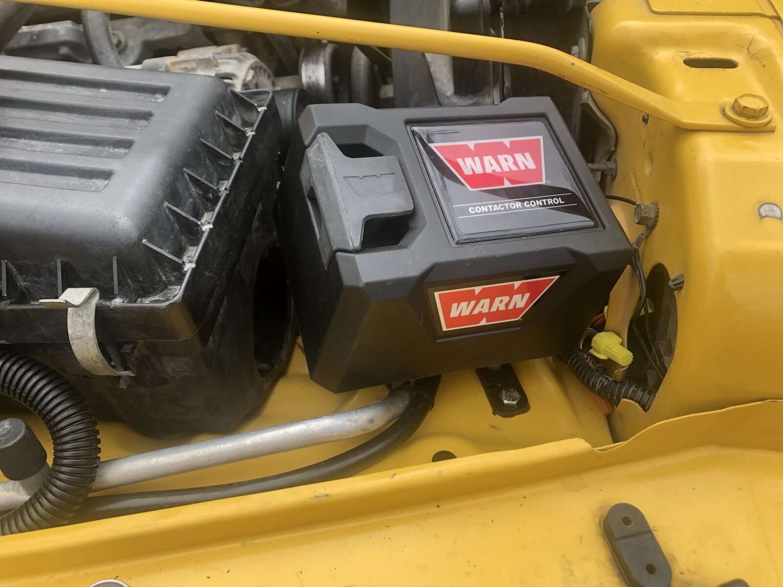

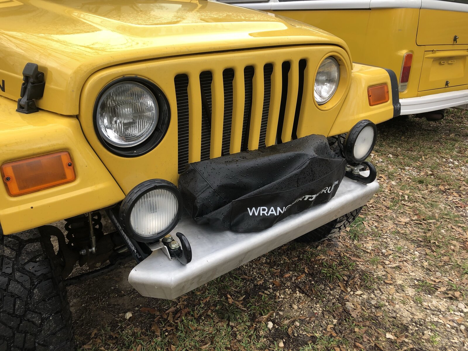

Finished the control box relocation today. Here's the bracket painted and bolted in place:
After a quick test fit, it was contacting the airbox hard, so I bent it a little more forward. I connected the motor ground to the conveniently nearby headlight ground. Here's the end result:
I'm happy with it. I can still get to the headlight plug if I need to and the wired controller can plug in with plenty of clearance from the closed hood.
Not to mention, I really, really like the look of the front end now without the box. Much cleaner. Time to finally get that winch cover ordered.

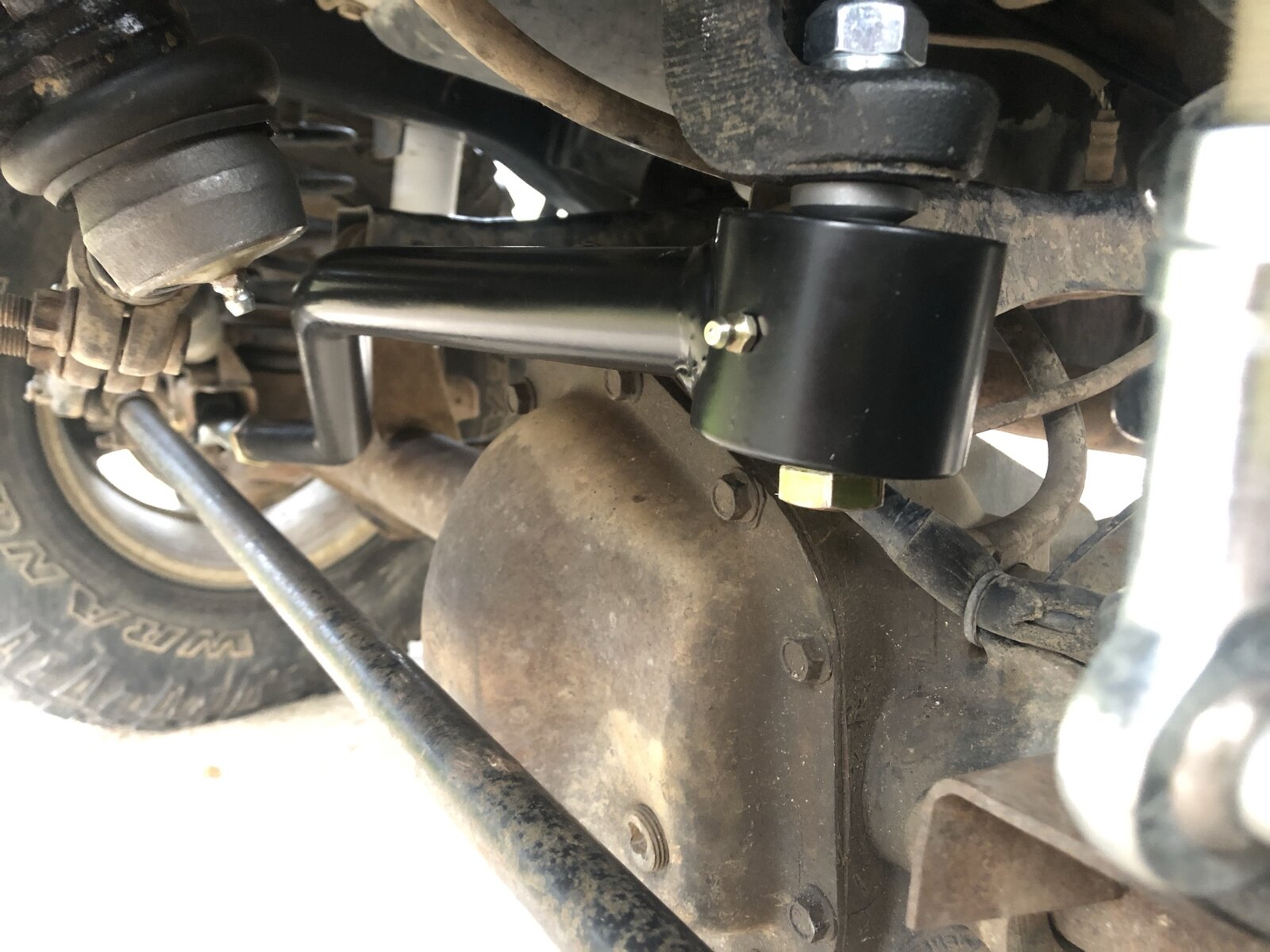

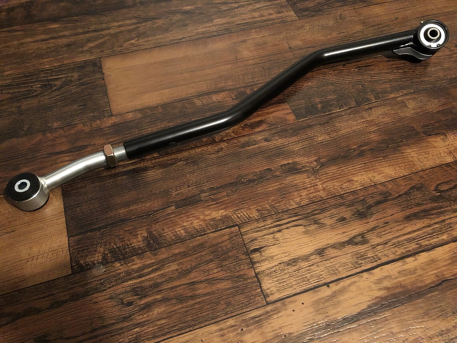

The track bar went in today.

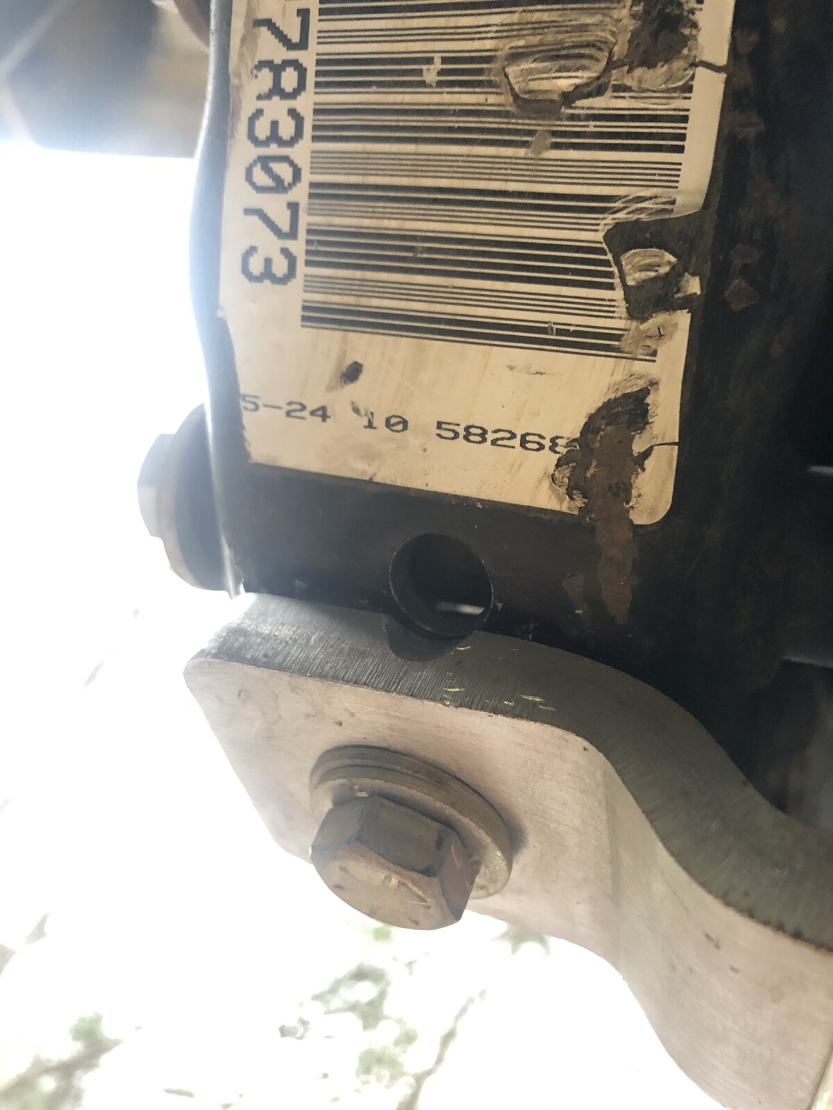

And while I had the drill out, I drilled a much needed drain hole for the bracket that the Savvy steering box protector sealed up. I went with a 7/16" on the back side, as close as I could get to the bottom of the bracket. It drained well, but I'll be keeping an eye on it to make sure it stops crud buildup.

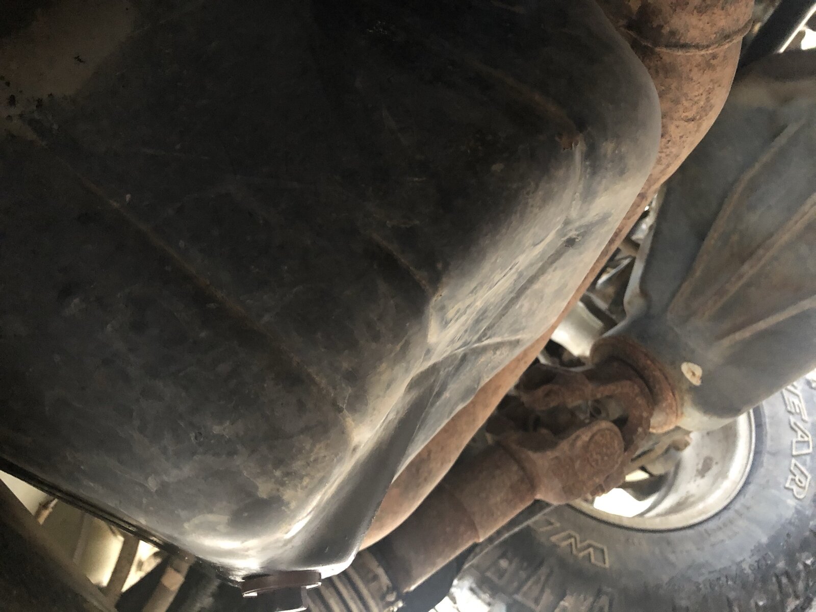

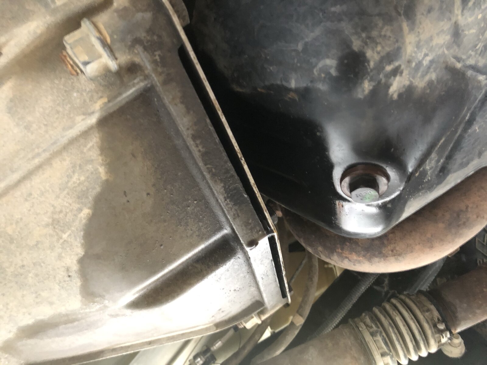

I got a little too careless in the rocks during my Thanksgiving wheeling trip to Arkansas and put a good dent in the oil pan... 7 hours from home :eek:. Close call. I wouldn't care much except that it seems to have started a pretty bad leak. So it looks like I'll be tackling an oil pan and rear main seal replacement pretty soon. It's hard to see in the picture, but it looks worse in person.

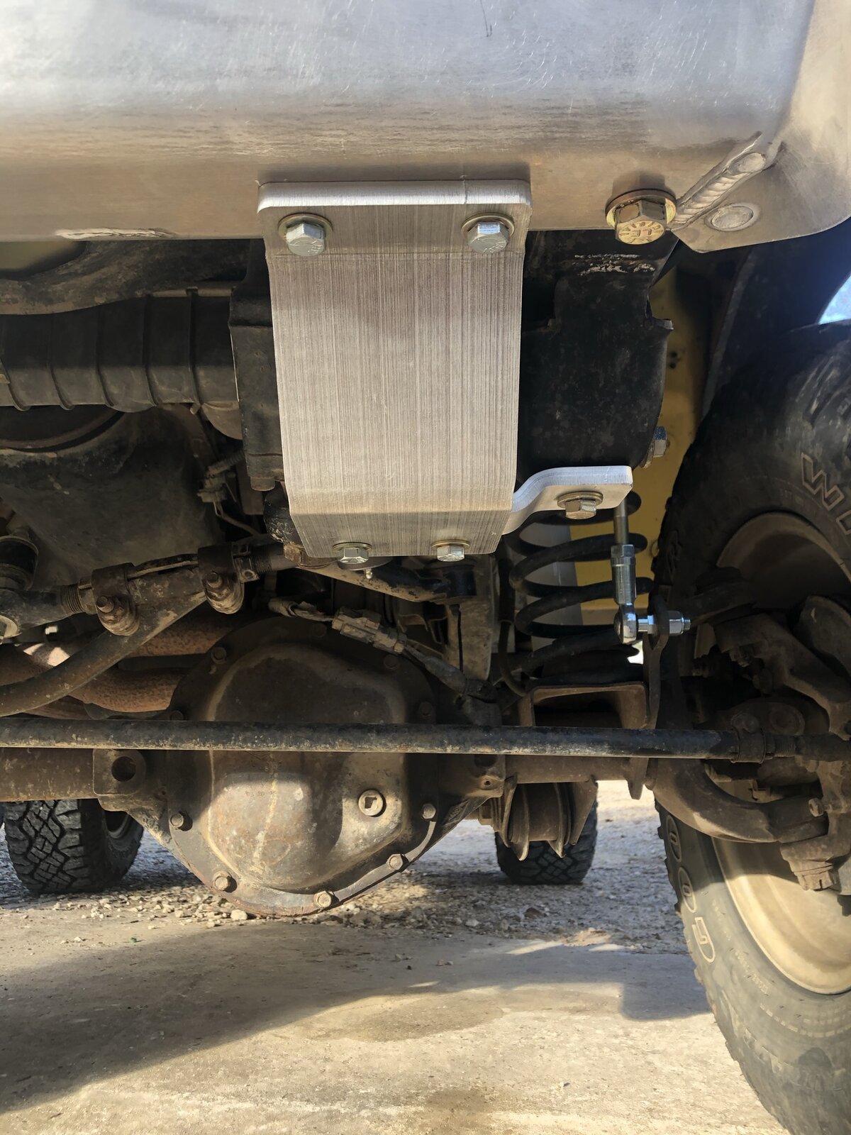

I went ahead and ordered Savvy double adjustable control arms, under armor, and gas tank skid from rwkhaussupply.com. Called in and got it for ~$100 cheaper than it would have been from Savvy with the 8% off code. Sadly, the under armor is on backorder, estimated 8 weeks, and nothing ships till it's all on hand. I still need to order a rear track bar with angled bracket and a DC driveshaft. Tummy tucks aren't cheap!

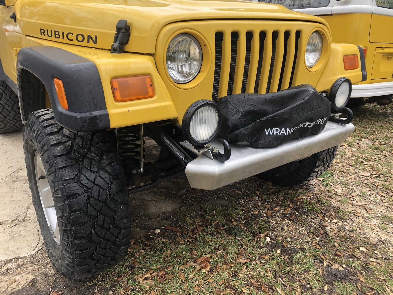

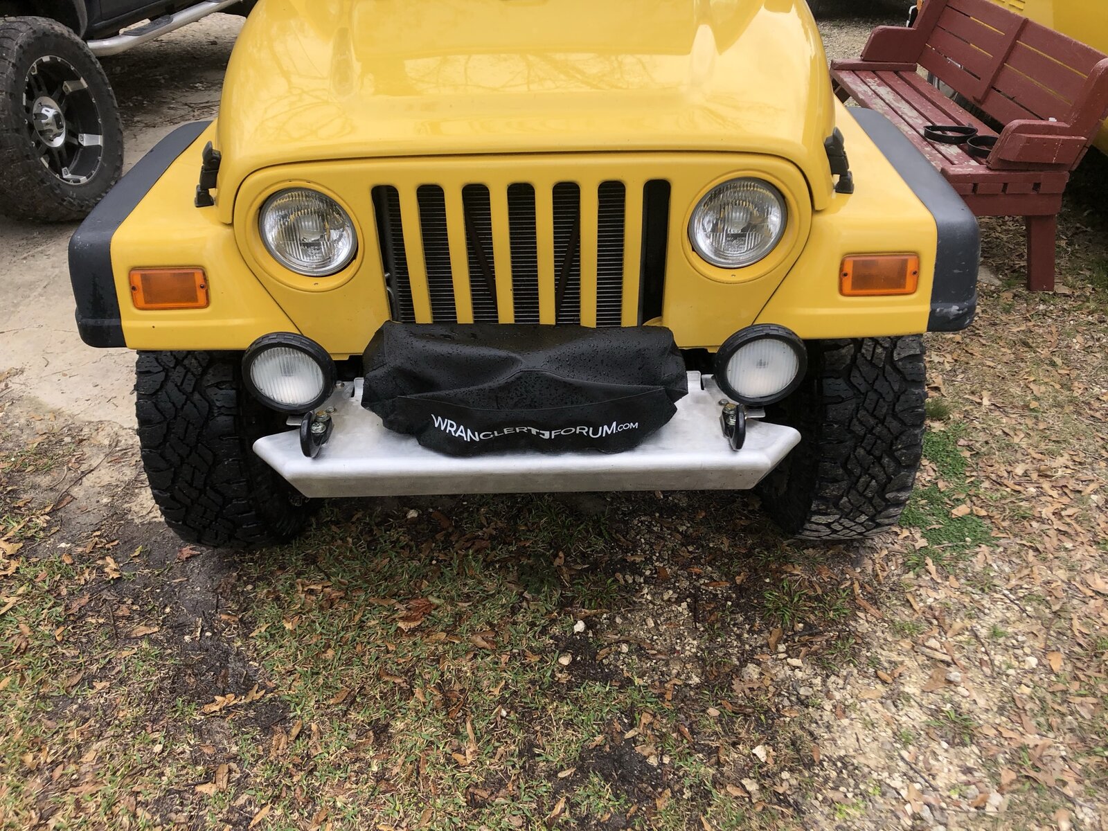

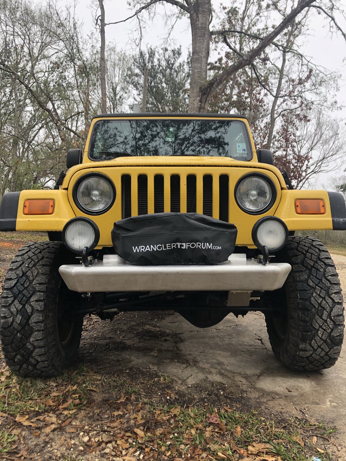

The winch cover that I ordered from coversandall.com came in today. Big thanks to @Chris for sending me a forum logo to print on the cover! The fit is a lil wonky because of the safety thimble and fairlead, but all in all I like it! Seems to be high quality... time will tell.
