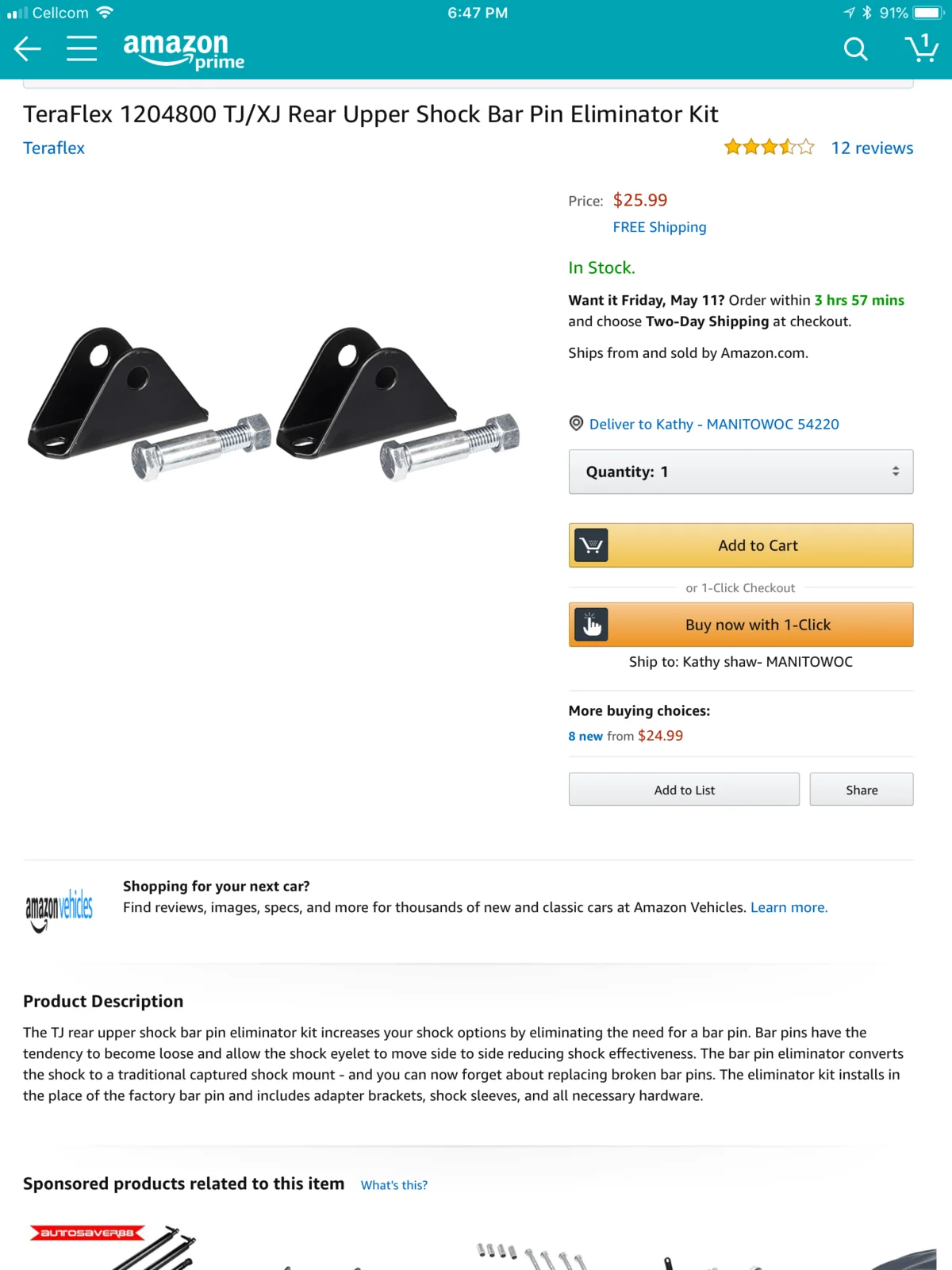

Has anyone used this adapter/pin eliminator when replacing the rear shocks?
Fonz
Rough Country - 1089 - Rear Shock Upper Bar Pin Eliminator Kit for Jeep
Bar pin eliminators aren't necessary and they just take space away from the shock space making the shock effectively longer, making it more apt to bottom out when the suspension is fully compressed. In my opinion, BPEs are a cure for a non-existent problem. In 22 years of TJ'ing, I've seen just one broken OE bar pin which was the result of the owner having purchased too long of shock.
Fonz
I installed the Terraflex rear upper shock bar eliminator due to one of my parts breaking. Chris recommended these and they have worked out well for me.

I would think that if the bar pin is breaking, then the bump stops are not correctly extended. A BPE will only make that problem worse.
Reactions: Jerry Bransford
Thanks Jerry - I assume that if you are able to get the bolts out, replace the shocks and you apply anti-seize tif you o the bolts when you reinstall then all should be good in the shock universe. However, bust a bolt trying to remove the shocks is there a better solution than what is presently being offered aftermarket?
Thanks
Fonz
BPEs aren't what are used when a bolt breaks at the top of the rear shocks, that's a whole different problem that is much more difficult to solve.
Reactions: Fonz54
Thanks for the clarification. Have you had to remedy the broken bolt situation and if you did can you share how you did it?
I have been fortunate on not having had to deal with that situation with my shocks. Likely because I don't live in the salt belt where corroded/seized nuts & bolts are more common. I'd probably slit my throat if I snapped one of those particular bolts off while trying to remove it. :eek::D
Reactions: Fonz54
Thanks Jerry - I am North of you, Monterey County near the old Fort Ord. Jeep came from Colorado originally. Not allot of rust on her. I am going to start spraying with Kroil and hopefully things will get nice an loose.
