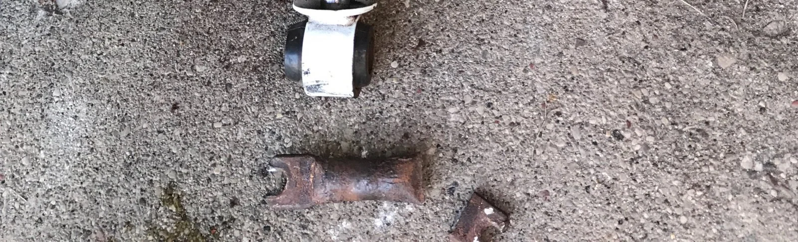

I think everyone who used BPE's did so because they didn't want to deal with a siezed / broken bolt in the future.
Using a BPE doesn't have a thing to do with helping or eliminating that possibility. Bolts can seize just as easily whether they pass through a BPE or a bar pin.
Most of the issue is breaking the bolts that hold the bar pin to the frame.
With the BPE, you won't have to mess with those bolts anymore. I could cut a bolt that passes through a BPE easier than the ones in the frame / cross member.
Our criticism of BPEs is that they can often reduce suspension travel. This is almost guaranteed in the rear and very likely up front. If your bump stops are extended for something other than the collapsed shock, then a BPE won't be a problem. In fact, in that situation they will increase down travel on a shock that is arguably too short.
I seriously doubt most BPEs are installed to get around the potential corrosion/seizing issue since that is not the purpose of them and what they are sold for.

Here is why I got bpe’s. At the time it seemed like the quickest and easiest solution. I currently don’t do much off roading so it works for my road driving until I figure out what I’m doing with my jeep.
