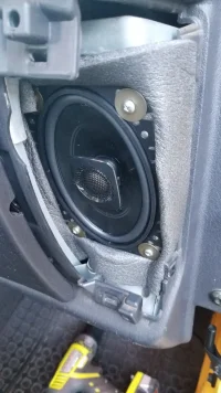

How did you contain the polyfil in the front? It looks like you could fit an entire pillow up in there. I was worried it would travel around in the dash and start a fire if not contained somehow. I do have the foam inserts.
I put the pollyfill in the foam baffles. I didn't trim the baffles, so the excess helps separate the rear from the front some 20200119_171006.webp more.

I have a set of those. Just off of Amazon. So if I use those I don't need polyfill in the front?
You can just use those, listen, then add a little polyfill, don't pack it in there, loosely fill it, and then listen. See which way your ears prefer. Honestly, adding some inline tweeters into the a-pillars for $20 would be a nice upgrade as well.
