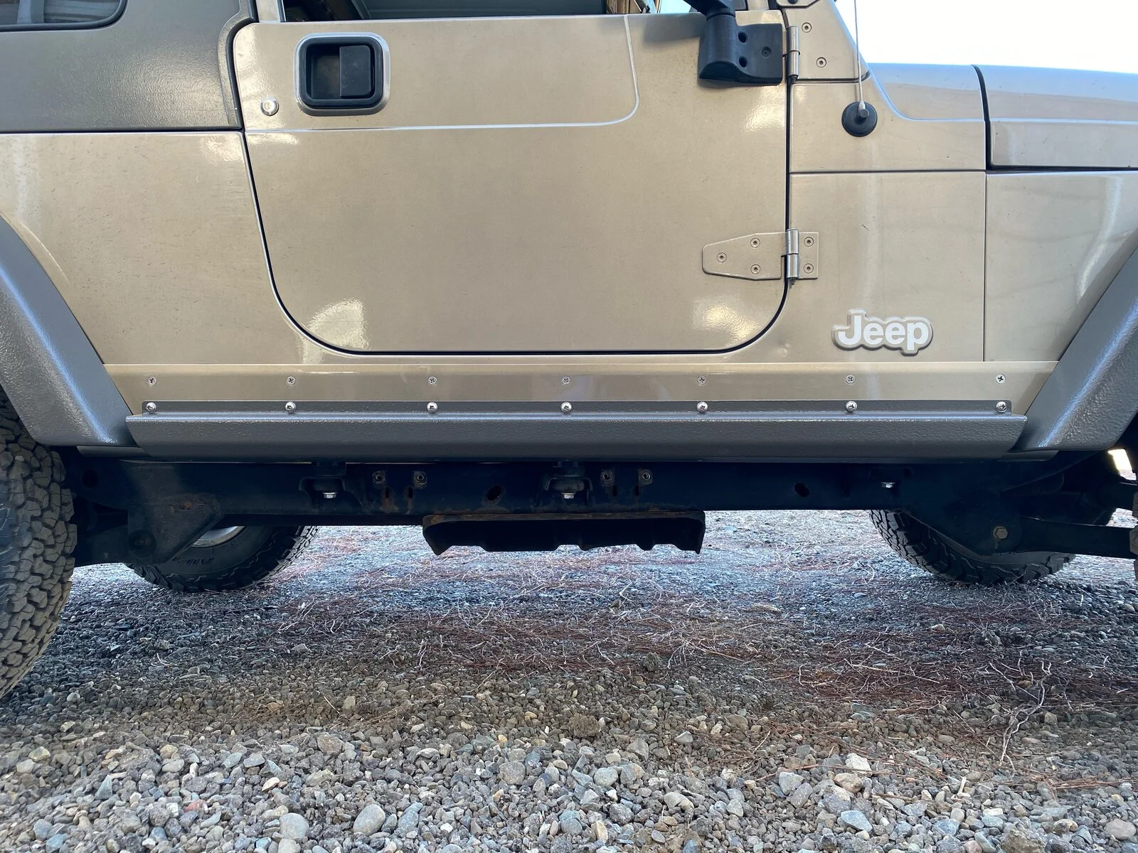

It looks like you didn’t preload it during installation… should not be a gap like that along the tub.
It's a magnified view. A sheet of paper won't go in there.
Guess I should have kept my mouth shut. It looks fine to me, having nothing to compare to in person.

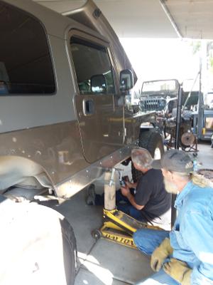

Yes we had the jeep off the floor and backers clamped. Maybe I buffed the edge too much.

Anyone filling the very small space between aluminum backer and tub?
I wouldn't bother. Better to make sure any bare metal (on the tub and slider) is coated prior to final installation. One can always remove the slider and backer periodically to inspect and/or clean if deemed necessary.

Backer to tub.
Forget about it.. everyone has their critical eye ball on.
Original question stands.
