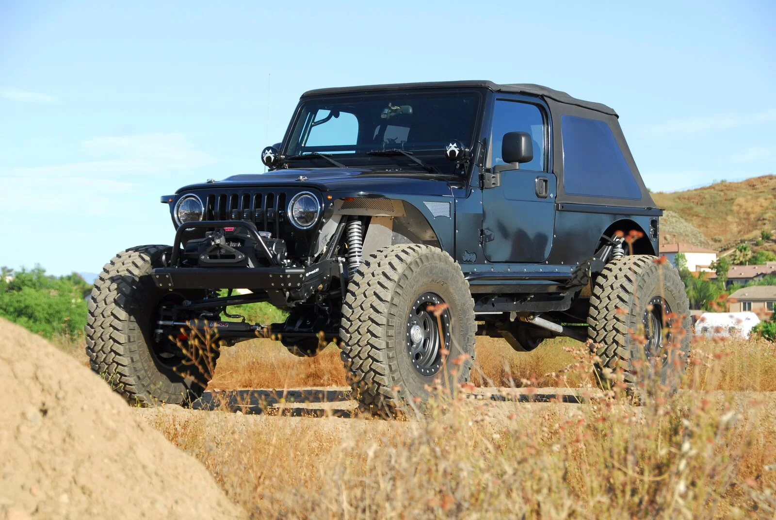

If you have any other fender flares or fenders that you wanna show off, I would love to see them as well! - I'm currently in the process of swapping them out though for Genright 4 inch fenders because I prefer the lines of the GR/the GR replacements are aluminum.
GR
That does look really good.
.... I can’t use all that clearance anyway with 35’s. My tires will hit the back when turning before I can get enough up travel. I can’t move my axle forward or I have diff/track at issues.

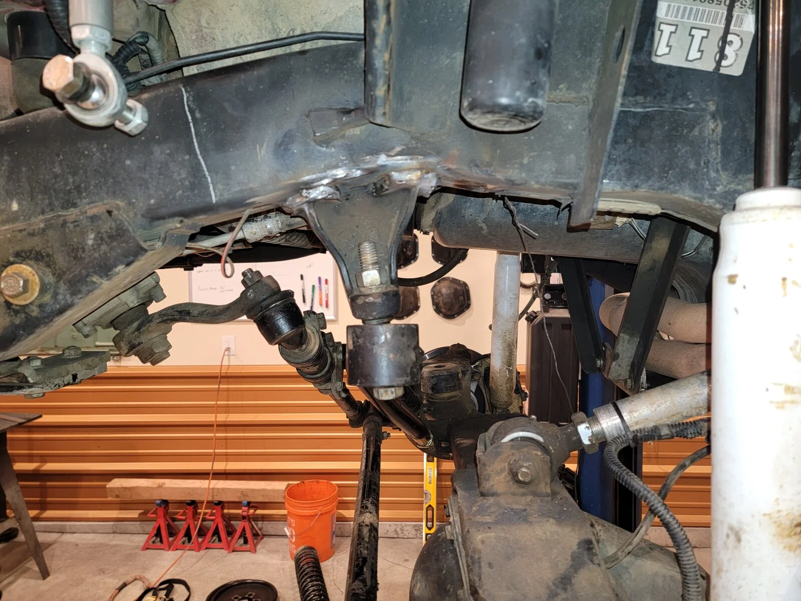

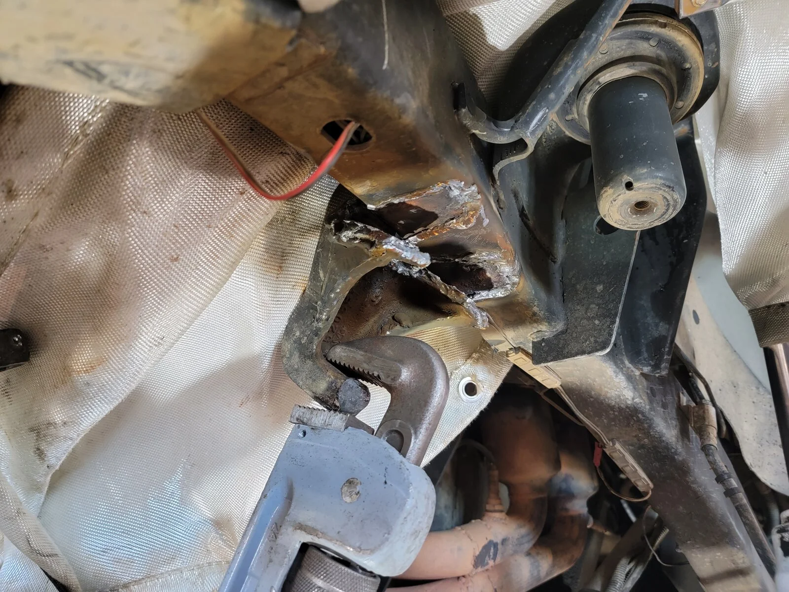

You can gain about 3/4" by bending the track bar around the diff cover with a shop press. The drag link needs more bend, as well. Then there is another ~3/4" if you move the frame side track bar forward on the frame along with more bending.

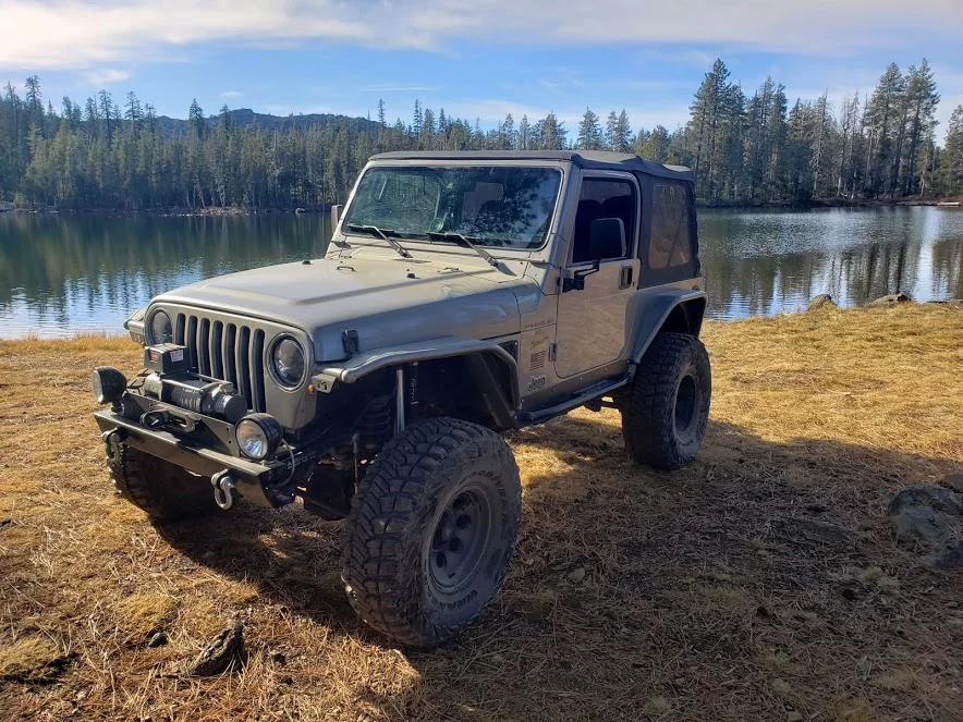

Tire Size: 35
Lift (if any lift is had): Currently 3.5” SL and 1.25” BL. Originally ran them with zero lift.
What Fender You Went With: Overline 4”
Your thoughts/experience with them: no complaints, like that I can remove them when modifying/maintaining the Jeep
Definitely not for the faint of heart. It's impressive work.

Yes I did bend my MC track bar. I can get down below a 2” bump. But need longer shocks and new upper mount to fit the shocks. I don’t plan to address that until it becomes an issue. I am really trying to not chase problems I dont have. Lol. More travel would be nice. But hasn’t caused issues yet. I have enough uptravel to bomb mountain logging roads without my sway bar connected. So not too concerned yet. Maybe someday.

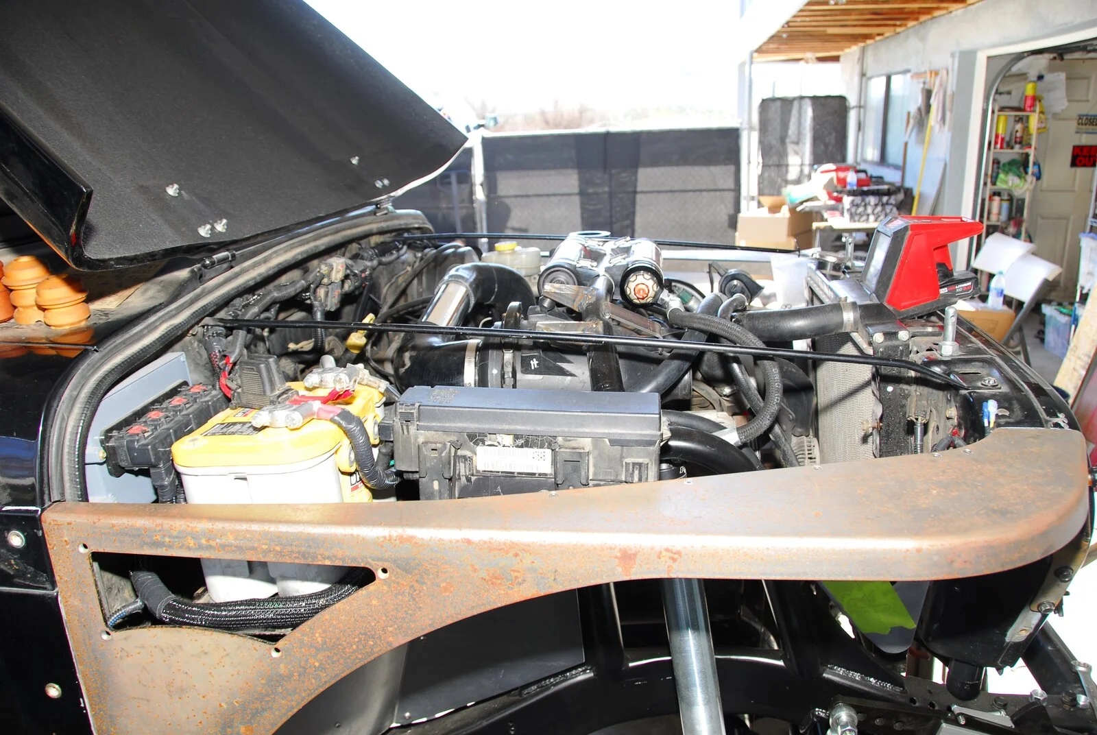

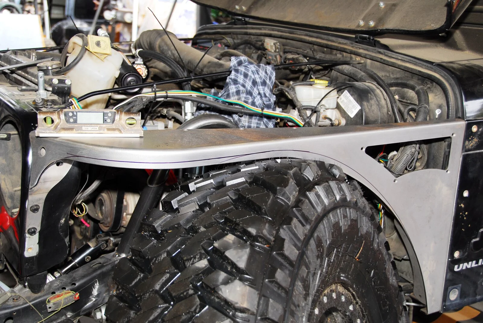

Less the inners. I would love to go flush and save all that weight, either steel or Aluminum. Plus, I just think it looks sooo much better.
I think the OP wants tire coverage though. That's my understanding. Just questions for him to consider.
The inners are maybe 3-5 lbs, very thin, very light aluminum.
