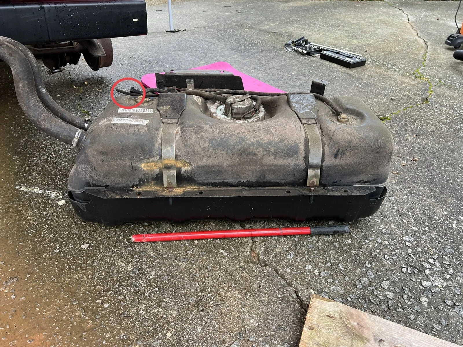

plastic tank just sits in the skid and some straps run over the top of the tank holding it down in the skid.
Pic for reference

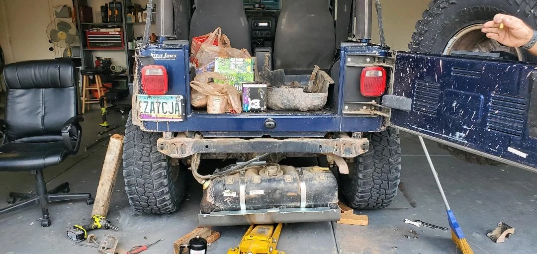

Be very careful if and when you do drop the tank. 03-04 is a unique tank and when you break a fitting off it will hurt the pocketbook.
I always take a floor jack and slowly lower it while checking for hoses and wiring that is going to catch on everything possible. The worst thing you can do is let the tank just drop to the ground
