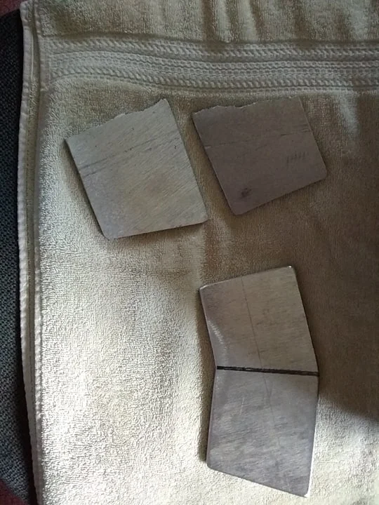

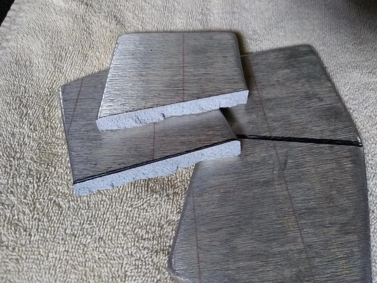

these are the 3/8" 6061 aluminum blanks i made for corner protectors on a bumper;).
notice no distortion at all from bending b4 it snapped, and believe me it was a loud pop under several tons of force and the wrong bending blade.
i've since made a nice fat round blade but need a press of about 20t to do it. and still do not know if i can make it work.
there is an art to bending 6061 aluminum. unless you know what your doing it's SNAP, CRACK or POP just like the cereal.
and this is compounded by not having enough starting material and working against the grain as well.
You were bending with the grain, not across it. Bend across it and that slows down a bunch.
yep worded that all backwards and, made an edit , good call . i got tons of chunks but nothin big enough to get the blank grained the other way.

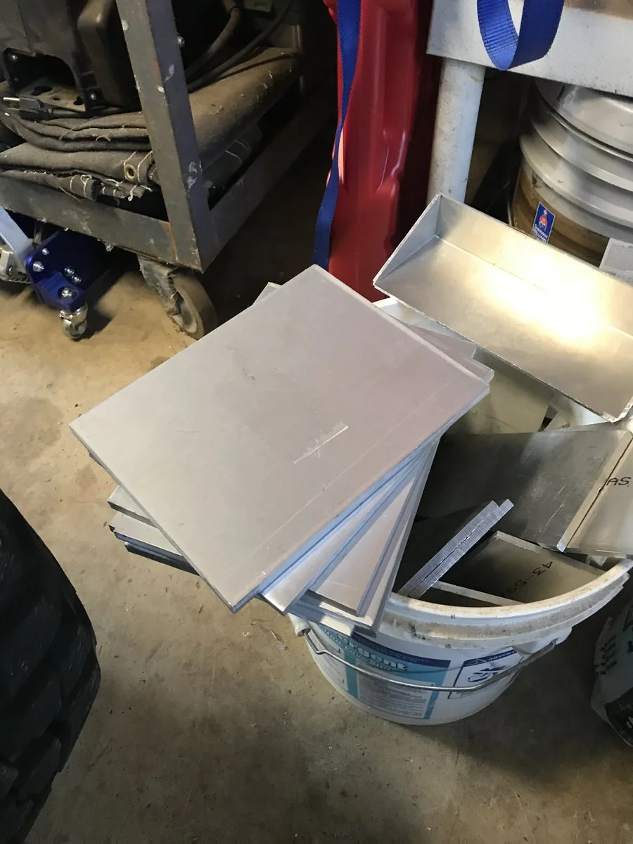

I have plenty if you would like some.
appreciate the offer, i do have a 4x4 sheet i been reluctant to start cannibalizing until i find no other use for it.
until i purchased the UA, that was the materials primary intended use.

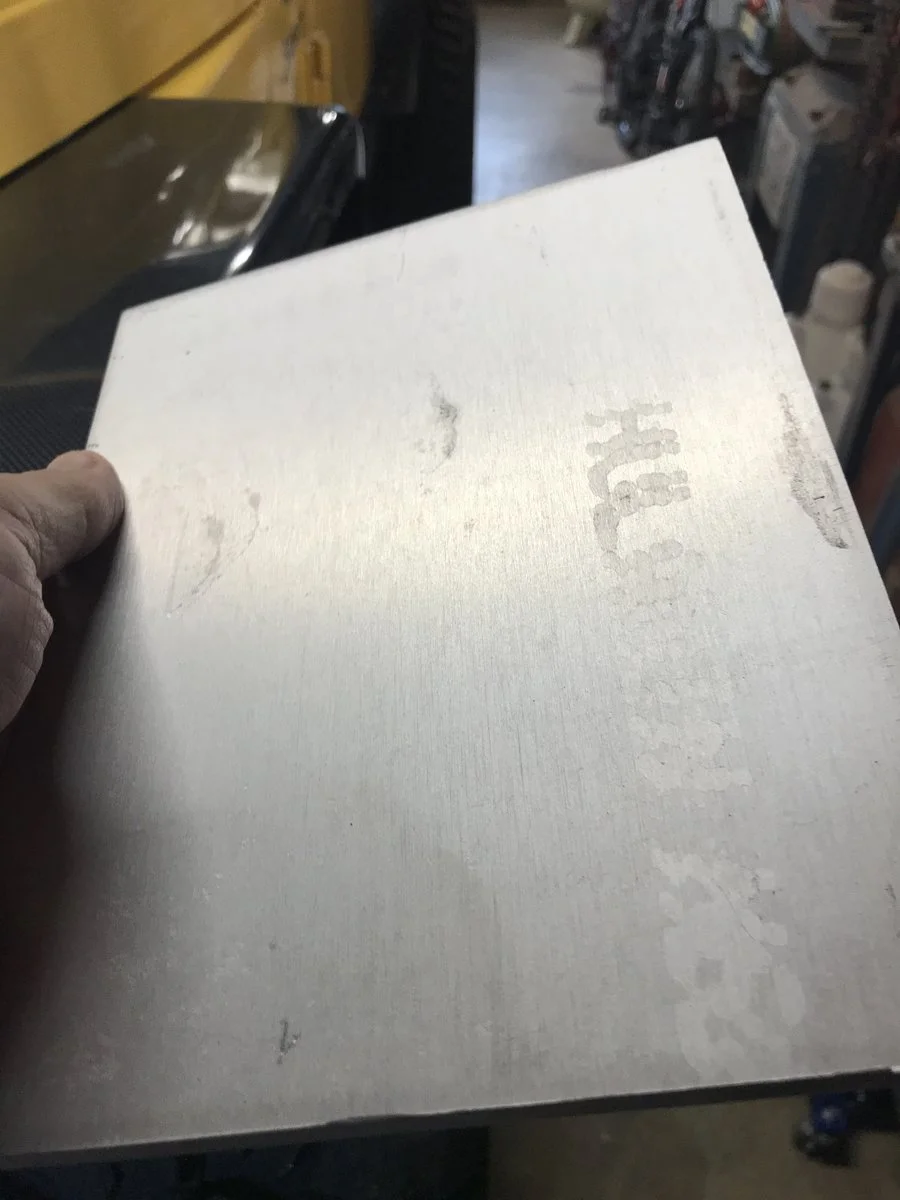

I’ve got some 3/8” x 7” x 9” 6019 plates with the grain running lengthwise if you need some.

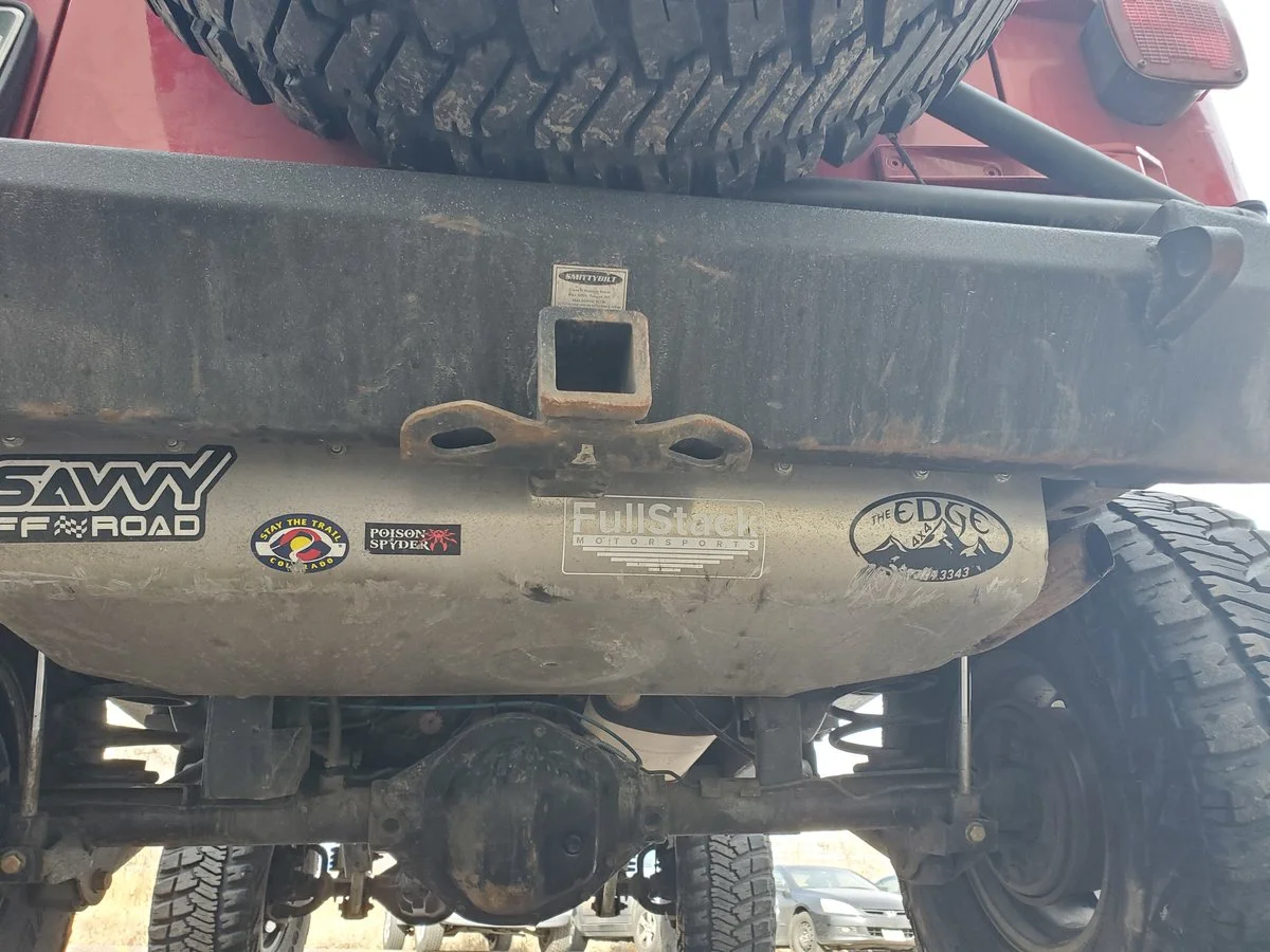

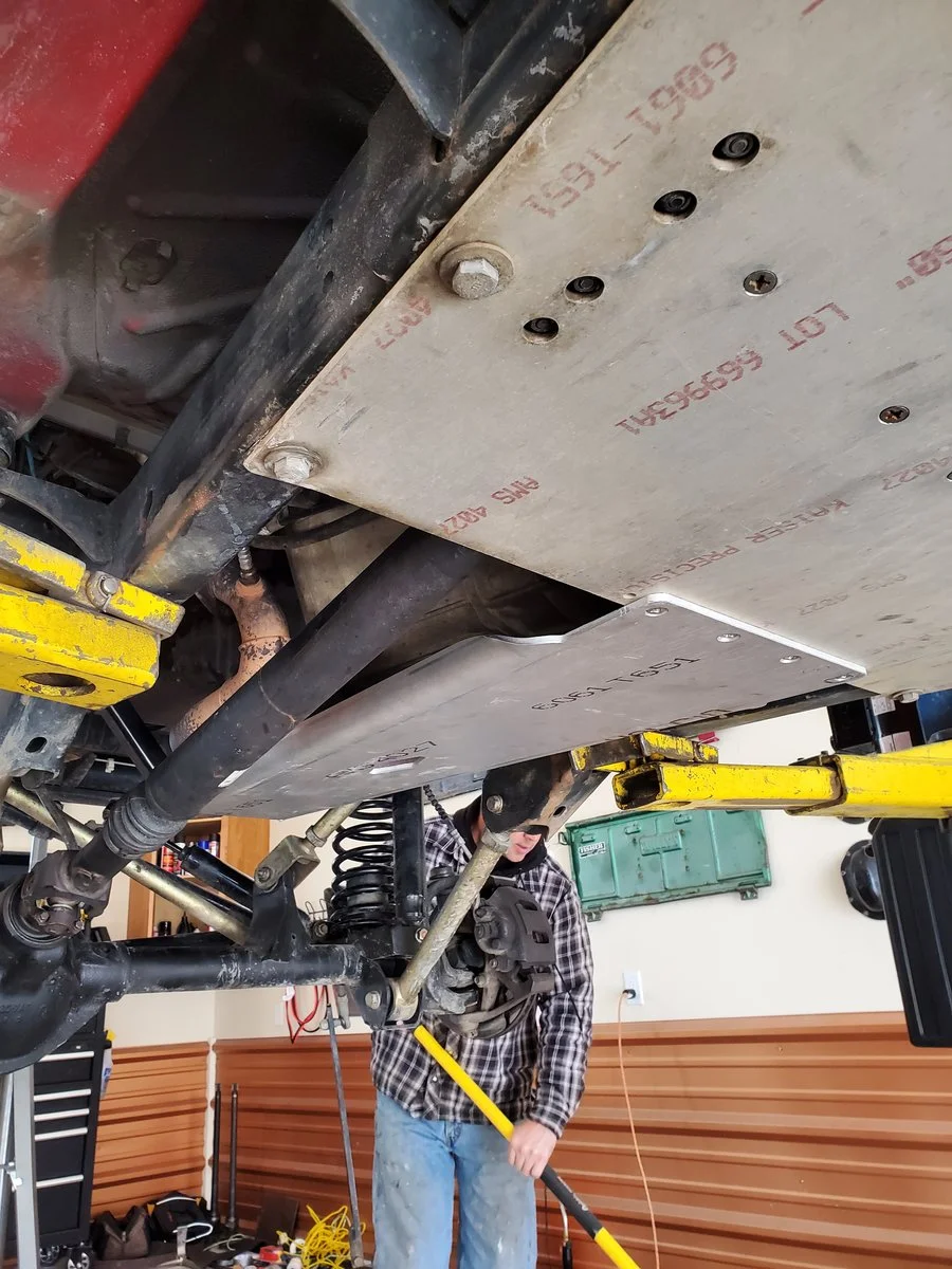

I've got savvy aluminum underneath for armor. They are holding up well in the rocks and incredibly lightweight
Having owned both, the Savvy bumper is not just a little lighter than a steel bumper of a similar size, it's dramatically lighter. I was able to lift the Savvy bumper with ease using a single finger. That's not even remotely possible with a steel bumper.
The weight savings are no joke, they are indeed dramatic.
You must have one strong finger. I know I just pulled off my Rock Hard 4x4 rear bumper w/ tire carrier and it weighted a fricking ton. Now my new Savvy rear bumper is much lighter and I CAN pick it with one hand but sure if can with one finger :) Right now it's sitting in the garage waiting for everything to come back so I can get it powder coated.
