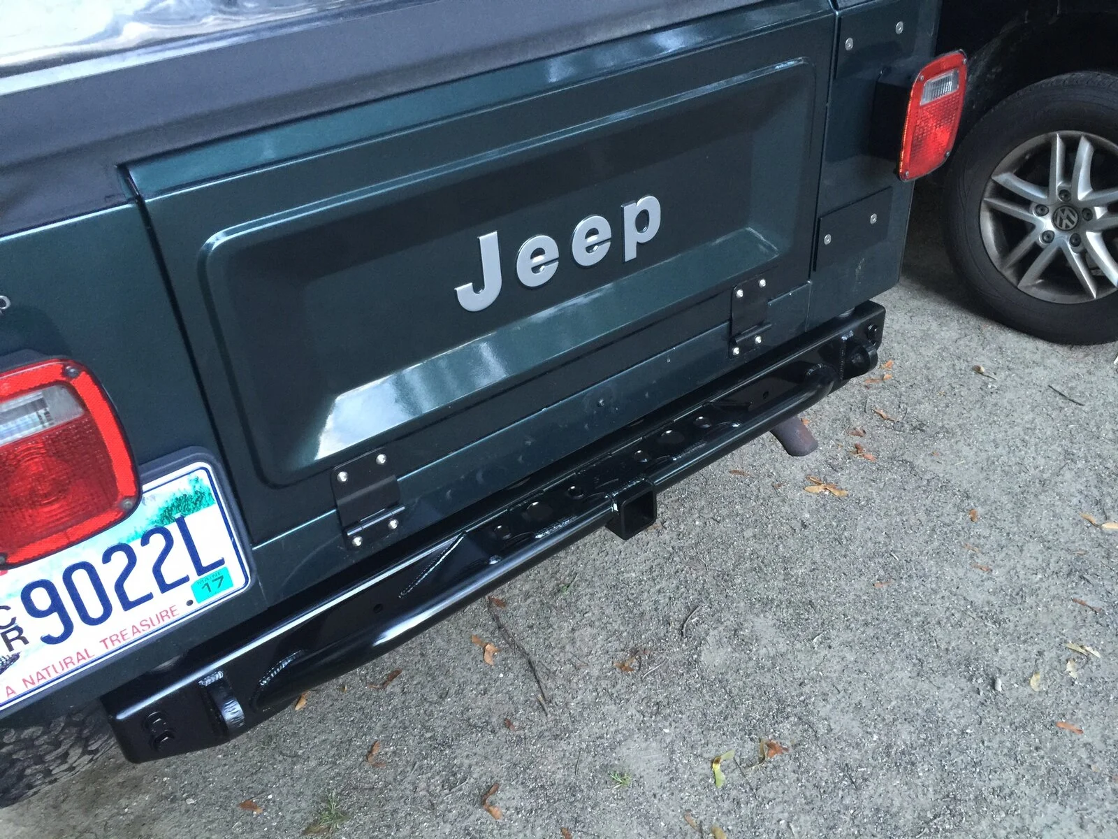

If you want an actual bumper, LoD makes some inexpensive ones (under $200) made in the USA.
