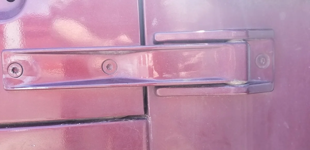

Which of these got torched?

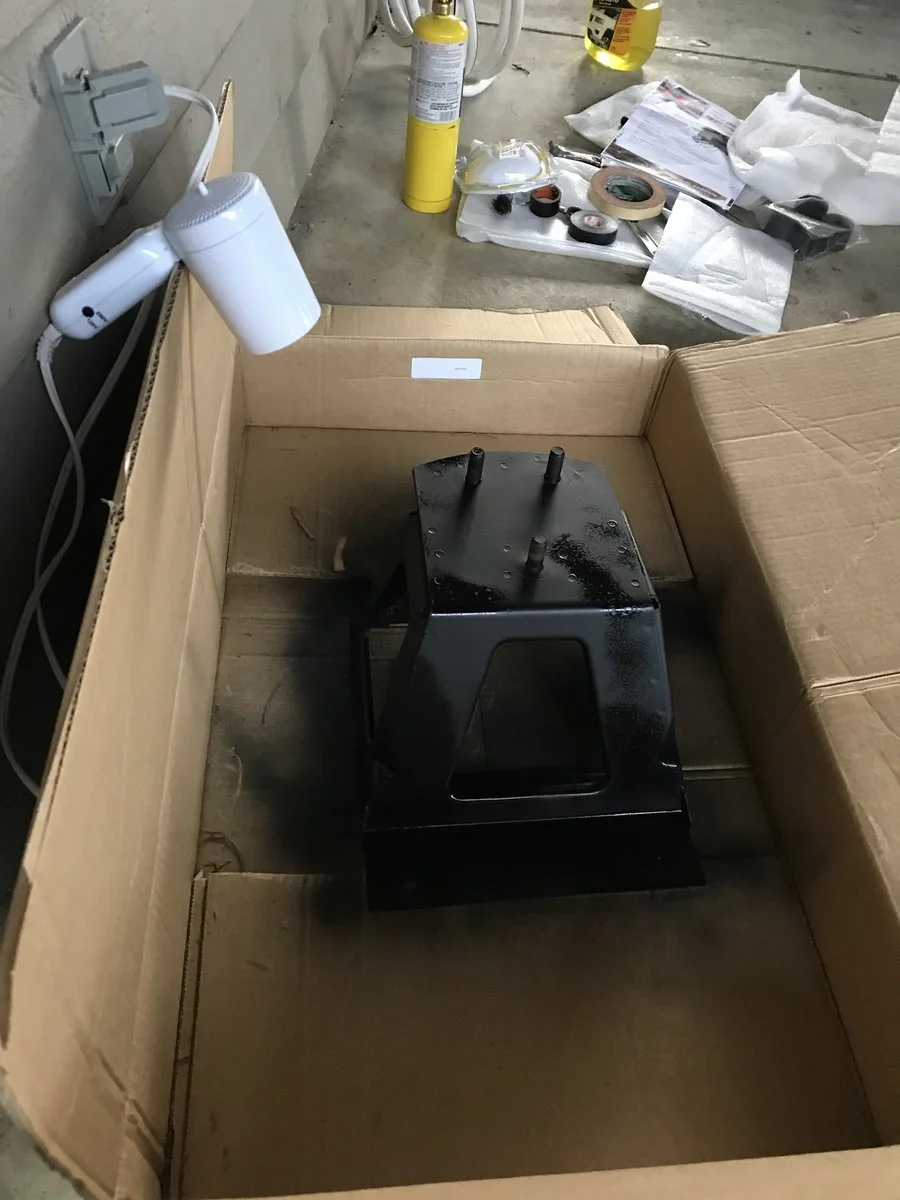

Regarding my pic above. Every one of those bolts was touched with MAPP gas and was easily removed. One of those bolts is starting to strip because it was the first and only one that I didn't try to remove with heat first.

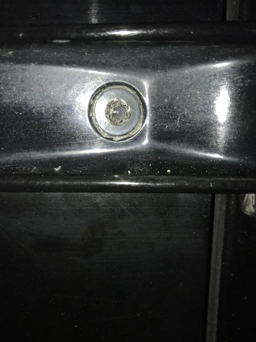

So in the end 2 torx ended up stripped. I now have a shitty opinion of torx screws. I’m not sure how to go about getting these two torx screws out. Really don’t want to butcher this whole thing. At this point I may just bring it in and pay to have it done. Just can’t be fucked with the frustration of what should be a simple task.

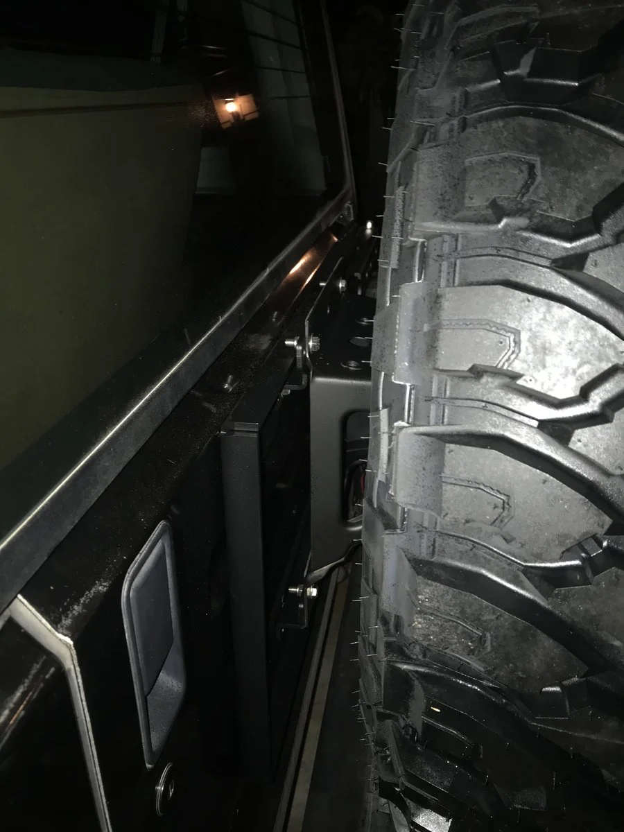

so I was able to torch and crack all but two. For the two that stripped, I went and bought some cobalt drill bits (not titanium)that were just slightly bigger than the width of the bolt. I drilled into the end until the head fell off. I then took the hinges off and grabbed the bit of bolt sticking out, now without a head, and torched then used vice grips and turned them out.
The one into the tailgate, I twisted out, the one into the tub, I reached up underneath and grabbed the bracket took it out then manually twisted it out.

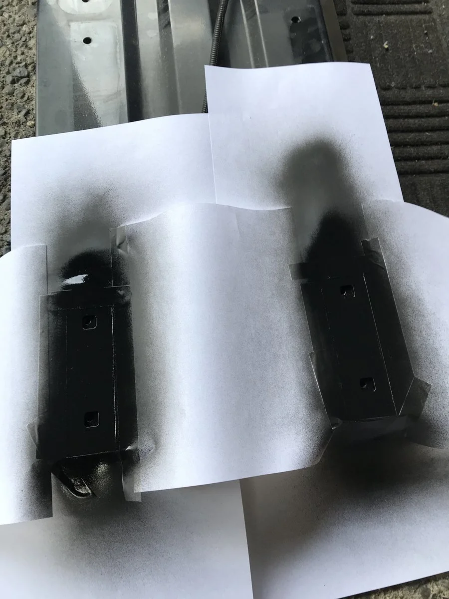

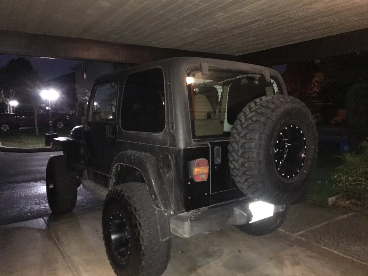

It then took all day to paint where the hinges came off and mount the moryde tire mount.
I still need to make some bumps for the tire to go against and slightly adjust the gate with the weight of the tire.
THEN I need to wire in the third brake light and the new light for the license plate mount inside the spare.

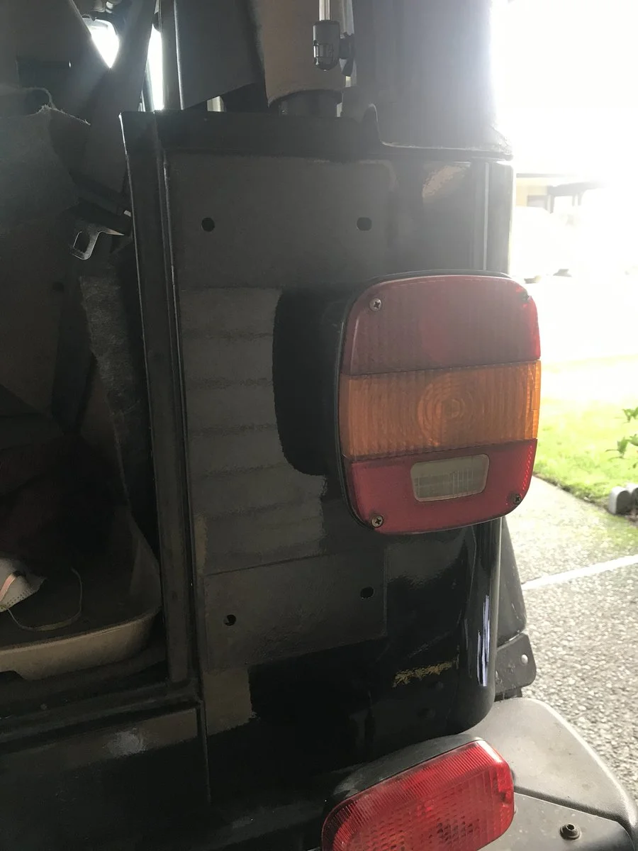

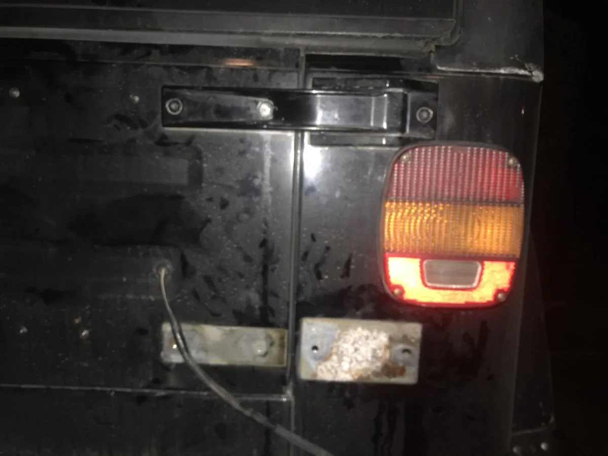

I will attach two photos of what I need to hook up. I have no idea where to begin with the wiring.
I tried to just take the old third brake light wires and directly attach them to the new circular brake light but didn’t work.
ideas?
