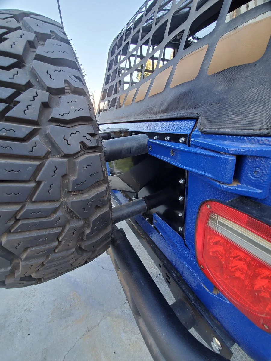

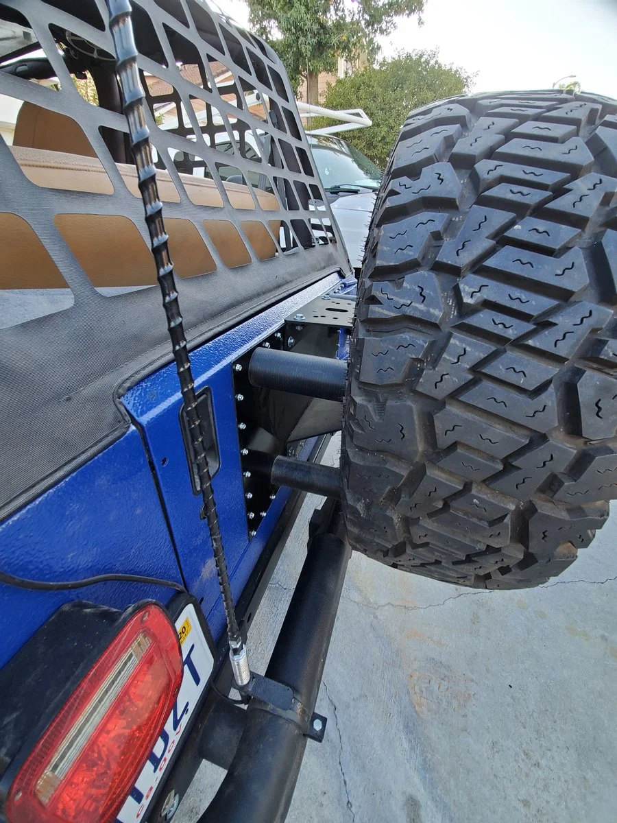

Hi all! I got myself and exogate. Any advice on how to get the torx screws out from the stock hinges? I stripped one already and am so pissed at myself.
See pictures. I tried heating one up with a heat gun. Guess I have to use a blowtorch?

The none- stripped ones, I always start with a hand held impact driver (the oldschool ones you smack with a hammer)
The stripped ones, I drill the head off, remove the part, then kroil the threads and remove with vice grips. Once I had to weld a nut on. If you're removing a part like a hing, and you very carefully just drill off the head, there should be enough sticking out to grab or weld to... worst case, drill and extract.
Drill the countersunk heads off with the biggest drillbit you can - you don't want to drill the shaft away.

Keep in mind that all of these torx fasteners use a thread locking compound. Heat softens it.

+1 torches and paint just don't play well together.
