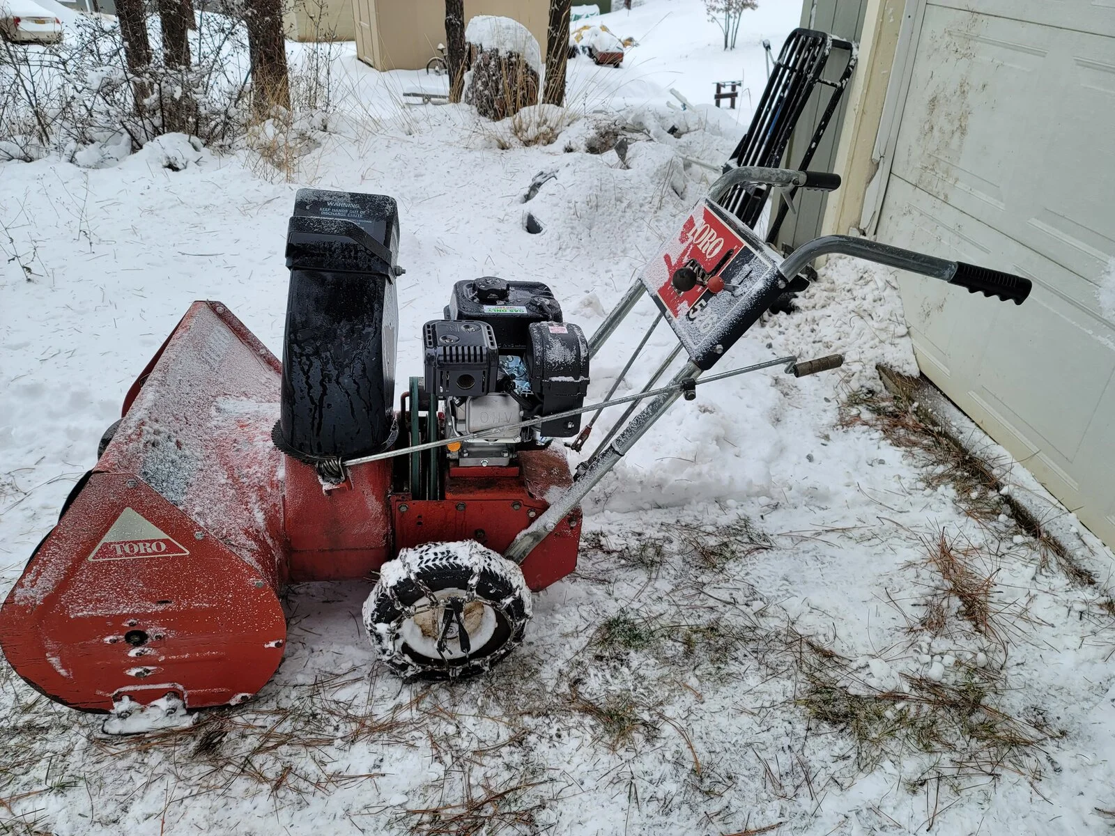

As for the pin I looked up that part number and seem to be getting shear bolts. My guess is there is some play in that shaft where the roll pin goes causing it to shear easier. If you rotate the wheels by hand while in neutral do you feel any binding?
https://www.ebay.com/itm/2945929145...d=link&campid=5337789113&toolid=20001&mkevt=1
No I didn't feel any binding when I rotate the wheels. The shaft might have a very little play in it. As old as it is I wouldn't doubt it. But the shear pin seems to drive in tight so I don't know.
If it happens again I'll try drilling it out to the next bigger size and put a bolt in it.

That's what I would do. If nothing is binding, it is usually a combination of wear on the shaft, and slop in the chains/drive system which can cause a load shock when engaging the drive/turning the machine that will shear the pins.
Reactions: Wildman
Wildman try putting a smaller roll pin inside the larger roll pin after the larger one is in place, double it up.
Grooved pins I remember used to be solid with some flutes to hold them in.
Reactions: Wildman

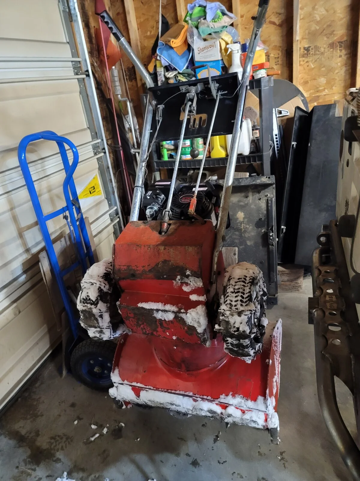

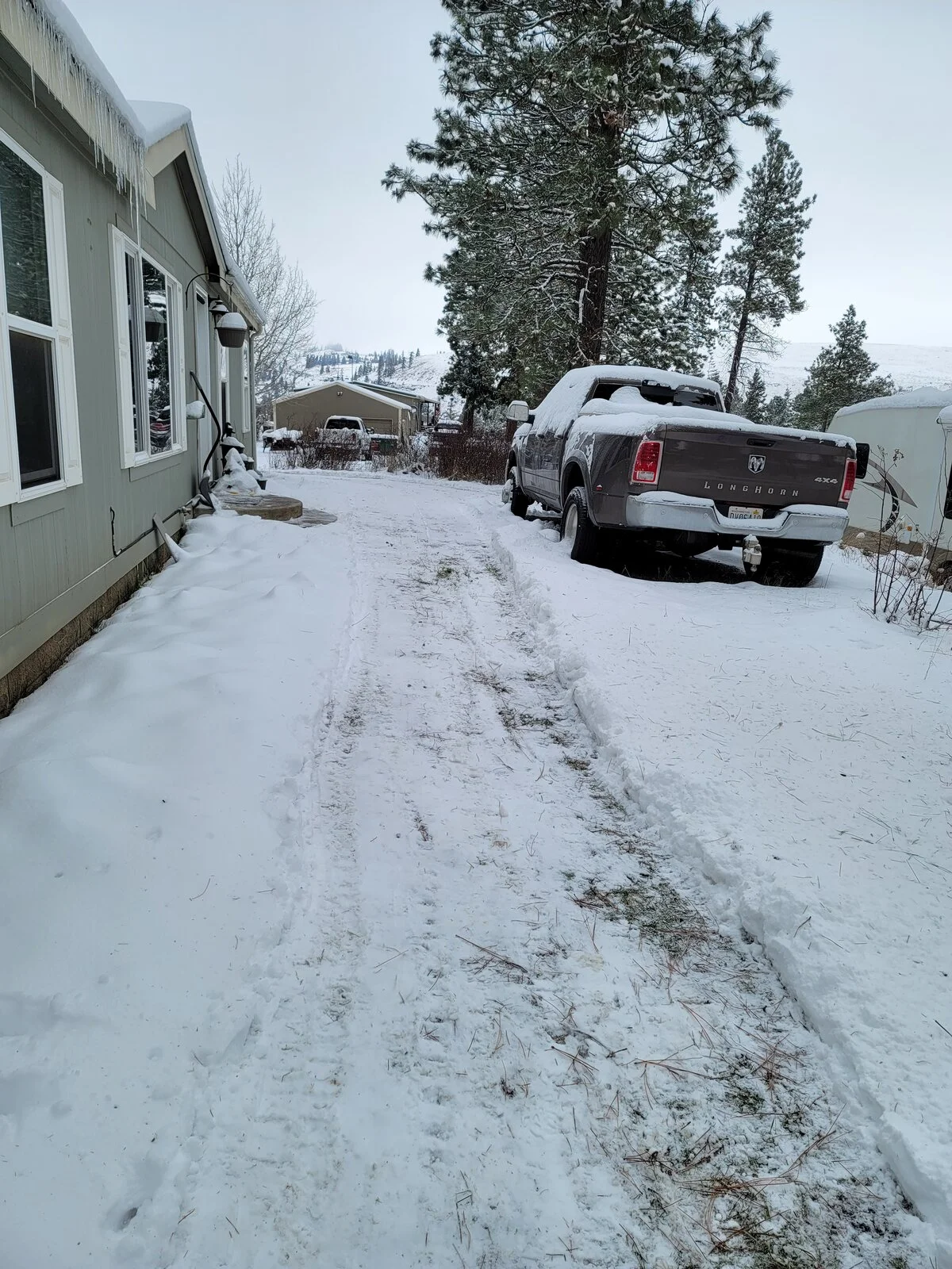

Just cleared the driveway. WOW wish I'd done this years ago. The new engine is great. It had only snowed about a inch so it wasn't a real test but it run so much better and doesn't vibrate my arms to death.
I'm more than happy with this new engine.
I used to hate having to mess with my snowblower and always hoped it wouldn't snow much.
Not anymore. This new engine has made such a huge difference in how this snowblower works. It's even throwing snow a good distance.
I'll try to get a video the next time it snows.

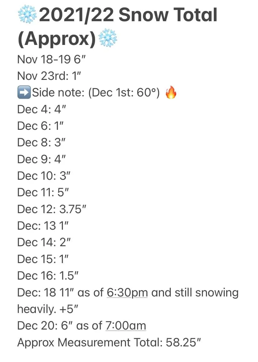

We're having a white Christmas this year. Snow fall total so far this fall/winter is 58". Of course most of it has melted off but.
