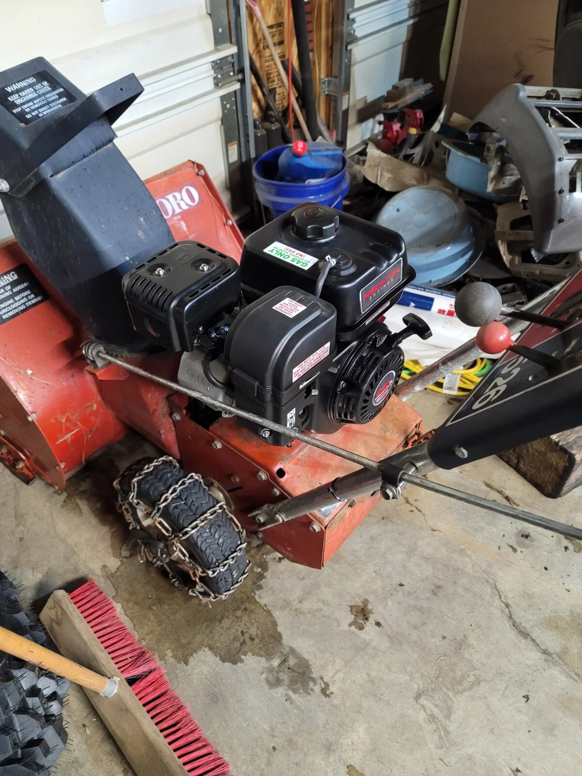

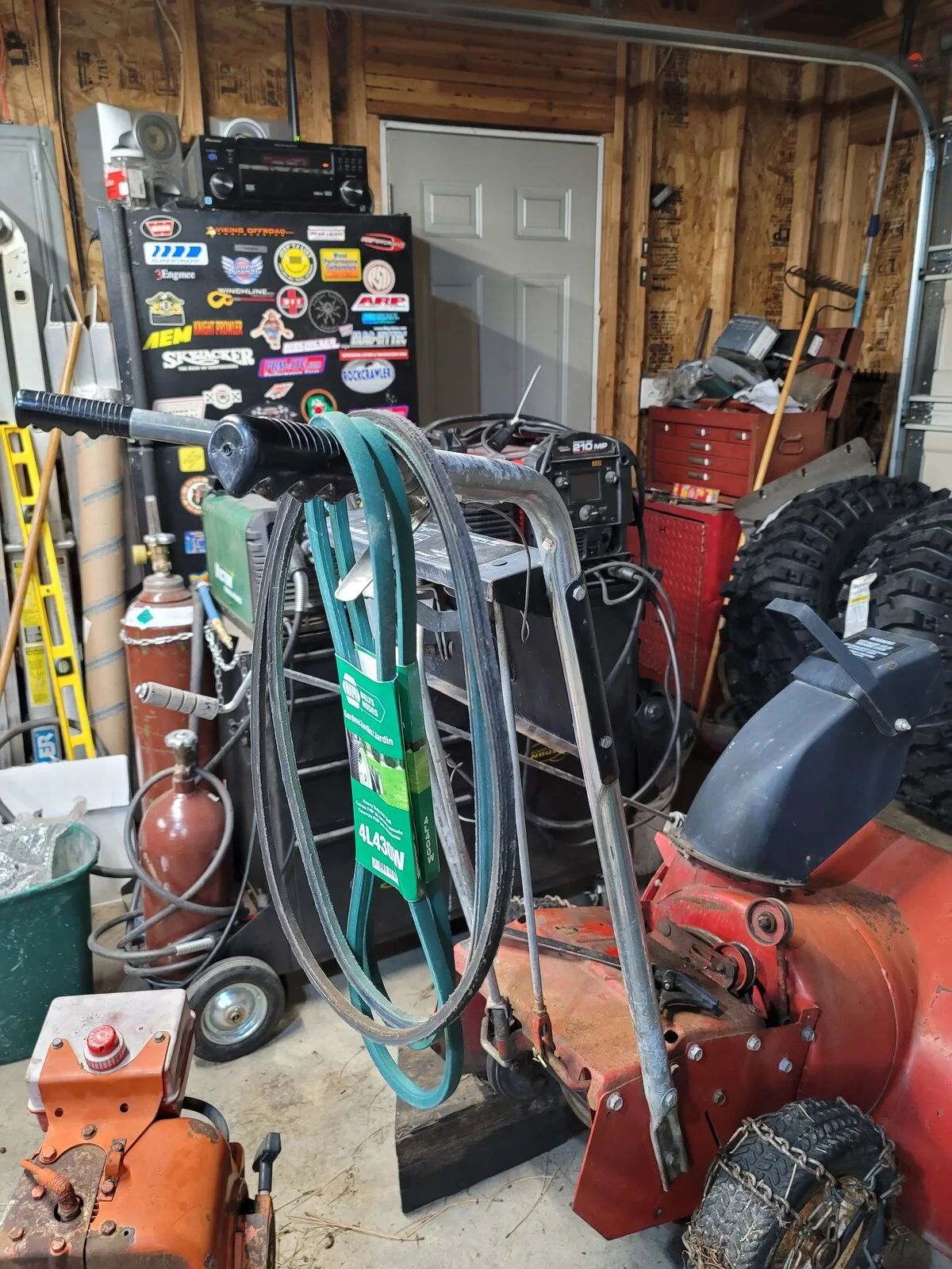

Had to run into town for longer bolts to mount the new engine swap so I picked up new belts for the snowblower also.
Damn stuff has gotten expensive 😕. $50 for two belts.....

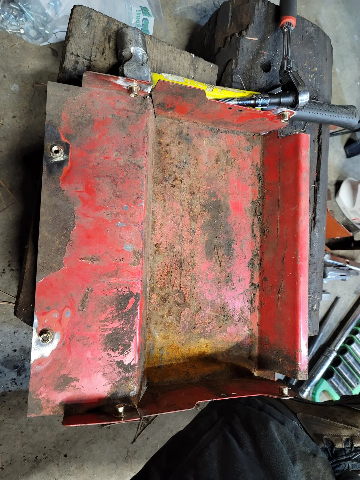

I ended up doing a little more than I'd planned to the snowblower. All the mounting bolts for the belly pan were stripped out and a couple of them had fallen out and been lost. So instead of just throwing it back together with the remaining bolts I went ahead and drilled them out and installed nutzerts. And old old pan bolts at 1/4-20 so I had more than enough to replace all the bolts.

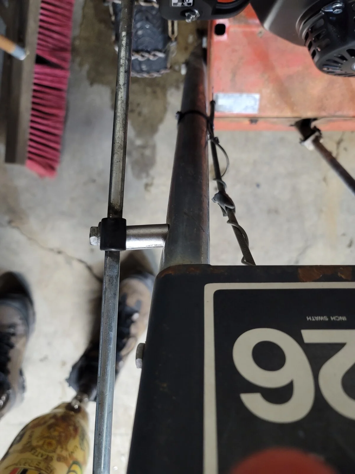

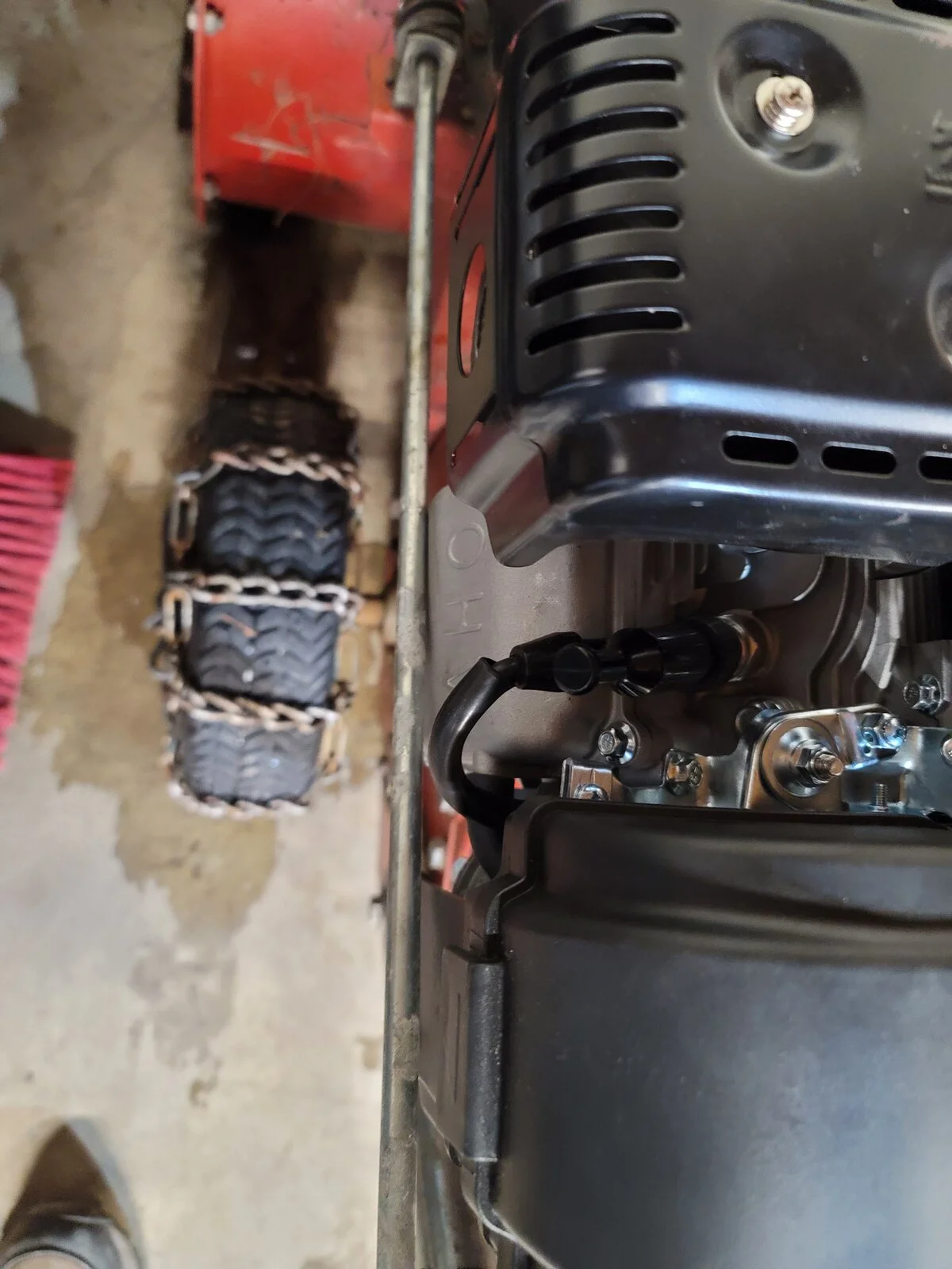

And then I had to fab up something to hold the chute direction control rod a little further away from the engine. But it's all back together and it is running again.

You'll love the power difference with the new engine, it transforms it into a different machine.

About $225-250 for the whole repower. I didn't HAVE to replace the belts but I figured I should while I had it torn apart.

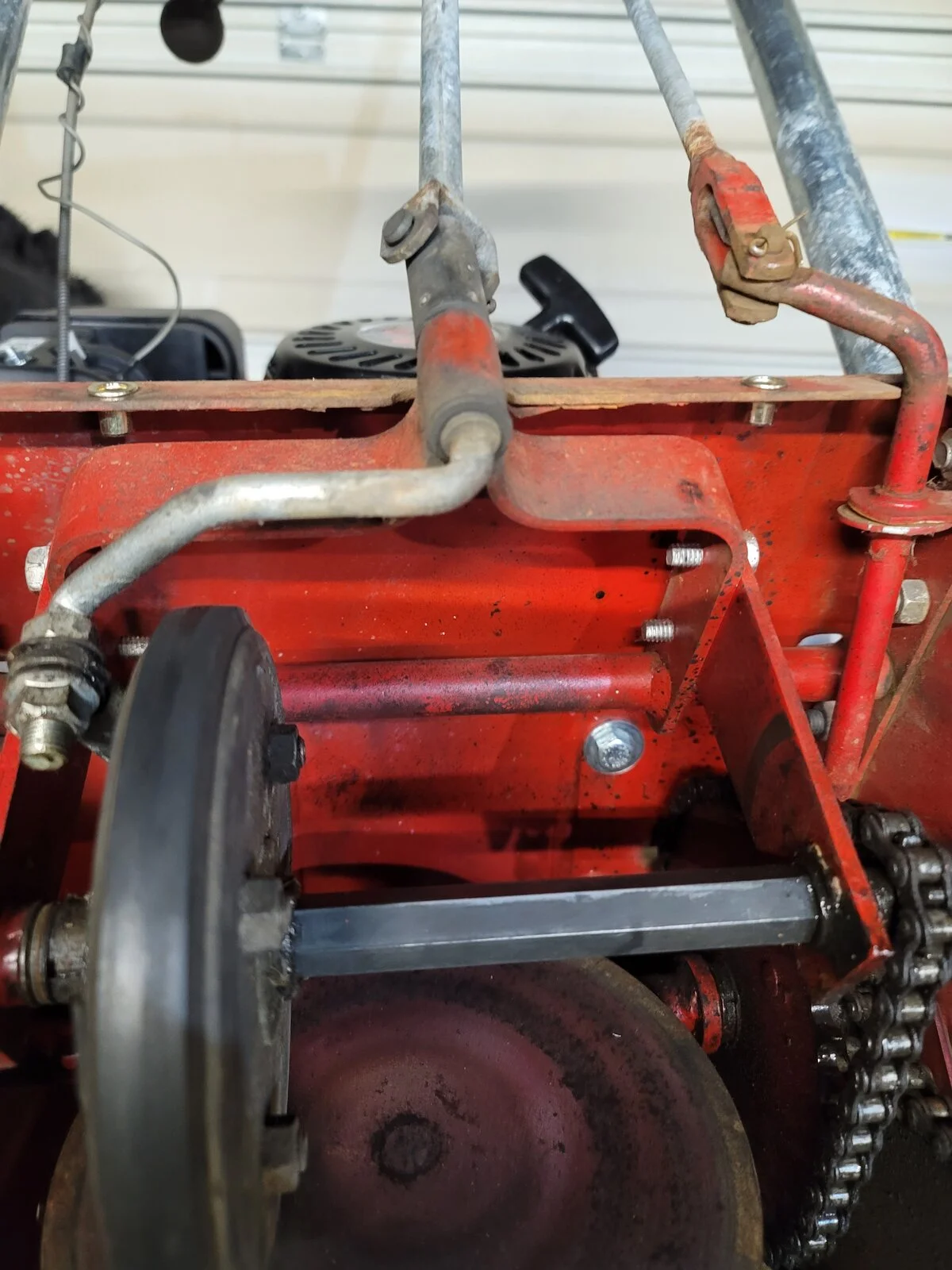

Thanks for that link. I'll order up the kit and do mine. Also do you know of a good place to get the roll pins for the axle? I keep braking the ones I got at NAPA.

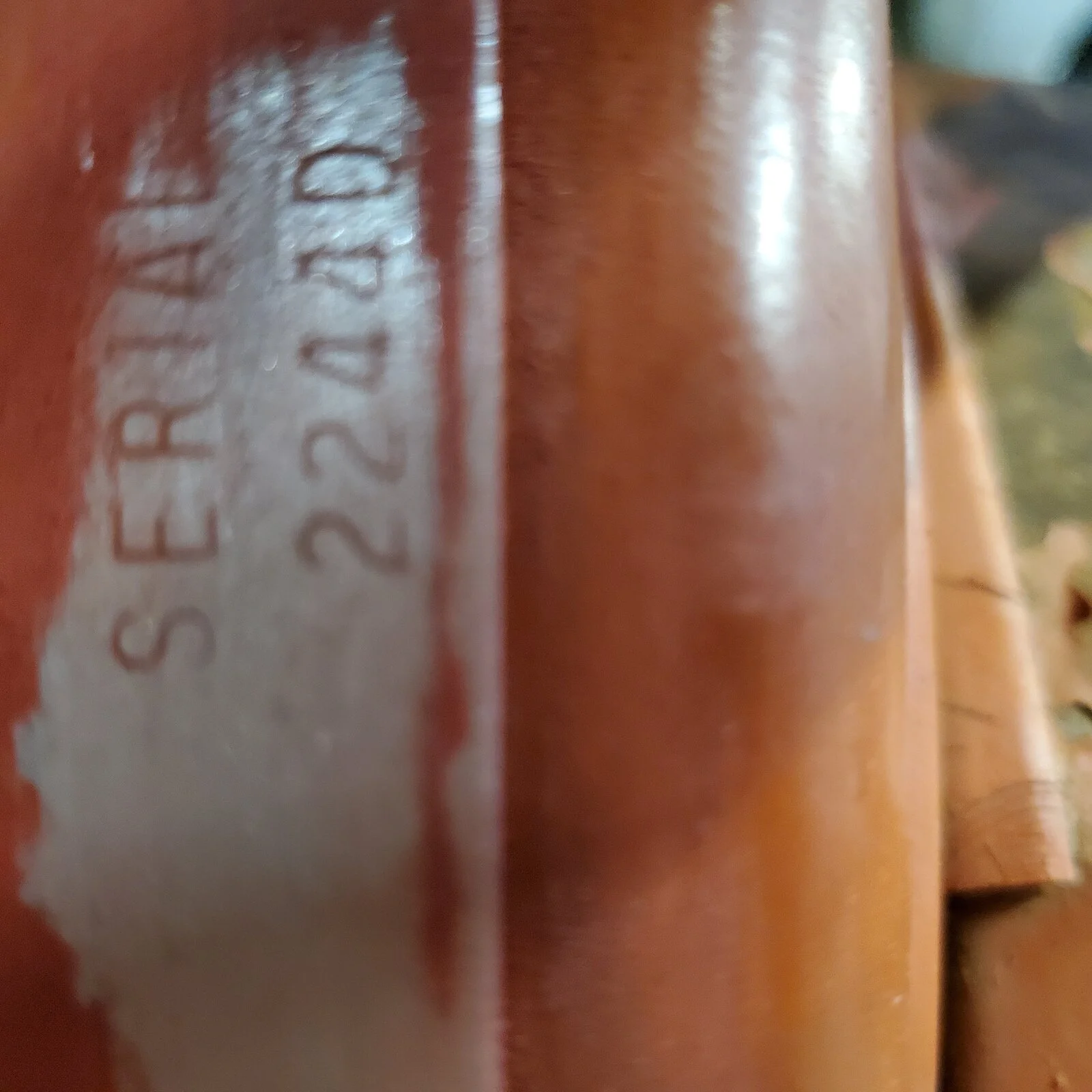

Are they on the outside to lock the wheels or internal for the axle shaft itself? I believe the OEM Toro pins are hardened but I could be wrong. Do you have the Toro model number for the machine? A few years ago I had an Ariens that kept doing the same thing. There was wear inside causing the roll pin to shear easier. I ended up just drilling it out a size bigger and sticking a bolt in it. No issues since.
It's the drive sprocket to axle shaft. I've put two roll pins in and then a bolt and they have all broken. The bolt wasn't a grade 5 or 8.
Here is the roll pin I'm talking about.
And a short video if it helps any.
I don't know if this is the info you need?

Is that roll pin supposed to be a weak link? Maybe to keep something else from breaking if it gets bound up?
I'd guess so but the ones I've got from NAPA are breaking from just using it.

As for the pin I looked up that part number and seem to be getting shear bolts. My guess is there is some play in that shaft where the roll pin goes causing it to shear easier. If you rotate the wheels by hand while in neutral do you feel any binding?
