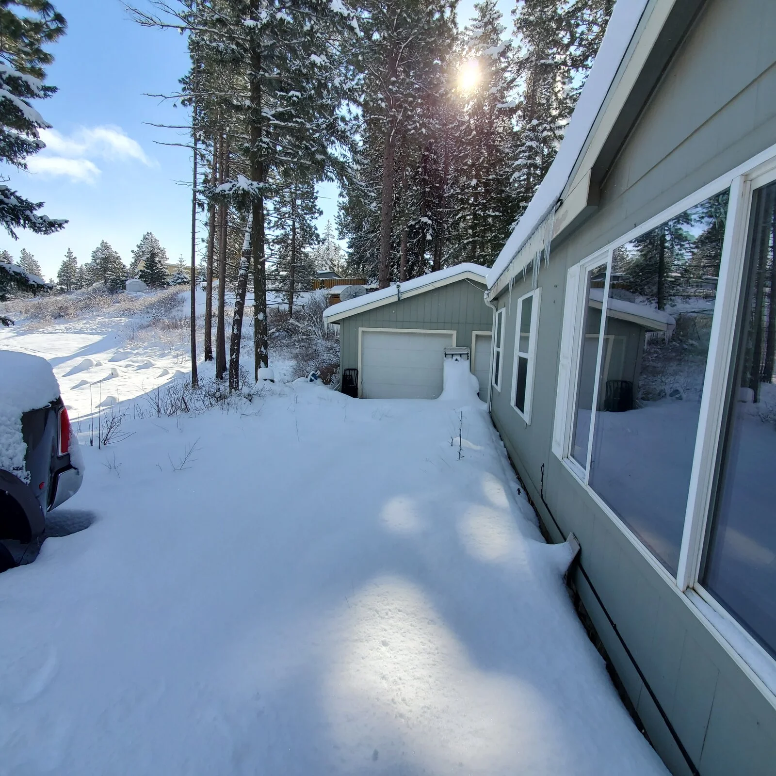

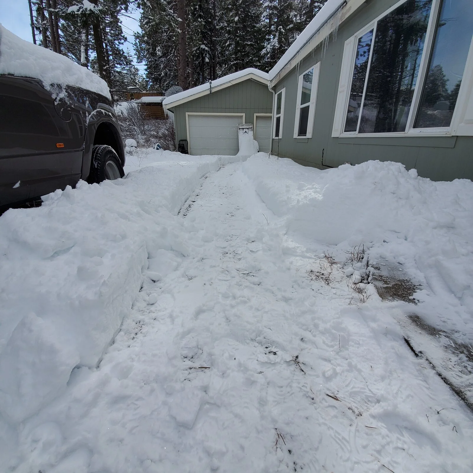

Well those of us in the PNW have been having some fun the past few days. It started snowing Friday and finally stopped Monday.
Yep I know there are places that got MORE snow than me but this is not our normal amount of snow all at once. I was lazy and didn't snowblow my driveway until today. I didn't measure it but it's close to 2' of snow. The pass on I-90 has been closed off and on for 3 days and is closed right now due to avalanche danger.
