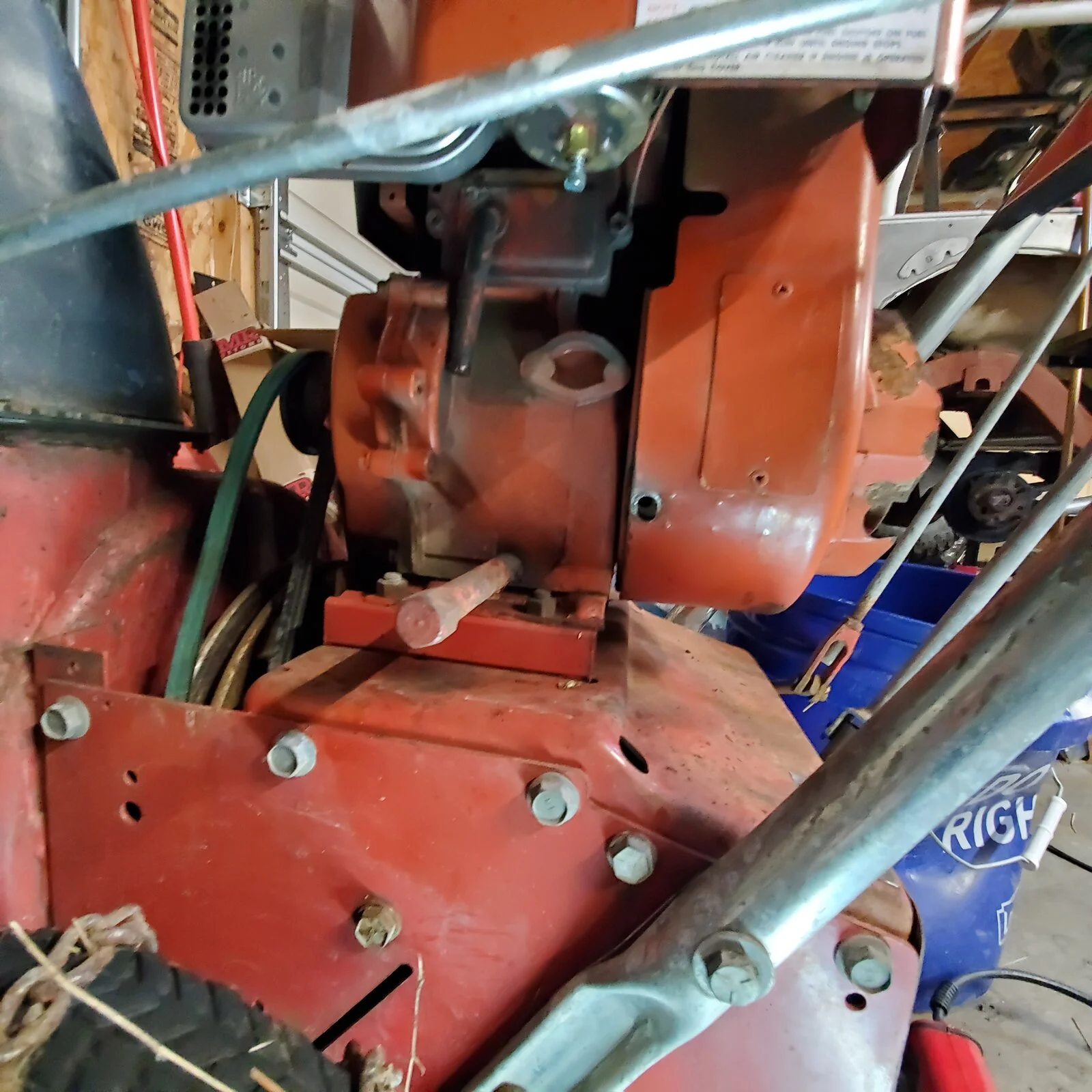

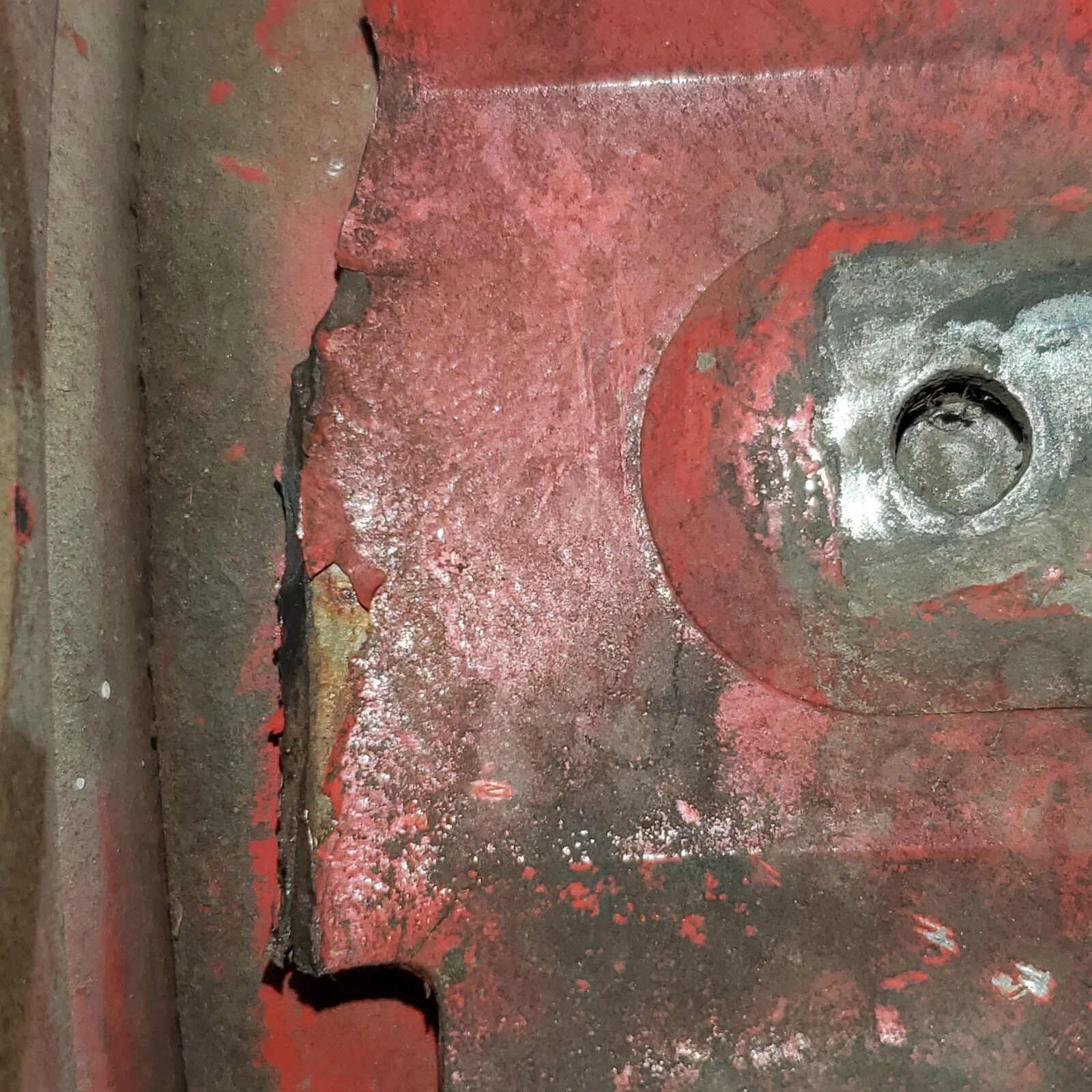

I'm not sure what this bracket is made out of. I bought the one I found on Ebay but I also might try to repair the broken one.
Here is the bracket mounted on the engine.

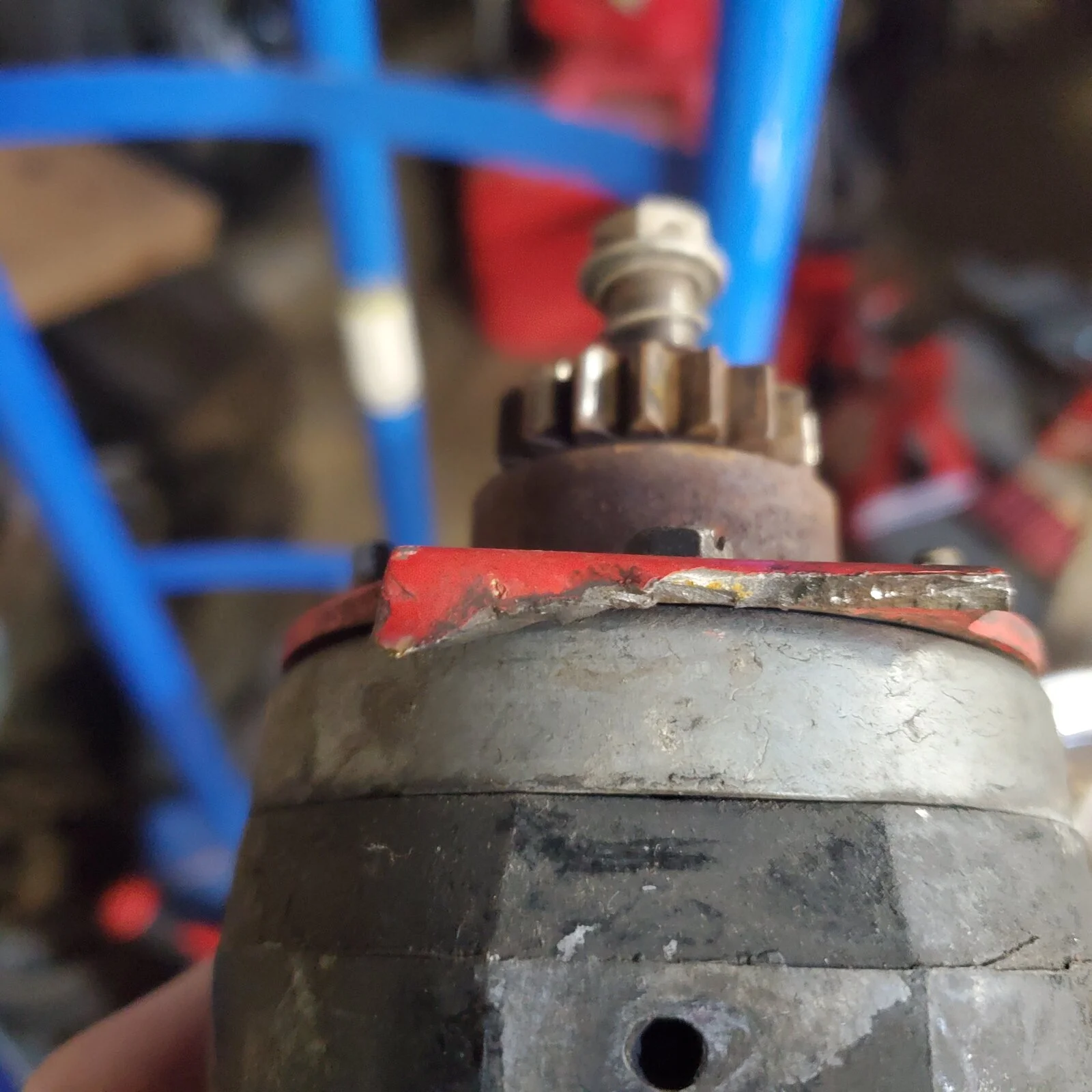

You can see where it broke right where the bend was.

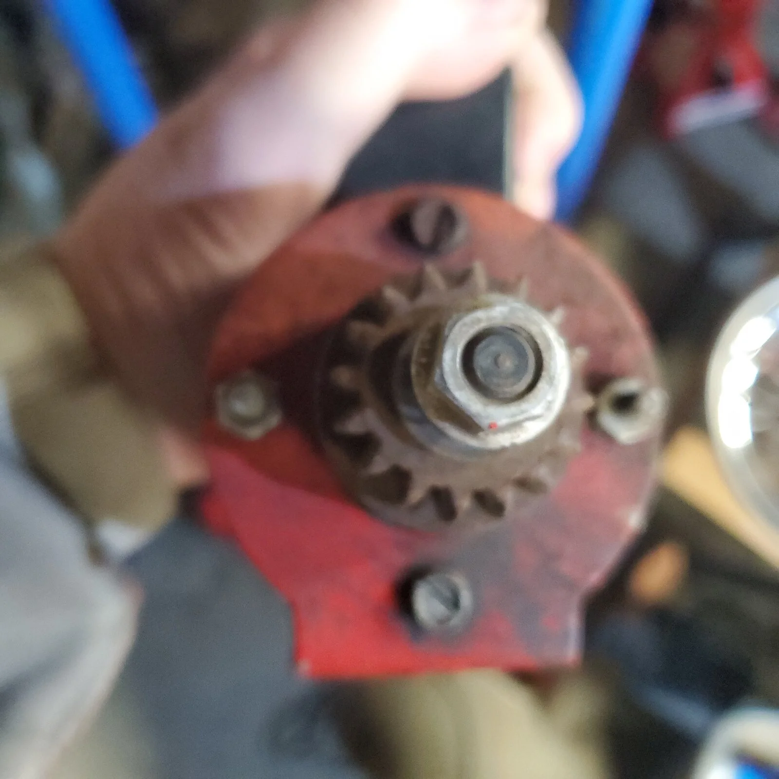

The part on the starter itself.
I'd have to make most of the weld on the outside of the bracket. Not sure how it would work out since my welds aren't that great.
Will look at it more tomorrow.

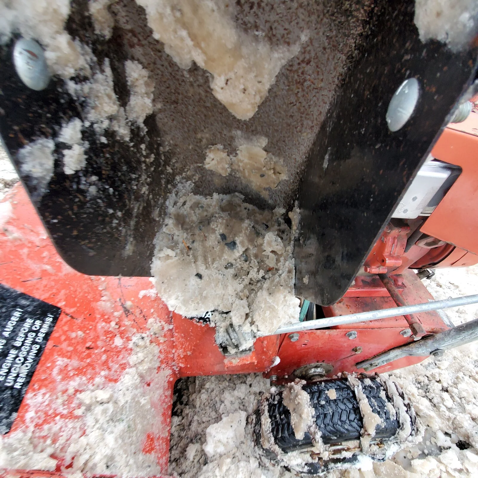

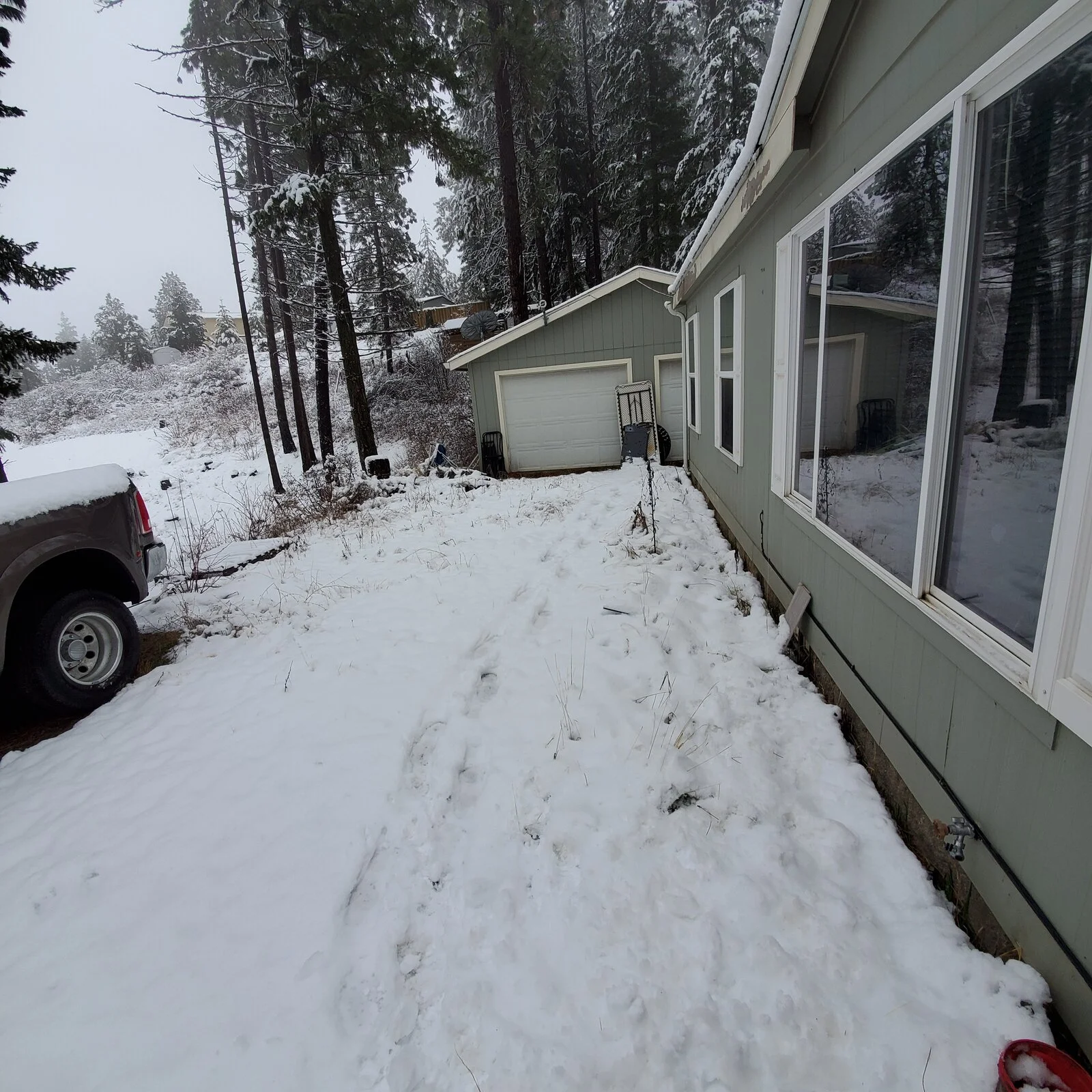

Damn I HATE wet SNOW. It dumped on us about 3" last night and then this morning it has started to rain and the snow is just a mess.
Snowblower got clogged up 3-4 times. Got me a stick to clean it out with each time. Don't feel like losing any fingers. Of course I shut it off also before I'd try to clean it out.
Did you do the impeller upgrade with the rubber paddles? It would prevent this. (y)

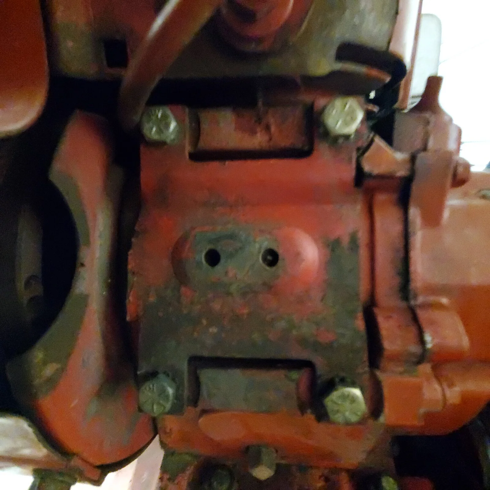

If you can get me the model number of the current engine and a picture of the drive belt orientation I can send you a few links to exact replacement engines. I just need the drive belt pic since some snowblowers have a odd set-up where reverse runs off and additional pulley on the camshaft of the engine. These are rare, but are harder to find replacement engines for. Electric start will add probably $100 to the cost of a new engine, and I highly recommend the Predator 212 Honda Clones from Harbor Freight. They can be had for $100 with a coupon and start first or second pull.

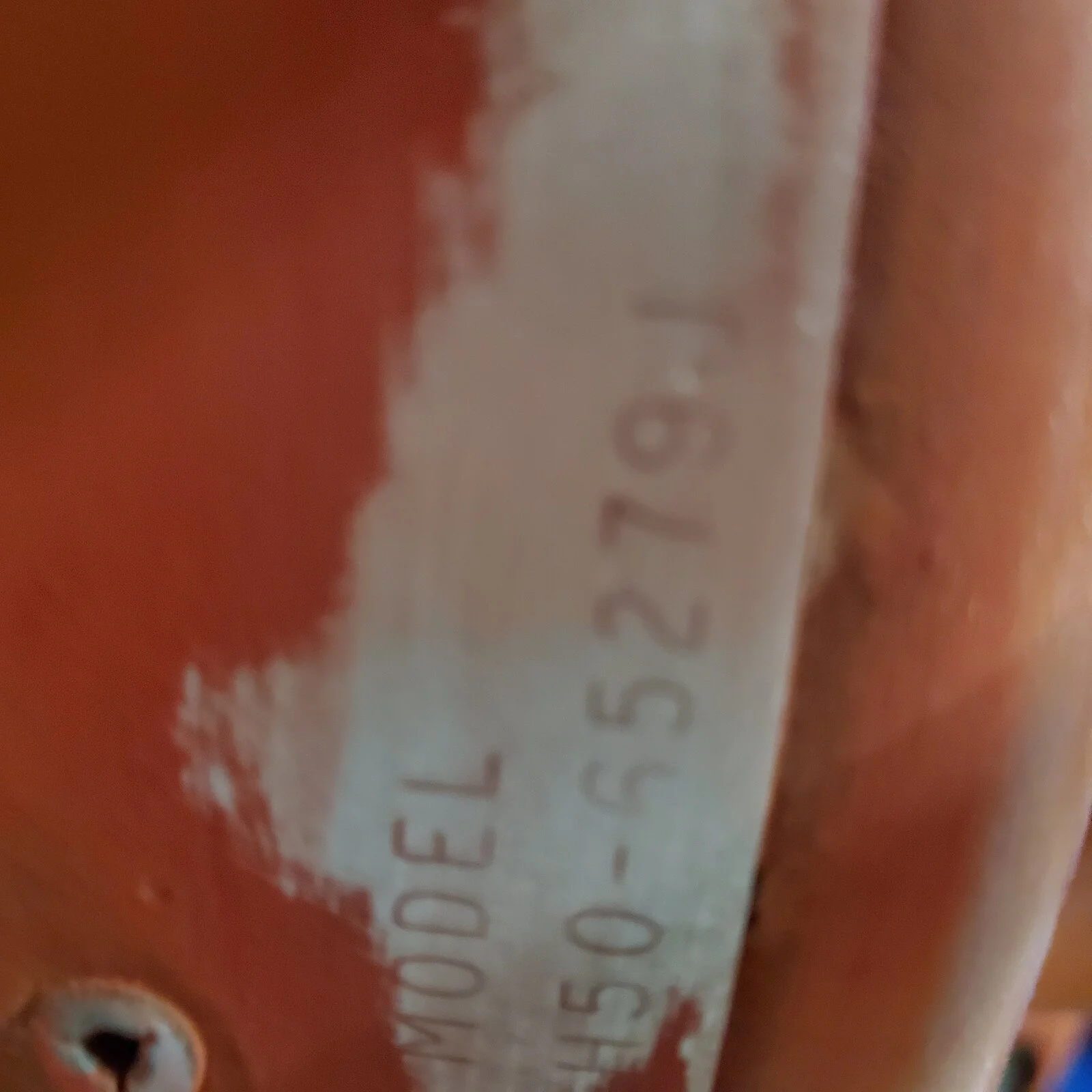

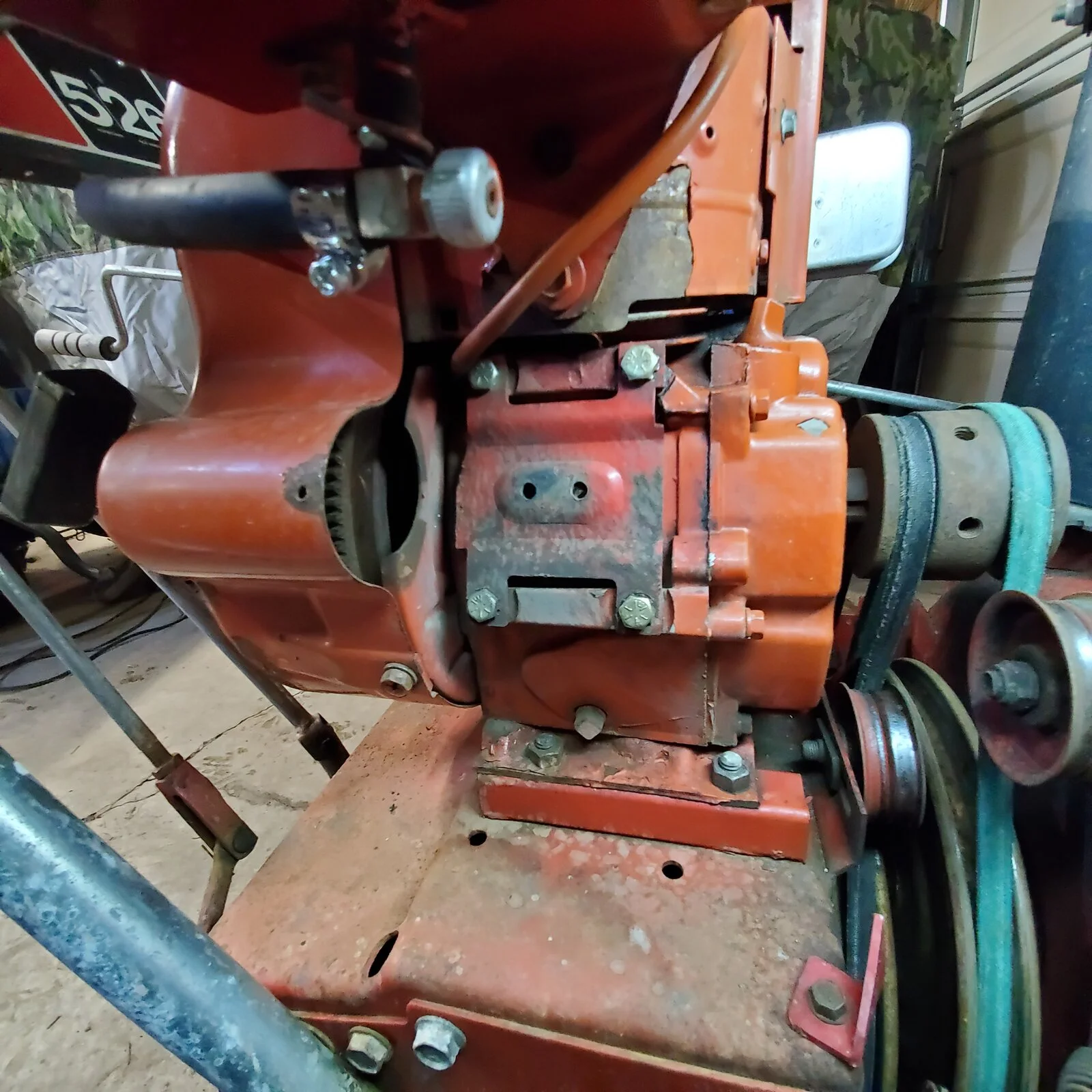

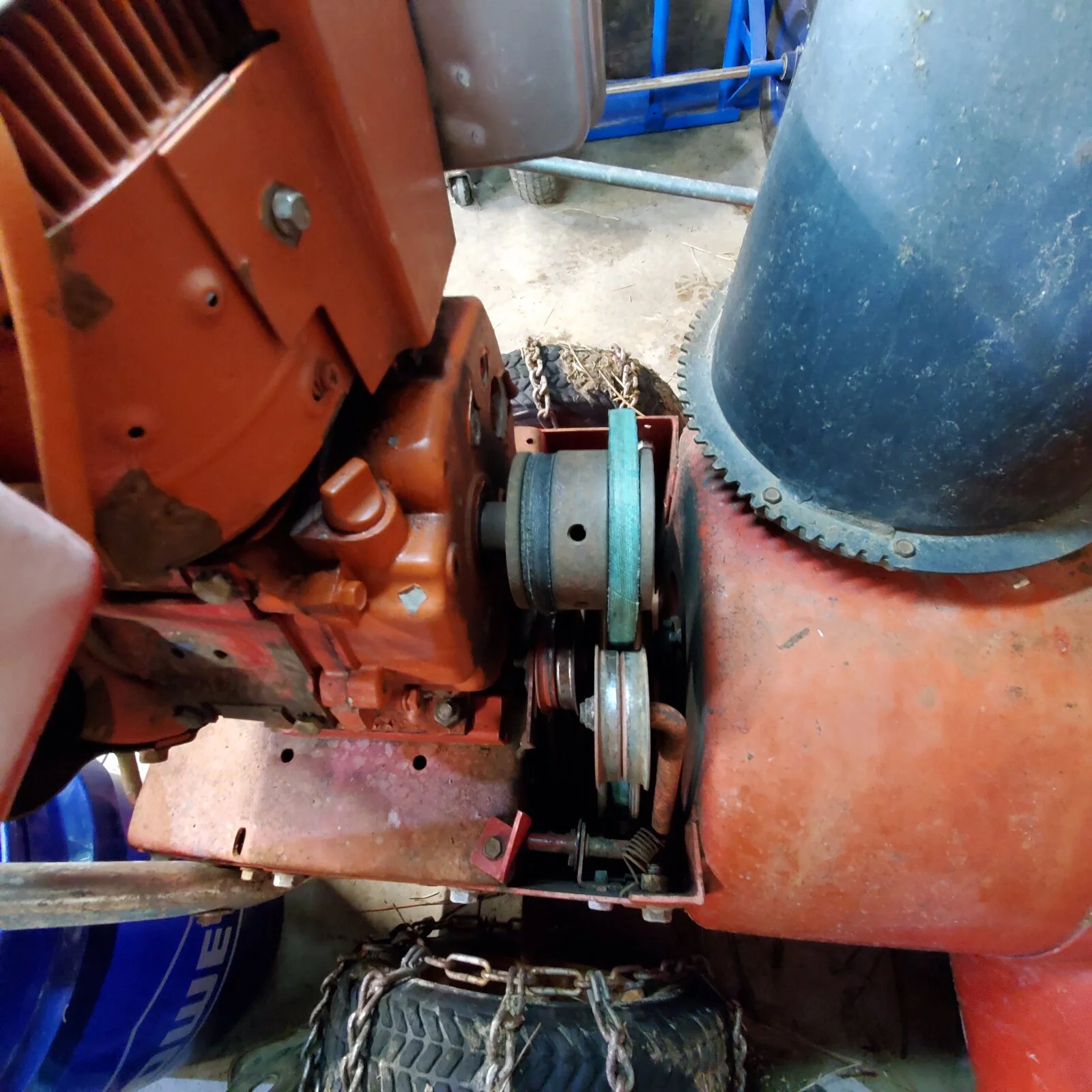

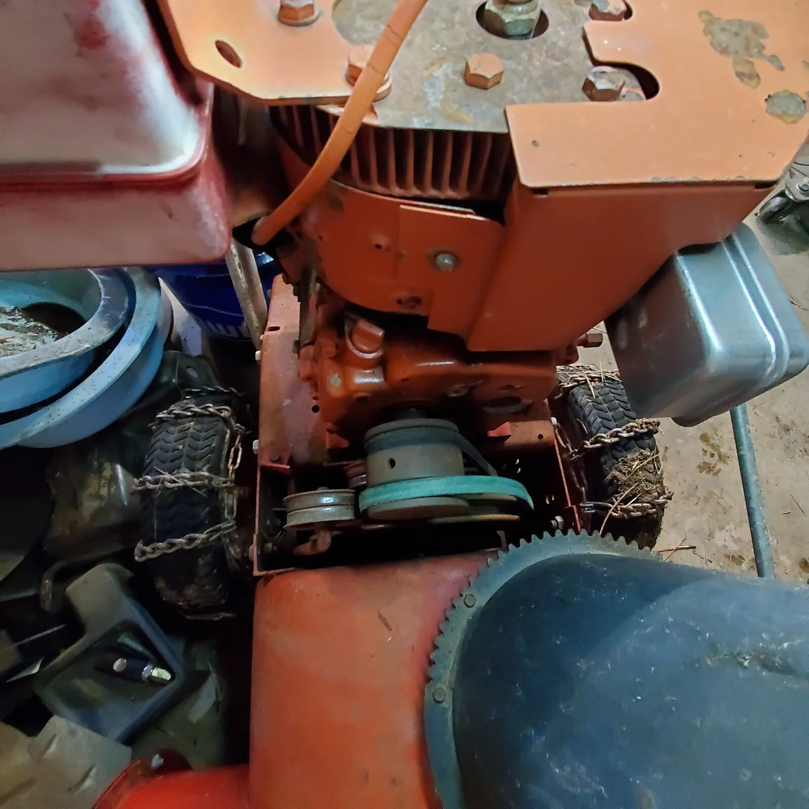

Took me a LITTLE while to find the model # because it was painted over.
Pulley assembly
Model #

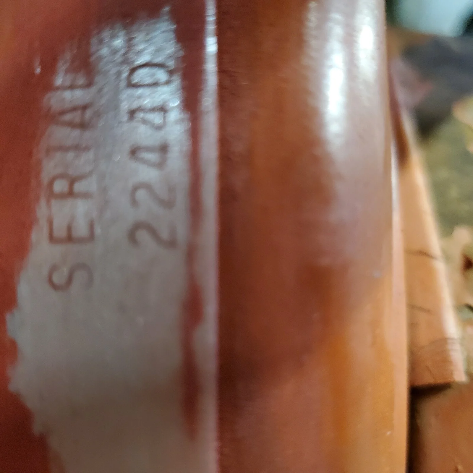

Serial # if it matters.
Pulley assembly
Perfect, I'll look up some for you tonight since all of my reference info on those engines and what will fit are on my garage computer. The only issue I can see with yours, and it's hard to tell, is that a lot of Toros have really short studs that the current engine bolts too. You might need to punch out the studs (cut them off and drill them out works too) if they are too short and welded directly to the frame. I can't quite tell from the pics, but yours might have a separate platform on top of the frame that the engine is bolted to, which will make putting in longer bolts easier. The reason is the engine block is thicker on the newer engines. Other than that it looks like a pretty straight forward swap, you will just need to swap your pulley over to the new engine's crankshaft, and you can re-use your current belts because the dimensions will all be the same.
Start spraying the belt pulley allen key set screws now with PB Blaster haha.
