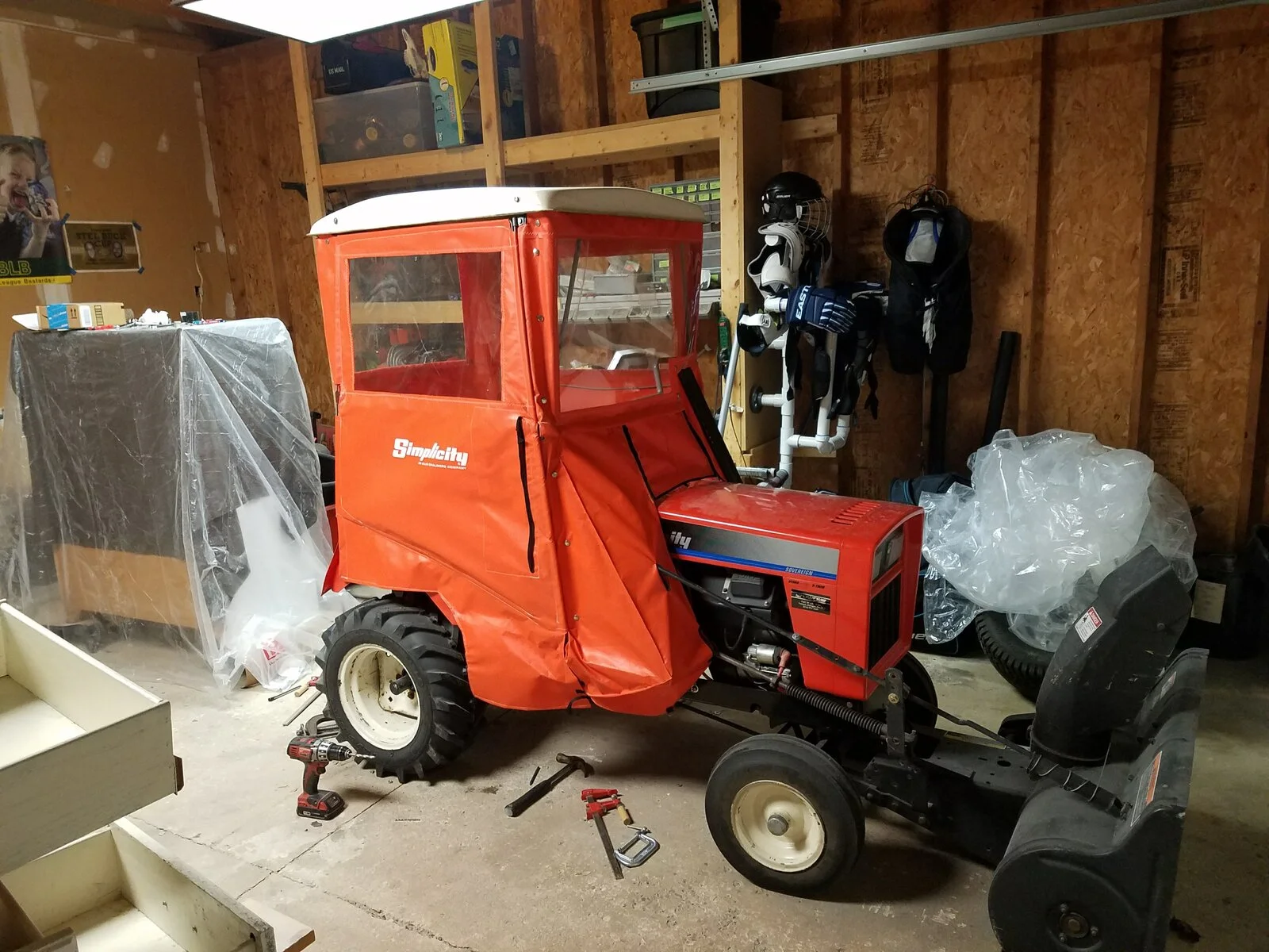

Cabs are awesome, no doubt about it. I had one for my Simplicity. even though it was nothing more than a conduit frame and heavy duty tarp with a fiberglass roof, it kept the blown snow off you and made a sometimes miserable job pretty fun.
This was my go - to for a lot of years. Only a handful of times did I ever have an issue with snow sticking to the windows. Gotta remember, everything is cold, so the snow doesn't melt and stick. It just falls away.

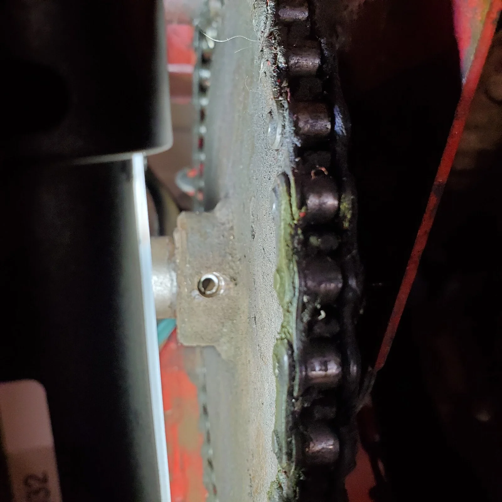

Well here I thought I'd fixed the snowblower....
Go out this morning because we'd gotten about a inch of snow ❄ so was going to try the blower out.

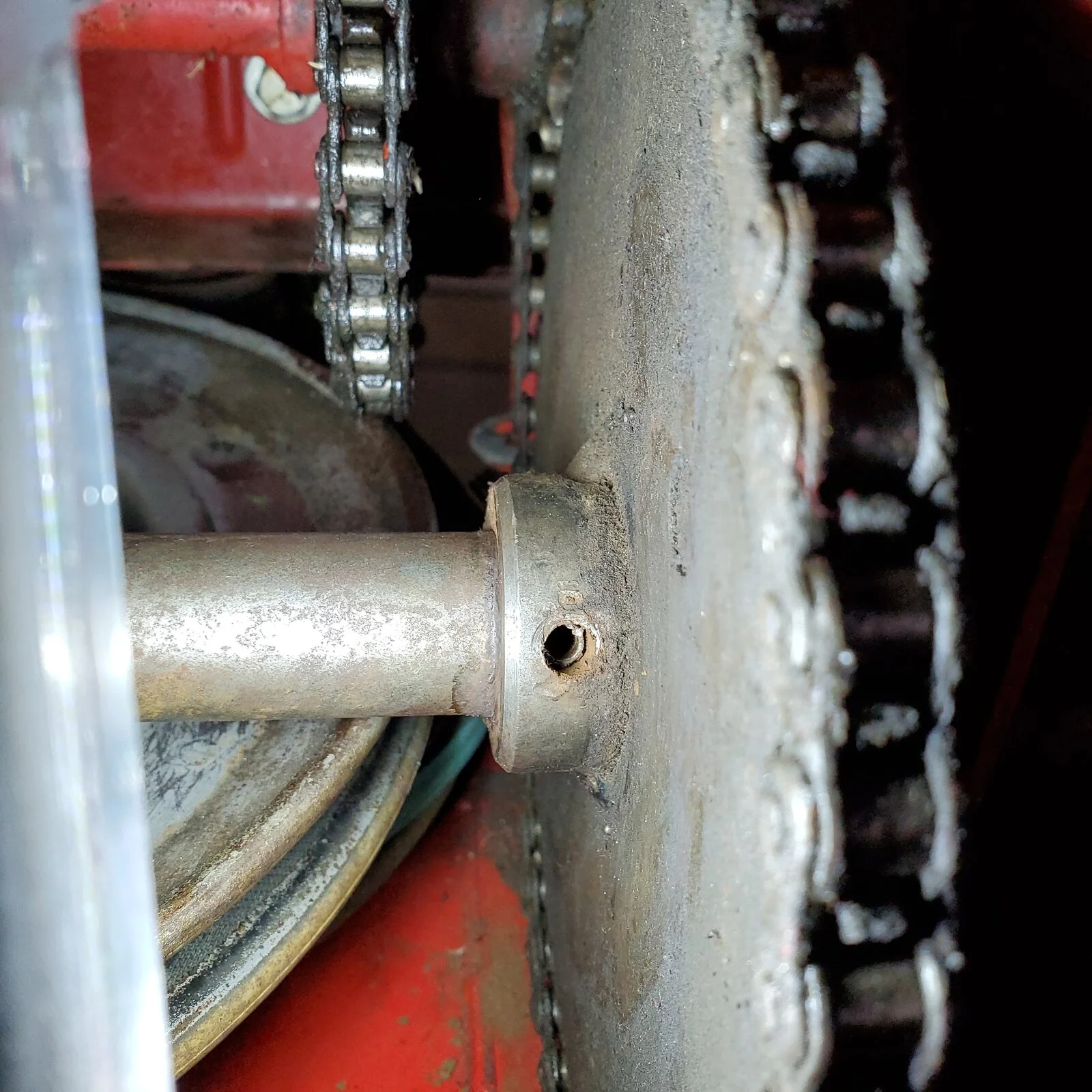

Made it about 6' from the garage and the blower stopped driving. So I dragged it back to the garage and pulled the bottom guards back off. Started trying to figure out how the whole drive system worked.
Found a roll pin in the axle pulley that was broken.
Had to figure out where the hole was so I could drive out the broken pin.
Got it out and ran into town for a new roll pin. Came back and got it fixed.
