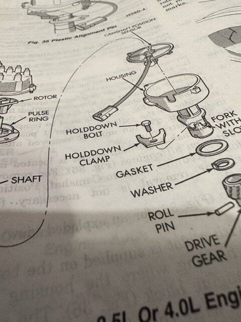

looks like you are missing the holddown clamp

Your distrubutor foot is broken. However there should be a hold down clamp as well.

yes I was. I did not see on page 1 that the hold down "clamp" sheared off. Please point that out to me. I was not talking about the fork on the distributor but the actual clamp that is in the pic that I uploaded.
...Please point that out to me...

Regardless, it's probably worth asking OP if his mechanic sourced a new clamp as part of his distributor testing. I don't think I got a new hold down clamp when I replaced my distributor, so unless the mechanic had one laying around.... With the clamp, there's only one way the distributor will fit. Without it, I guess it could fit lots of ways and end up working more like a manual timing setup. It's also worth mentioning that it's not all that hard to be off by one tooth when you set the distributor.

Wrong use of passive-aggressive behavior as to this thread (now the other thread between us, maybe so). Nevertheless, all I was doing by my original post was to help someone out (just like the last time I did and you told me how wrong I was - but instead you were wrong) and you give a laughing emoji (i.e.: saying my statement was laughable ). And I wanted to know why, which you responded by telling me that what I had pointed out had already been discussed - so apparently it was funny to you that I did not know that. So I asked you to to point out where it had been previously discussed and you can't. So I guess you thought the discussion about the bolt ("screw") being sheared off was the same as me discussing holddown clamp, which it is two different things.
