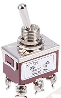

[Rant/On]I ordered a pair of replacement "Heavy-Duty" switches from Amazon for my lockers 9/18 to replace the lighted switches I installed nearly ten years ago. This is the replacement switch I bought... https://www.amazon.com/gp/product/B0058BNGTS/?tag=wranglerorg-20
82802
I replaced both lockers switches 9/18 with that one out of an abundance of caution. That backfired on me. My constant worry was the original locker switches I installed had a lot of plastic content. Even the toggles were plastic and that nagged me ever since I installed them. So I replaced them with the above "Heavy-Duty" switches, I was much relieved after doing so and figured they were two less things to worry about.
Yesterday I'm heading out for a pretty tough rock crawling trail that requires both F&R lockers. I tested both before leaving my house and they worked fine. Then early on the trail the front locker stops working. The effing new switch had come apart internally. Instead of it only moving up/down, the toggle could be moved 360 degrees. No effing front locker!!

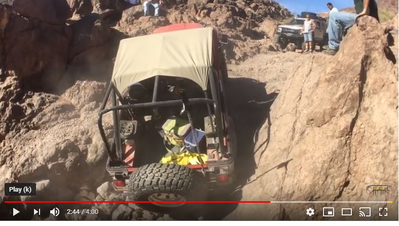

This isn't me but it shows the last part of the climb where I slid over more toward the right-side. The final section is slick smooth rock which is where the second locker comes in handy.

I'm very happy with the quality of the switches received yesterday and installed this morning. I replaced both of the locker switches with the new ones, I didn't want to leave the old rear locker switch that was still working but have it break too.
This is the post-mortem... the black plastic part circled in red broke in half. The toggle fits into the middle of that piece & flips the two rocker contacts sitting on the left. Cheaply made for sure.
