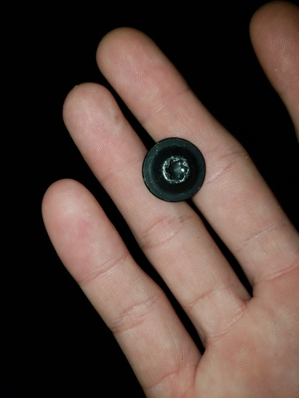

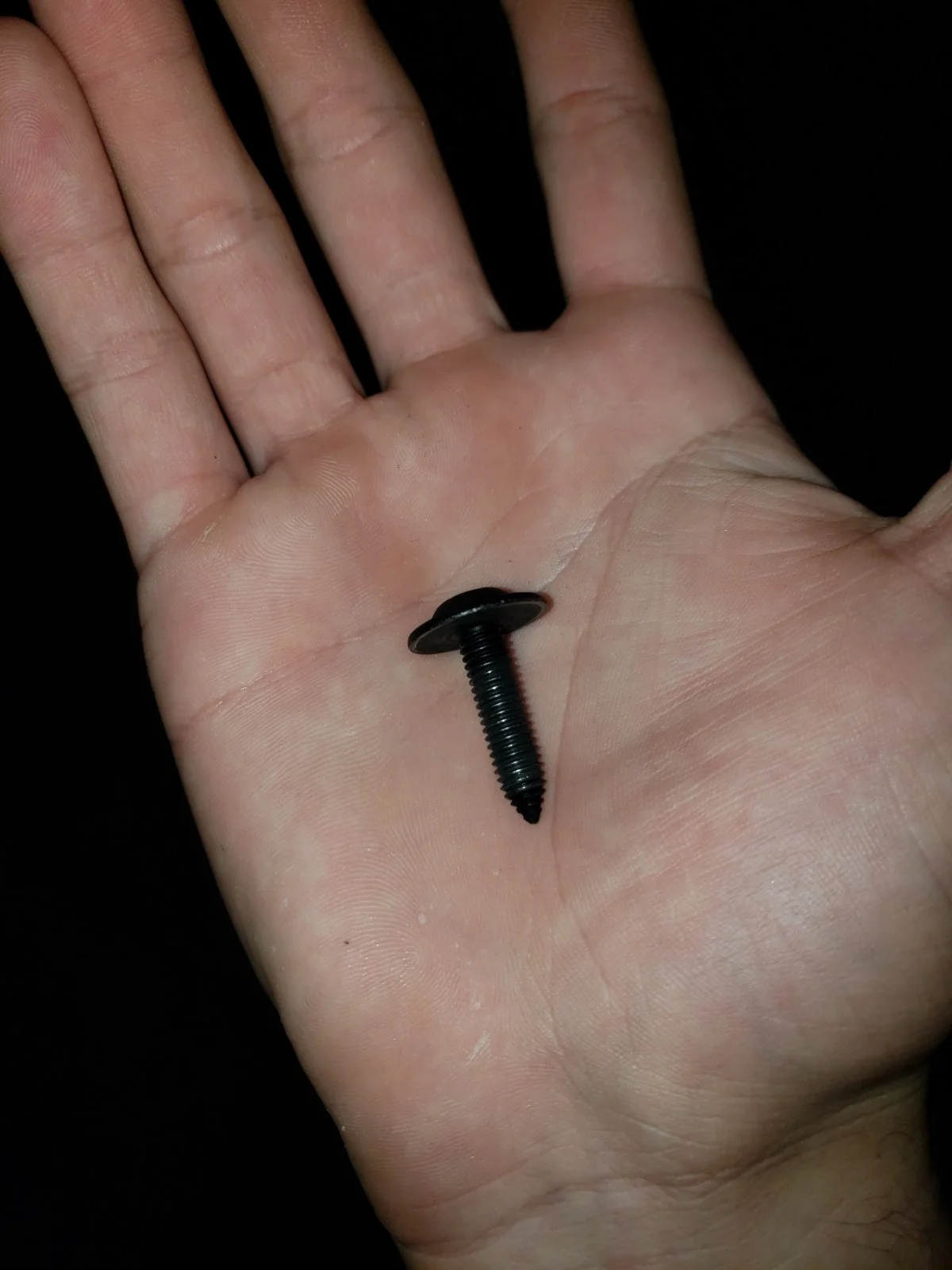

Anyone know what bolts are factory for the factory rear speaker bar? My project came with the speaker bar unattached, without bolts to secure it. I'm sure they are pretty readily available, but want to make sure I get the right ones.

From my 98
https://www.quadratec.com/products/...MIu7H236iR3QIVw2F-Ch1VPwYuEAQYASABEgIUUvD_BwE
