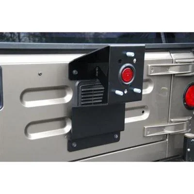

Does anyone have experience with Hyline OffroaD Oversized tire mount? Looks like the spare is moved up, not out. Spare should stay in contact with the support bumpers. Plus, it has a cutout to allow installation of a 3rd brake light that would be visible through the wheel’s center hole. Pretty clean looking if the light is bright enough.

Moving the spare tire up decreases visibility, and nominally center of gravity. Moving it out increases leverage on the tailgate. Since you only are running a 32" tire you could move it out and modify an extra set of stock tire bumpers. See post #13.

The Stock third brake light can be moved up with simple spacers and longer bolts. However, the correct way to install a larger spare is with something like the Exogate or MORryde. These take the load off of the tailgate and moves it to heavy duty replacement, and reinforced, hinges.

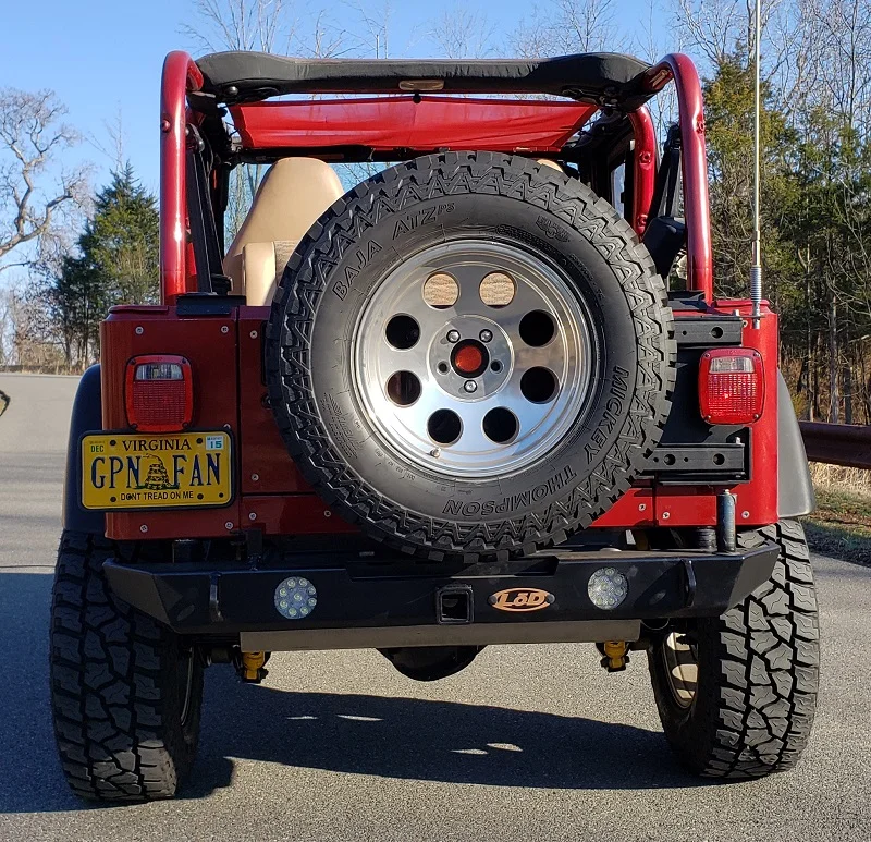

For brake lights, I used the lug nut hole brake lights on my spare tire carrier bumper. It would be even easier to install on a tailgate mounted spare carrier. They are decently bright, about equivalent to the stock CHMSL in brightness, with a bit less area.

I have since relocated my license plate to the spare, and use the ORO Platelite. The Platelite isn’t as bright, but also illuminates the plate.

I actually still have the lug nut lights behind the license plate bracket. I coated the backside with a reflective foil so that there is a red glow behind the plate when I brake.
