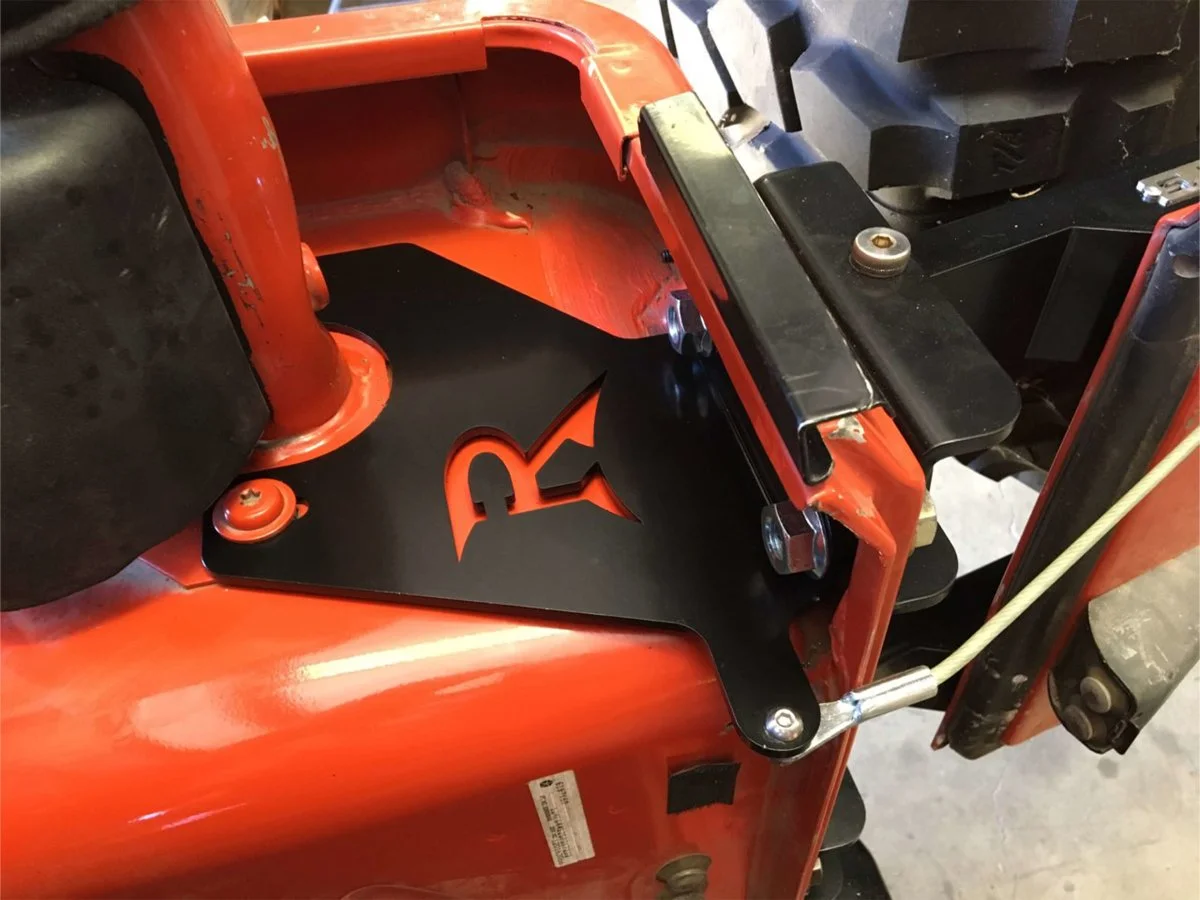

The two bolts going to the C pillar bracket are too short.
The stacked depth of the hinge and tire mount are too thick, requiring some tires to project further out from the tub than may be necessary.
The hinge bases above and below the tail light are not a large single unit like the ExoGate uses to distribute the load of the hinge attachment at the tub.
The cable swing stop won't survive.
The hinge bases above and below the tail light are not a large single unit like the ExoGate uses to reinforce the hinges.
Bolts do look short - Rusty's still up to their old tricks?
Stacked depth - You might be missing an inch max, probably less, compared to something like the MORryde. Some of this depends on the tire carrying bracket mounted to the middle of the tailgate. Having the tire actually rest against the arms keeps the tire from wiggling around when driving.
I agree a connected bracket might improve things functionally. One thing you can't see from the pictures is the bracket behind the body panel and lower hinge - extends inside the fender and connects at a third point which seems to really anchor it in place, although it's rough to install. Large single unit anchoring in the hinges or not, it's held on solid with no hint of movement.
You are absolutely right about the cable swing stop - it has lasted a couple years but is not going to last much longer. And it can spin back around on itself and catch occasionally.
As I said before, not a fan of Rusty's, but for people that don't like some of the other tire carriers, this one is worth a look.

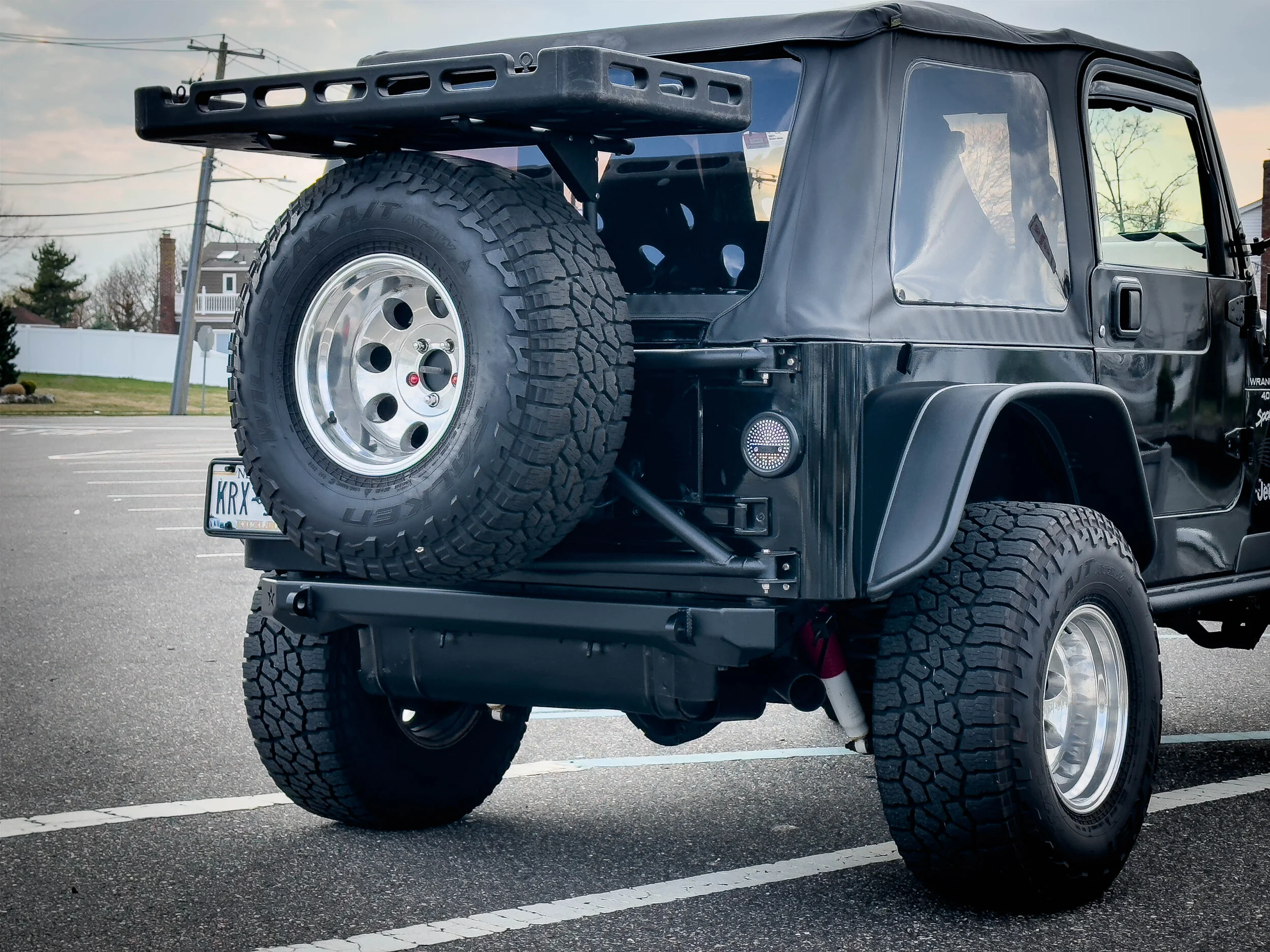

Yes, the Bestop Highrock 4X4 was discontinued, but if you're patient you might find one in the classifieds or on Market Place. I was looking for one back in 2022. Wanted it to replace the Rugged Ridge Spartacus HD Hinge & Carrier (more on that below) and posted here. Pretty much everyone here said to get the Exogate. I was looking for that carrier specifically because I wanted to use the Bestop Highrock 4X4 Cargo Basket and the baskets' mounting system didn't work with the RR Spartacus setup or the Exogate. Member @SvtLdr had a complete kit he had take off and we worked out a great deal. I have been running it since then and still love it. I keep it lubed and adjusted and it's been problem and rattle free even with a fairly loaded cargo basket and Rotopax water container and tools mounted on the spare. The basket and its mount can be removed/installed in just a few minutes.. which I do often... it's my daily.

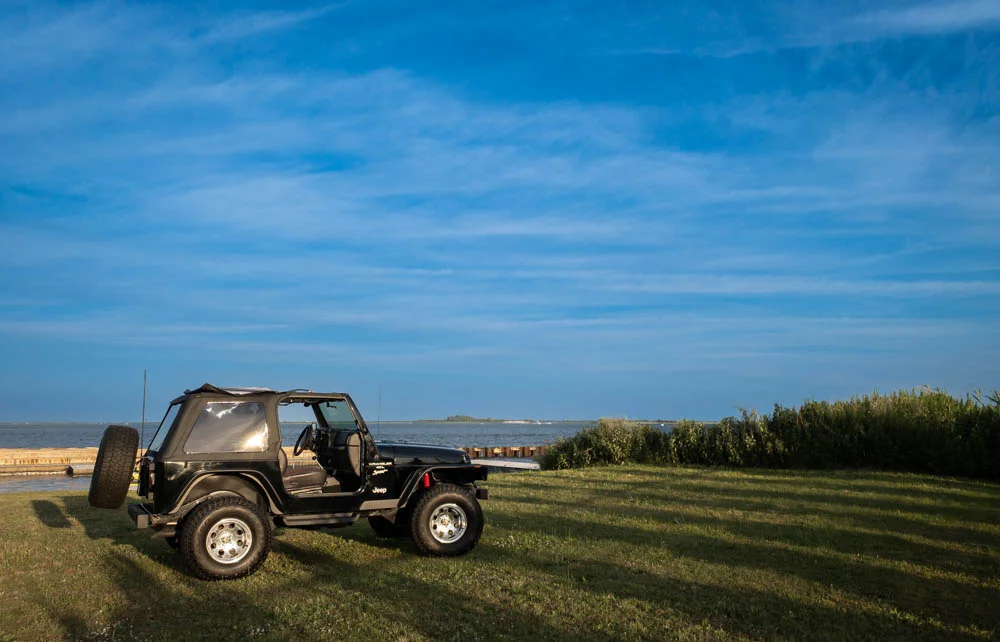

That said, the PO had the above wheels (33x12.5 on 15x10 ProComps) mounted on the a RR Spartacus HD carrier with the stock hinges. I really didn't like the angle of the carrier and how it cantilevered off the gate but I stuck with it and upgraded the hinges to the Spartacus HD Hinge Set. That hinge was rock solid and I can strongly recommend it, but look at the position of the spare!! Even from a distance it's ridiculous.
I was going to add the stock carrier to the Spartacus hinge set but decided I wanted the cargo basket and @SvtLdr pulled through for me.

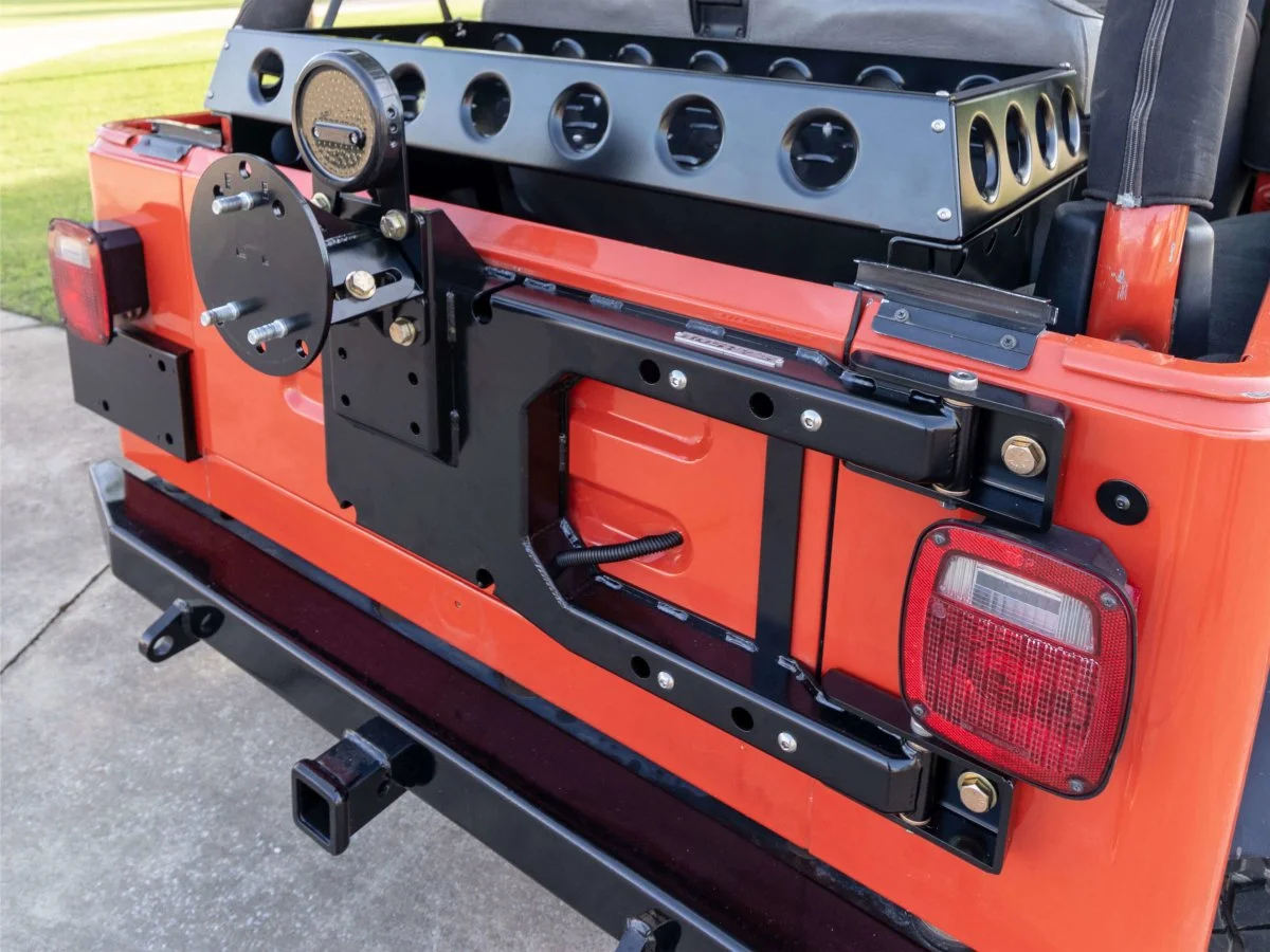

Rugged Ridge makes 2 different carriers; one angled like pictured and one with the tire vertical.
I have the vertical one and like it. It keeps the tire tucked in close to the tub.
Good to know. And now that you mention it, I do recall that. I think that's the two piece carrier. I didn't pursue that because as I mentioned I was set on using the cargo basket.
