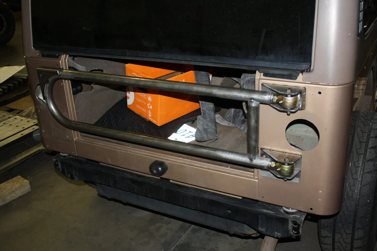

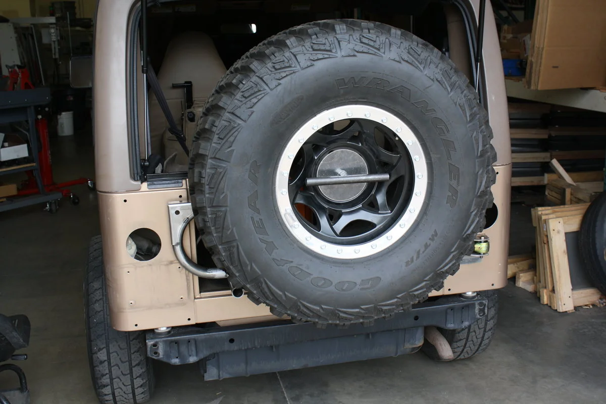

Not a fan of bumper mounted tire carriers. The better solution in my mind is a body mounted tire carrier such as the Exogate / MORryde, or the Bestop tire carrier.
Bumper mounted ones are a pain in the ass if you ask me.
Exogate/Moryde will save you a usually overlooked issue of having to open both the swing out and the tailgate. I have a swing out and it just became a pain. The exogate I have now is extremely beefy (holds my 35” tire right) and is easy to use.

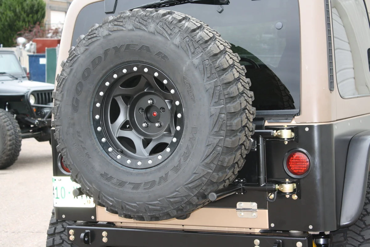

I agree with the others, I've never seen a bumper mounted spare tire carrier I would install. Having just one main support/pivot point is not my idea of a good design for something as heavy as a big Jeep-size spare tire and wheel can be. If it was me and I didn't already have the OR-Fab tub-mounted carrier I'd go with either the Exogate or Moryde.

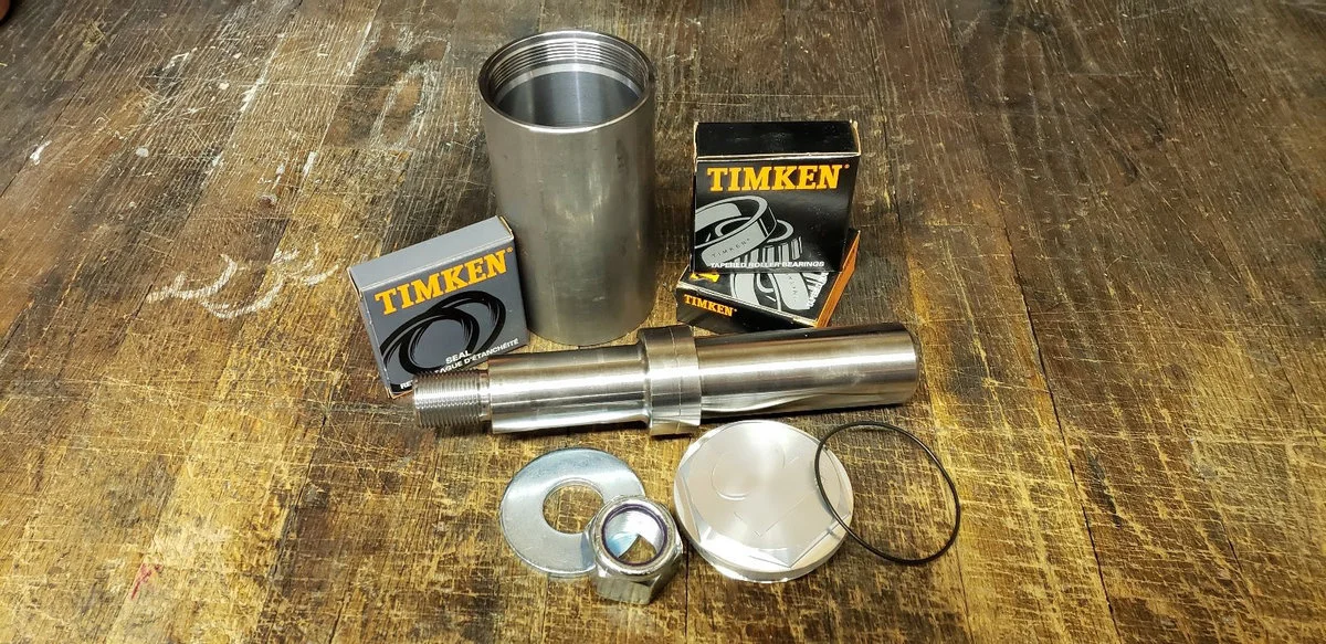

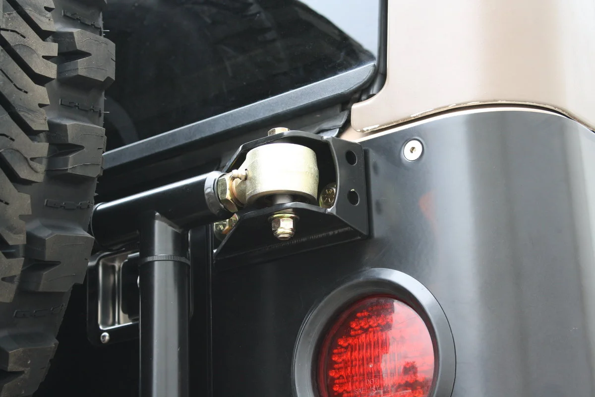

There’s this beast of a hinge which utilizes a 3” housing combined with a 1-3/8” inner billet shaft. Which is supported by genuine Timken roller bearings and races.

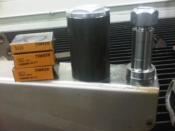

My old swing out used a trailer hub for the hinge. That was the best part of it. The main bumper and carrier frame was big enough that I never worried about the hinge itself being what failed. It was the tire mount itself that began to crack. The whole thing was heavy to begin with. Everything I did to address the shaking and cracking only added to the weight. I gave up on it and went the opposite direction, just short of abandoning the spare.
Reactions: Jerry Bransford
That's not the problem area so far as I'm concerned, it's where that post gets attached to the bumper. This photo illustrates the main issue I see... where the post attaches to the bumper itself.
