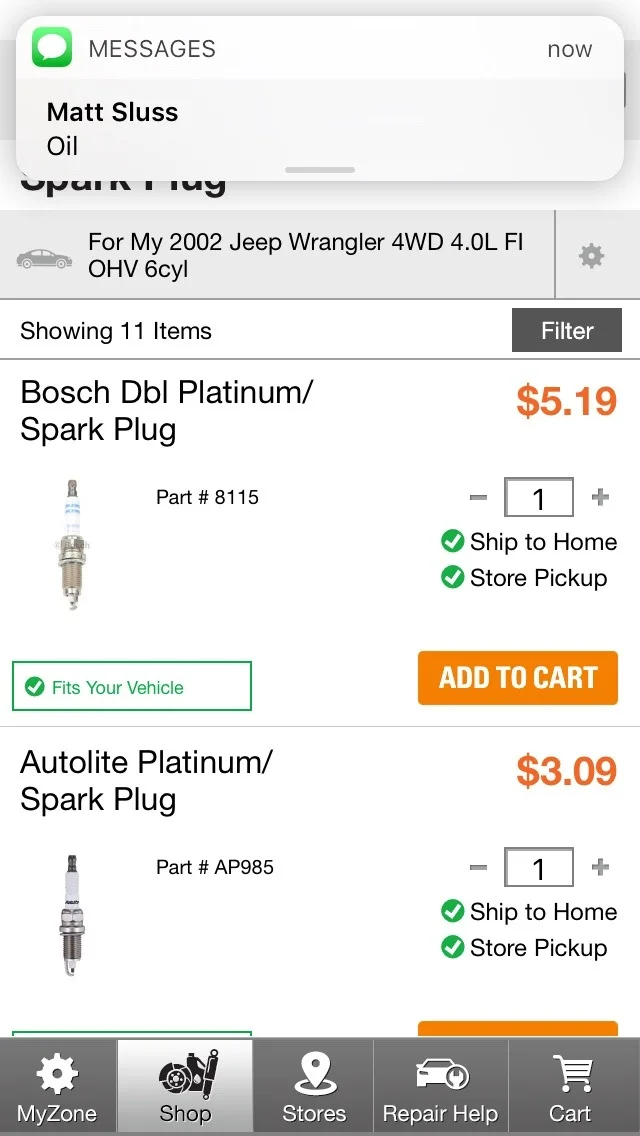

So I recently did my plugs in my 02 tj, put some autolite platinums in and on initial startup after replacing them the jeep sputtered a bit.. is that normal after changing plugs.. first time for everything lol

The AP985 was the wrong choice of plug for your 2002 4.0L engine. So is pretty much any Bosch, they just don't run well in our Jeep engines. A Bosch engineer said it was probably because they don't offer as wide of an assortment of heat ranges with their spark plugs as more mainstream spark plug manufacturers like Autolite, Champion, and NGK do.
The Autolite AP985 was the wrong choice because you have a distributorless 4.0L engine which has a "waste spark" ignition system. What you should have gone with was the Autolite APP985. The AP985 is a "single-tipped" platinum plug which means its platinum coating is only on one side of the gap. That causes misfires with a waste spark system. The APP985 is a dual-tipped which means it has the platinum coating on both sides of the gap which is what your waste-spark ignition requires when running a platinum plug.
And yes I understand some spark plug guides include the AP985 as a compatible plug for your model year. They're just not always correct.
Or you could go with the Autolite XP-985 which is iridium tipped and fine with your ignition system. The iridium gives the plug about 200k miles of good performance, the platinum coating will give about 100k miles of good performance.
So to avoid confusion, I'd go with either the Autolite APP985 or Autolite XP985. I'm running the XP985 myself but the APP985 would be a great choice too.

Sorry.. I should have lol.. so is it ok for now that I did that? Do I waste 20 more bucks and go get a different set?
The AP985 will eventually start causing misfires and bad idle issues. It's up to you whether you want to replace them with the right APP985 or XP985 plugs. To me, $20 is no big deal when it means my engine will run properly for a longer period of time. I would call the $$$ you spent for the AP985 a waste, I wouldn't call the $20 for the new APP985 or XP985 plugs a waste. :)
