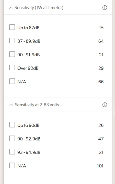

Does Crutchfield have technical assistance to help you match speakers to the head unit? Jerry I hear what you are saying about the sensitivity but I also read that you should try and get a reasonable match for the wattage output of your head unit. It's all very confusing to me and in the past I haven't been that successful at matching speakers and amps/head units. I've had cheaper factory setups that sounded OK but even swapping in "better" big name speakers resulted in poorer sound than factory. I'm looking to find a nice powerful head unit with matched speakers, no room for amps and sub woofers in my TJ.
Then there's the whole thing with the big names having two sets of quality, their high end stuff which is only one or two of their offerings then their China line which numbers into the hundreds.
If you truly understood the end effect of a speaker's sensitivity you'd realize that those charts aren't giving the entire story. Sensitivity is a speaker's SPL (sound pressure level) at 1 meter with 1 watt driving it, not whatever that final column of numbers is saying which makes no sense.
FYI... https://support.klipsch.com/hc/en-us/articles/360025619391-Speaker-Sensitivity#:~:text=Speaker sensitivity—many times erroneously,power input from an amplifier.

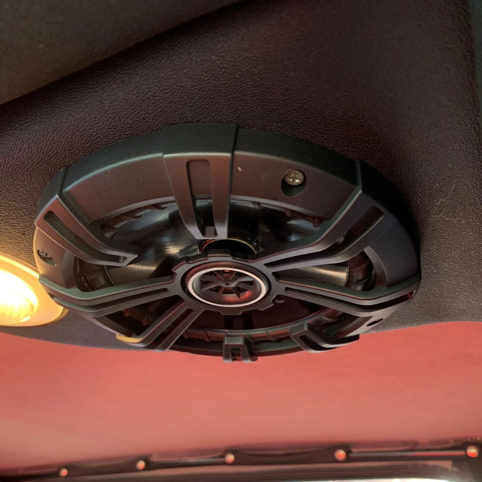

Yea, that chart makes zero sense. Listen to Jerry - he's completely right. I put the Kickers in the dash of mine, they're 92db as I recall. In the sound bar I put a set of very old, but nice Jensens that I had lying about. They're good speakers, but they don't have the sensitivity the kickers do - I had to bias the fader control rearward a couple of notches. I'm going to guess they're in the 88 db range, but the speakers are so old that Jensen didn't even know the specs on them when I asked.

Those rear speakers only have an 88 dB Sensitivity rating, Kicker makes them with a higher like 90 dB sensitivity rating that would sound better/louder with a stock radio without an aux amplifier. I'd shop on Crutchfield for things like that, Quadratec is not a good source for audio gear. Especially since their sales reps are typically clueless on the finer points of speaker selection, especially the Sensitivity rating which is very important unless you're running an external aux amplifier that puts out more power than a typical head unit does..
