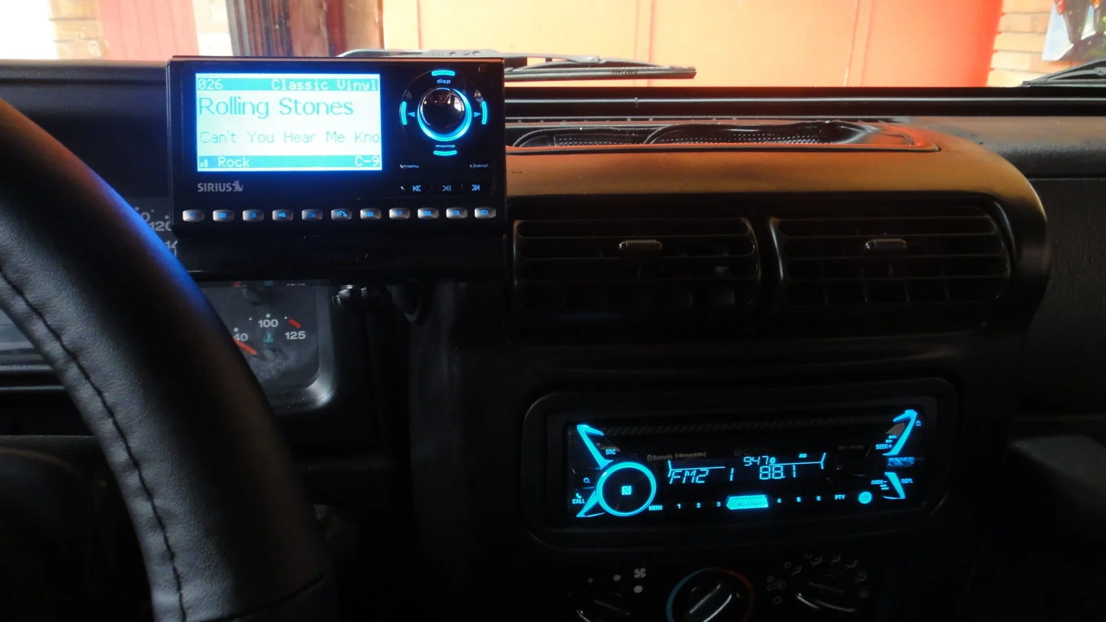

No issues at all but I haven't tried to use all the features yet. Little buttons might be an issue to those that change channels often but since there is no listenable music on Mexican radio I listen exclusively to my Sirius tuner. I change stations with the big knob on the tuner.
