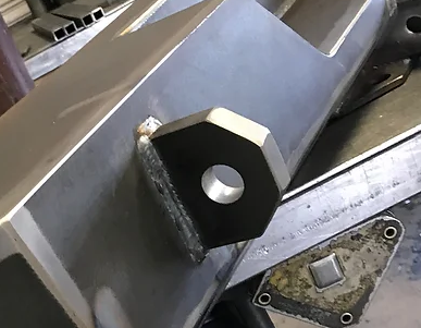

Well, not knowing what his or my d rings is attached to would inhibit this answer. A typical aftermarket bumper has a welded eye for the d ring. If one does not make sure that is smooth then the rope in there can be “unsafe”?

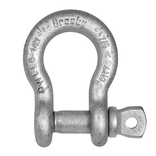

Without pictures, translation problems are prevalent in the recovery world because there are different terms for many of the components, many of which describe other components used in other worlds. For instance, in the lifting world, this is called an "anchor shackle" (more specifically, a "screw pin anchor shackle":

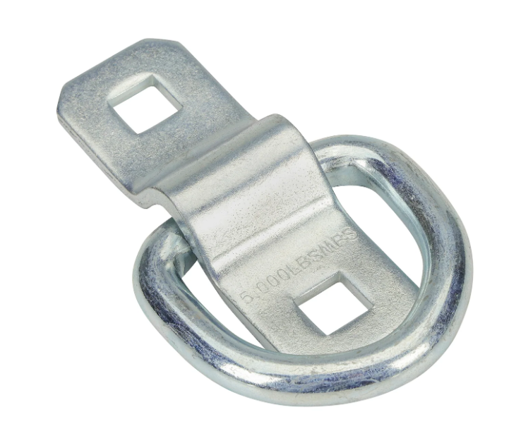

In the cargo transport world, this is called a "d-ring":

And now you've used d-ring in a new way (to me) - to describe this:
I'm so confused! :ROFLMAO:

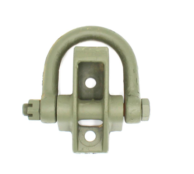

What do you call the removable recovery and lifting points at the 4 corners of a Humvee?
While I do recognize the accuracy of anchor shackle, I see them called bow shackles by a lot of the higher quality companies.
I just wish Warn would not have completely fucked up their shackle sizing to forever confuse the folks who own winches.
I don't know - I've never seen them. However, my neighbor is a retired Army lifer who was a fleet manager. I bet he could tell me what Uncle Sam called them...
As have I. In fact, Crosby bought Gunnebo a few years back, so now, you can see both terms used on the same web site (Crosby). Crosby calls them anchor shackles and Gunnebo calls them bow shackles. Come to think of it, "anchor shackles" could be a maritime term. Like I said - it's confusing...

Personally, I'd call that a d-ring. Every race transporter I've been in has the one I posted earlier in it (or a recessed version), and we called them d-rings. That looks very similar. I sent the pic to my neighbor. His response, "Those are shackles, stupid neighbor." :ROFLMAO: Again - I'm so confused!
