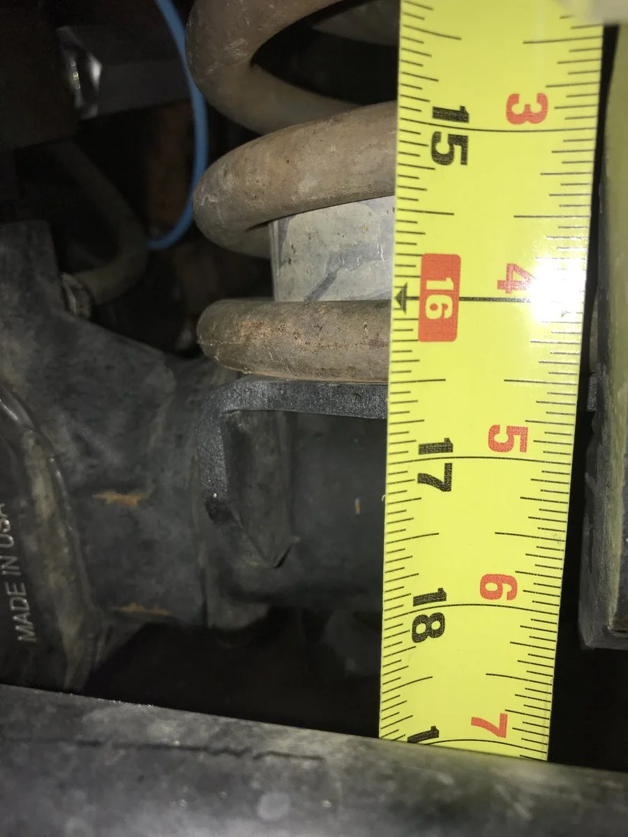

Hi, I'm the op. One of my springs broke and I'm looking to upgrade for better ride quality. With my current setup I only have a slight drive line vibration at 35 - 45 mph and no sye which I don't wanna do right now. My goal is to maintain same ride height and improve ride quality. 90% daily driver 10 % dunes. I believe the lift on it now is a 4" from rough country. I called and the numbers they gave me seem to match. 20 3/4 unsprung and 17 rh front and 16 1/8 unsprung 12 1/4 rh rear, which when I measure springs i get 17 f and 12 r. I read about the triple rate doing and it sounded like a good idea, when I called rk they said the 3.5" would be comparable to the 4" rc. I was planning on paying springs with fox 2.0 non resi shocks.
I’m a big fan of the Fox 2.0 IFP’s. Standard spring height measured from top of coil to bottom in front is 12” and 8” rear with no lift, if you’re getting 17” then you have 5 inches of lift. in general any lift over 3.5 inches usually always requires an SYE, adjustable upper control arms, and a Double Cardan Drive shaft. As far as the RK’s I have no experience with them, I have no complaints with my MC’s, and the Currie 4” are top shelf.
